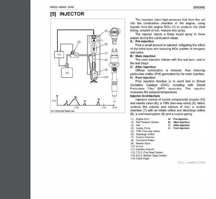

I'm suspicious of that compression reading too! Quite a coincidence for ALL 4 cylinders to be that low and close to the same. Faulty compression tester? Battery low when they were taking readings? So many mysteries here! It will be interesting what happens with this problem. I don't think crossing the wires would damage the engine itself ( might damage the ECU though!) but the terminals on the injectors are marked common and TWV so polarity is important. They run at over 100 volts so who knows where the electrons go if they are reversed?

How the injectors work
