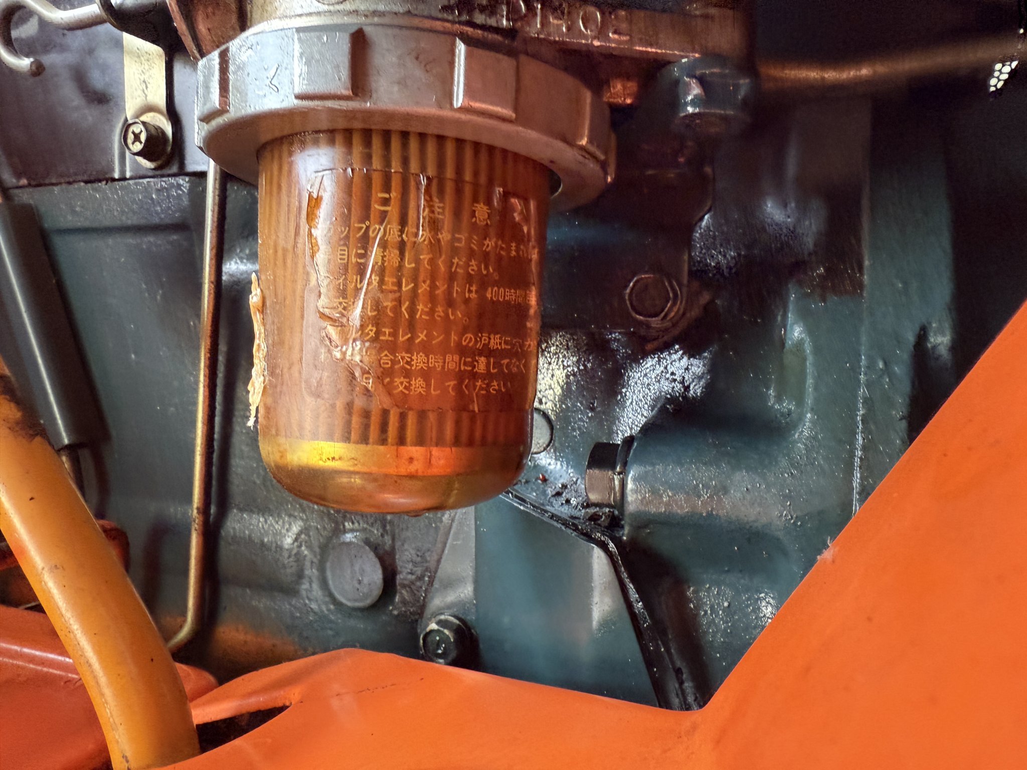

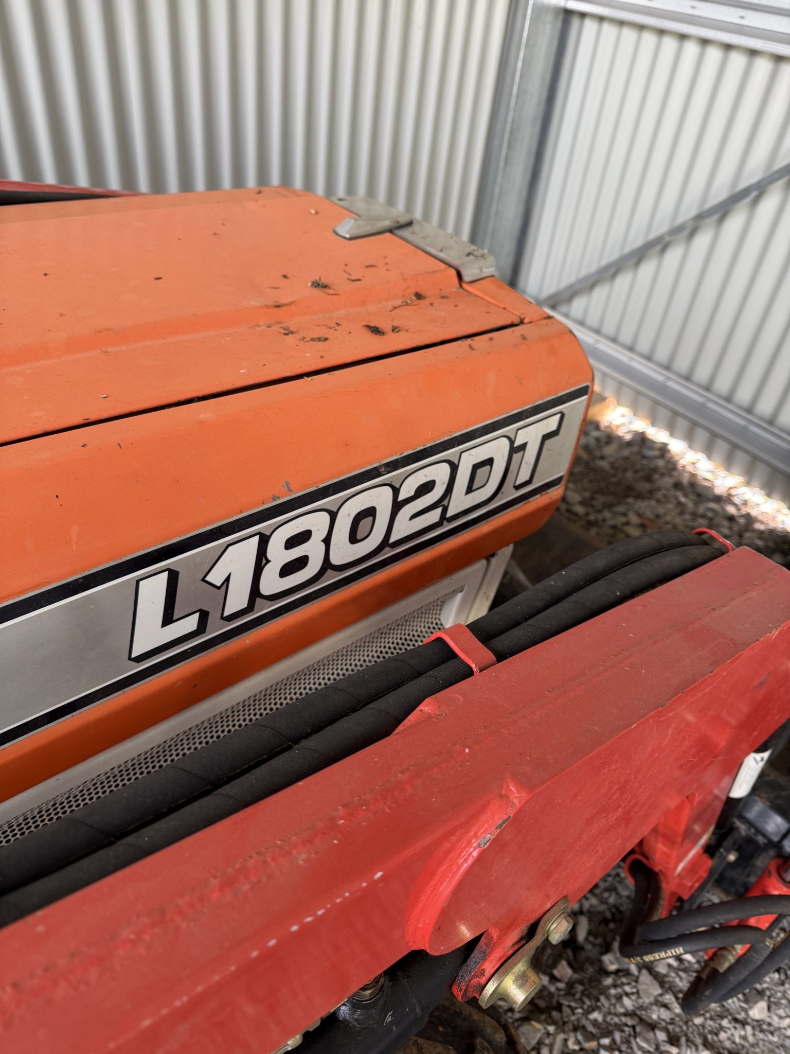

New to the group thanks for the add. Got a crack in the plastic fuel bowl on my grey Kubota. Know where I can get a new one and filter too? Live rurally with limited suppliers. And the PTO gear lever is stuck- its in gear but not sure which one as its not located in any of the 1-4 positions. Can't be put in neutral, always on unless clutch is pushed in. Thoughts without pulling the tractor apart?
