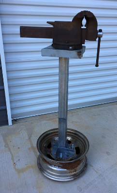

This may sound crazy - unless you are going to be beating the hell out of something IN THAT vise - find an old rim, 15" 17" or whatever, drill some holes in the plate below and mount on the rim.
Stable base - easily moved too.
Even if you have a time mounted on the rim - it will still work well.

Or, you could pull the 2 nuts from the 2 post lift closest to the vise base and add a plate on top of the post lift base bridging across to the vise base. Just another thought to keep from drilling more holes in the concrete.

Your concern is real and I would not want another stressed-hole that close,. Certainly not within 5’ or so.
The idea of mounting it on an old truck-wheel/rim is a good one. I used a discarded 18-wheeler or heavy-equiptment “split-ring” wheel-rim (also called “widowmakers”).
Old tractor wheels are also good candidates.
They are usually Very Heavy…. and cheap throw-aways…and can be found in 20” and much larger sizes that will give you the stability you desire….while still allowing you to move it to anyplace more convenient for certain tasks (instead of being stuck with the location you might drill-and-anchor it.)
Just a thought.
Yep I did that for my bench grinder. It doesn’t move at all.

I have my big vise mounted atop a heavy brake drum from a semi truck/trailer. It's heavy and stout. It takes a little effort to tilt and roll for moving it, but stays put in any location. Watch your toes when you tilt it back up in place!!
I have a few from a former owner/operator that used to rent space from me. But I'd guess you could easily pick some up from a truck repair shop for next to nothing or a six pack of their favorite beverage!

Thanks everyone for the replies and advise. Based on the feedback, I'm going to give the tractor rim method a try. I made a cardboard template of the base this morning. I'll take it to the local tractor yard where they have hundreds of rims to see which one fit's the best. I have three spare 50LB suitcase weights I figure I can throw in the rim if I need additional base support. The base of the vice is cast and definitely the weakest part. I plan on using it good, but not to the point of bustin something. Keeping it mobile is a big plus as like to move it near the garage door when grinding.
I'll snap off some pics after I'm finished. Again, thanks for the input and advise!
