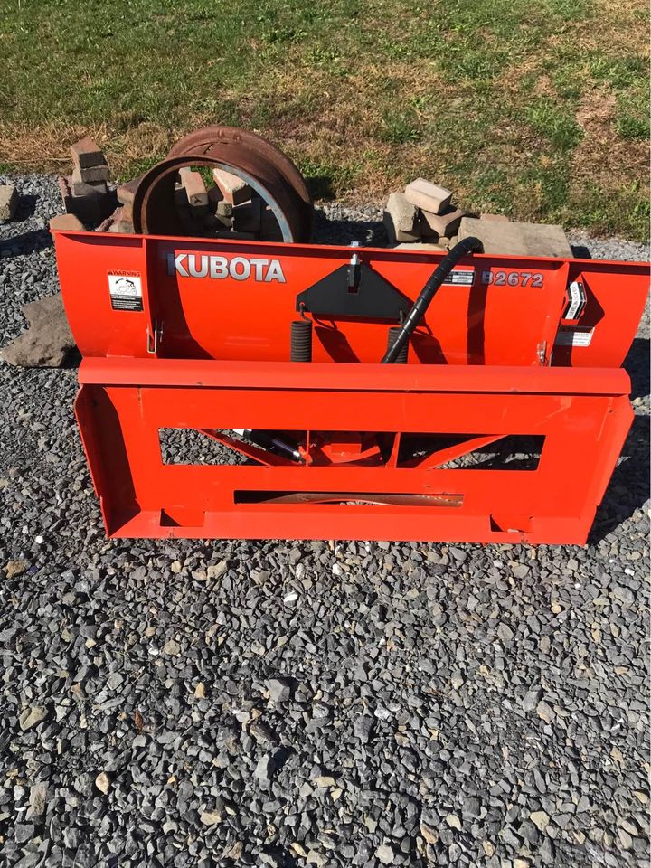

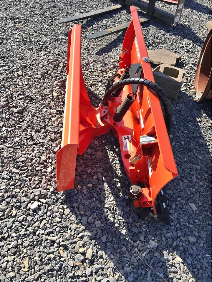

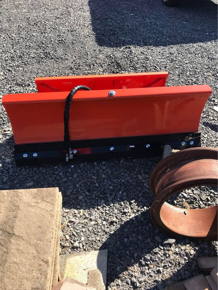

I have it put away but will get it out in the next week or two and post some pictures. It is the snowplow that mounts on the tractor's loader arm when you remove the bucket.

Just sent you a private message (conversation) about the correct snowblower located in Maine. Below are pictures of a plow just like the one that I have for sale.

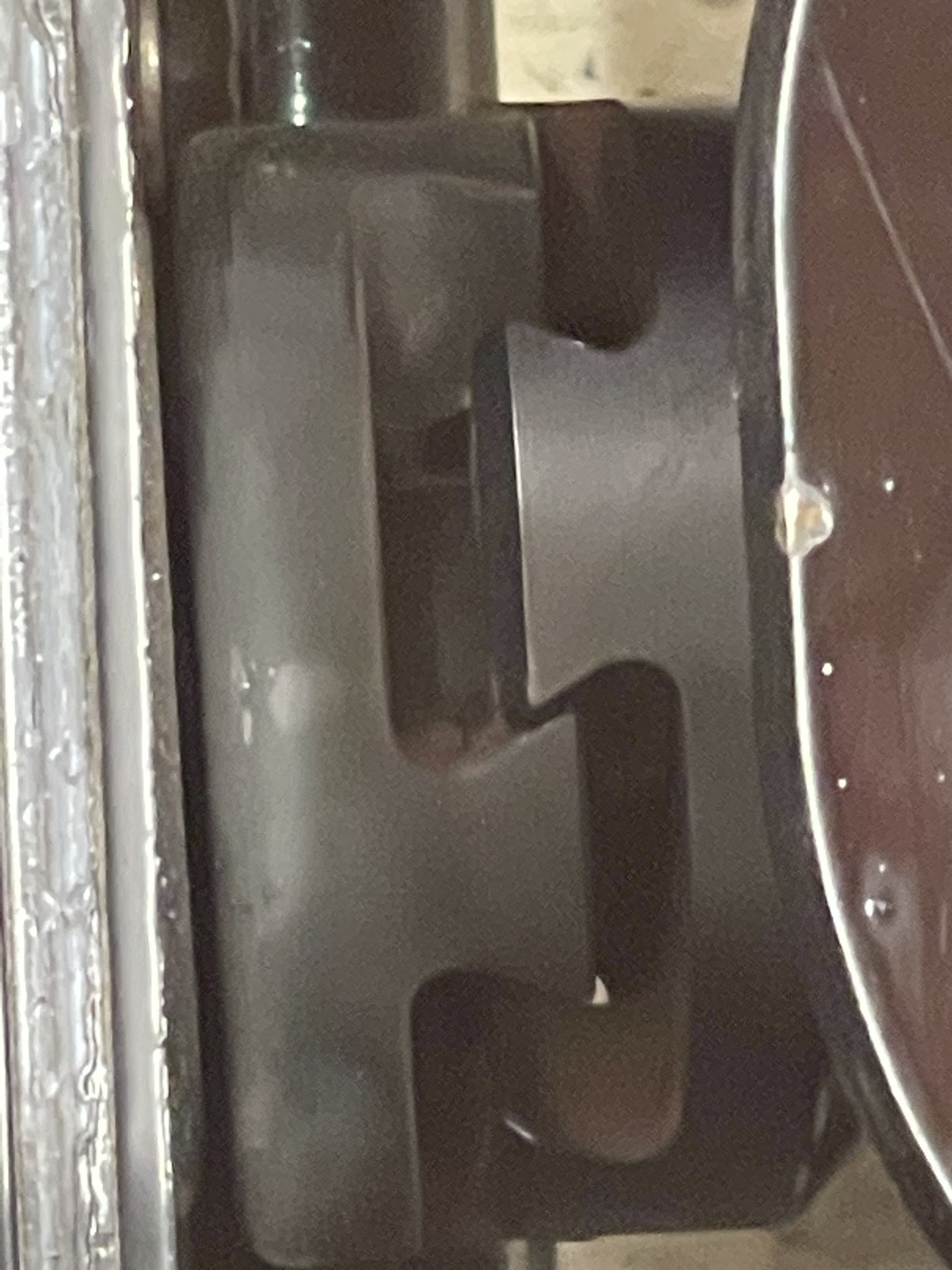

hello. I have this same system. Do you have a pic of the k connect and blower shaft faces engaged? I did maintenance on mine yesterday, adjusted the chain and now my k connect doesn’t enrage all the way. My shaft faces engage, but there is a 3/8” gap between the inner faces. Wondering if this is normal.
Check the coupler on the snowblower. Most likely, the shear pin, a 2 1/4" grade 5 bolt has broken and the coupling has moved forward. I am now on number 3 of this shear pin. It is a common problem with the new K Connect system I believe, but have yet to prove it. As time goes on with these (BX2816 & BX2322) snowblowers, we will see how many owners are experiencing this issue. I presently know of one other. I can get quite expensive if you damage either one or both of those drive connectors.

I hear what you’re saying, but here is a pic of the coupling off and on the blower connected to the K connect. It seems that this is normal? Also,the bolt was broken/missing BUT there is a square key way on the blower shaft to prevent the coupling from breaking that bolt, so not sure how that happens 🤷🏻‍♂️

From a 'mechanical' viewpoint, as I don't have the K system, in picture #3 , there's not a lot of 'overlap' between the two 'couplings' and there's a lot of distance (gap) between them radially ( round the clock ? ) compared to a 'Lovejoy' type of coupling
maybe this is normal for the system but it seems way to 'sloppy'.
I'm sure someone with it can explain it better. perhaps it's ok ?
