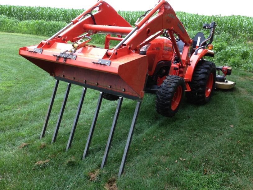

I understand your concern with the attachment method. Like Jay, I tend to make things in lieu of buying. While I don't have experience with those products I have used a similar method to attach my brush forks and homebrew rake on the L3200. Both have been just fine.
My method uses a clip on the forks that goes over the bucket edge and is pulled toward the bucket edge by a chain loop tightened with a large ratchet binder. I chose to wrap it around the back because the straps in front look like they would catch the material being scooped / handled.
Rake attachment is similar but with two individual chains with bolt ends that pass through holes drilled in the bucket.

That is some nice work chim! I like the chain slots on the top! The bolts we see in the photos are holding on a replaceable blade edge or are they part of the assembly? The chains pulling on the bottom dont have a tendency to force the attached item to tilt down?

Thanks. What appear to be bolts are really nuts. They hold the replaceable edge on the bucket. I drilled the factory edge and plug welded short pieces of stainless threaded rod into the replaceable edge so the bottom is flat and clean.
The chains pull the attachments back into the edge of the bucket and that's what keeps them on solid. The rake has angles that wrap back into the bucket and can be seen easily.

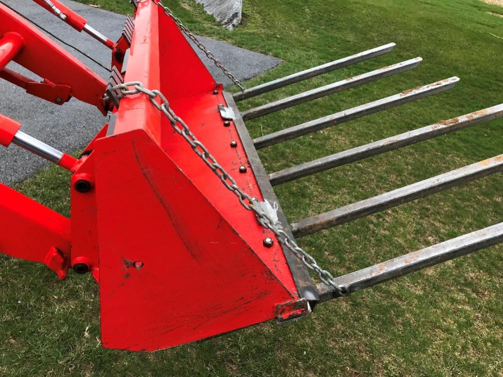

The fork mounting is harder to see. There's an angle iron that has one leg that rides on top of the bucket edge. The other leg swallows the fork tines (which run about a foot back under the bucket). Here's a more recent picture of the forks.
The chains that run in front of the bucket and the two flat bar extensions were added after the original fab. Their sole purpose is to make the forks almost self-installing. When the forks are attached they don't support or hold anything. With the forks on the ground I can drive up to them with the bucket dumped, drop the two front chains into slots and curl the bucket. That mounts the forks and all I need to do is put the ratchet strap on the back of the bucket.
