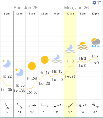

We were brutally cold out here. -38F this morning.
