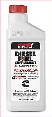

Hopefully the weather will pass down it Texas - place some power service white bottle in there and diesel on!

I put white PS additive in fuel all year. More for the lube for the HPFP in the VW. It’s at the local auto parts store, (other brands may not be). Cheap insurance and in the fall if winter blend is not swapped in quick enough (and how would we know) the fuel will be fine. It’s not unusual to get below 0f here in October.....

I've been adding Power service white during the cold months and silver in the summer and never had any issue in about thirty years in my equipment. Change the oil and clean or change the fuel filter (s) in the fall.
Near the 45th parallel, temp range is about 10* below F to about 90* F.
