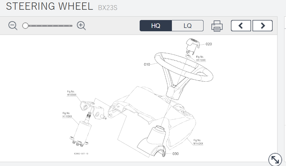

I’m curious if there is a way to add a clock spring onto the tractor steering. I’ve tried using a heated steering wheel cover but the wire connection keeps breaking. I’ve concluded in my mind this is not possible since the tractor steering is hydraulic and doesn’t have a constant turn to lock like automobiles. im not that knowledgeable on clock spring applications so I thought I would ask the group to get more info.

When a clock spring is used there's a cutout in the steering wheel to hold the spring; the BX wheel does not have such a space. I use 12V heated glove liners and have wired an SAE plug to the rear bullet connections so can plug my heated suit controller into the tractor, glove liners included.

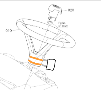

Any spring, whatever its size, will not work.
What you need are slip rings. Maybe you can use them from an old car steering wheel from the horn contact. Have both wires going via slip rings, do not have the ground return via the steering column and ball bearings, they will sustain damage long term.

Nothing will work as there in no steering column, the steering wheel attaches directly to the Orbital valve (steering controller).
I would not see that as so pessimistic. Two copper rings attached over the hub of the wheel and a brush holder from an alternator would do the trick with very little effort.

So I would always go for two simple slip rings to power my steering wheel heating instead of having a complex, high frequency, high power electromagnetic field around me. And yes, shielding is possible but not trivial. Anybody that had to get an electronic device certified against electromagnetic emissions will confirm this.
