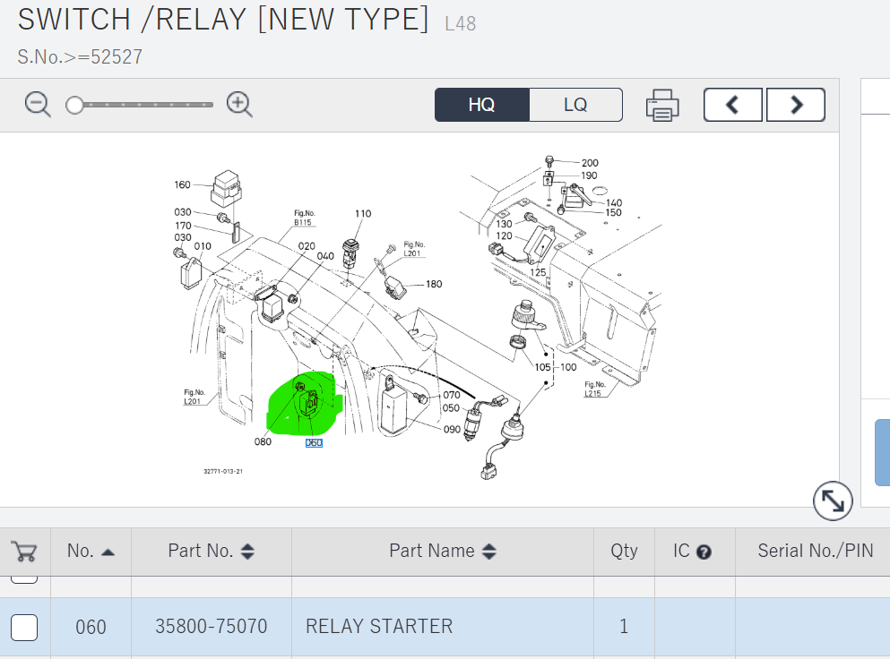

This is an odd model that you can not just jump the starter and get it to start because the start relay needs to engage to send power to not only the starter solenoid but also the run solenoid pull in coil on the engine.
I would start with checking that start relay.
It could be an issue with the relay or inputs top the relay.
The start relay It gets its ground inputs from the PTO/ Range/ HST safety switches.
At the bottom is a PDF of the start sircuit so you can zoom in and read the colors.
