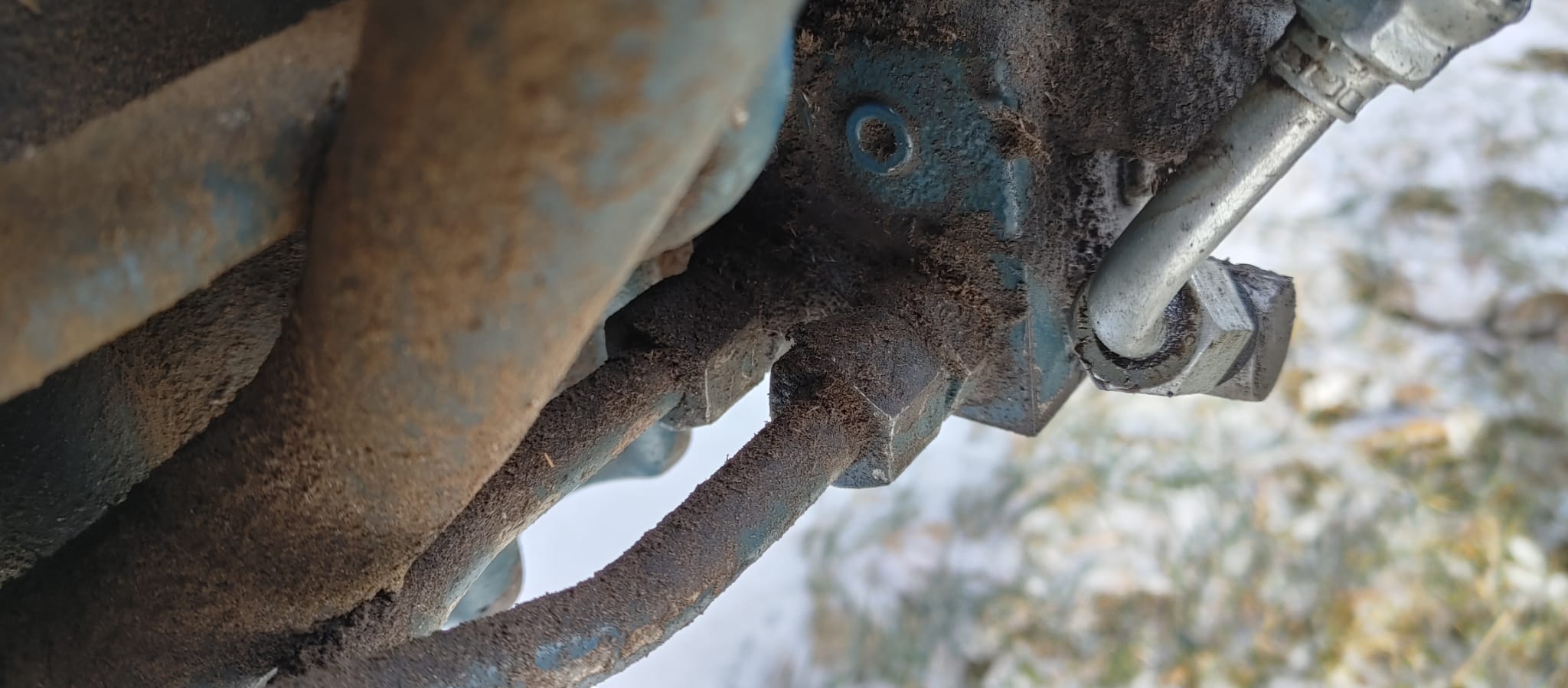

I have a L2850 with a LA650 loader. I want to check the hydraulic pressure is in-spec. My loader only has quick connects on 2 lines, I assume the source and return lines (not on every raise/lower/curl line like a modern loader).
Should I just pop one of the function lines and take the fitting to the Parker store and match the fitting to a hydraulic gauge and deadhead the function at full RPM to see the working pressure?

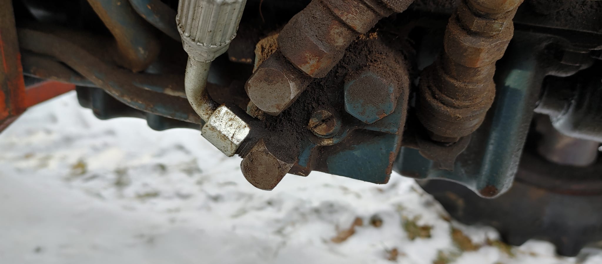

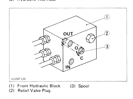

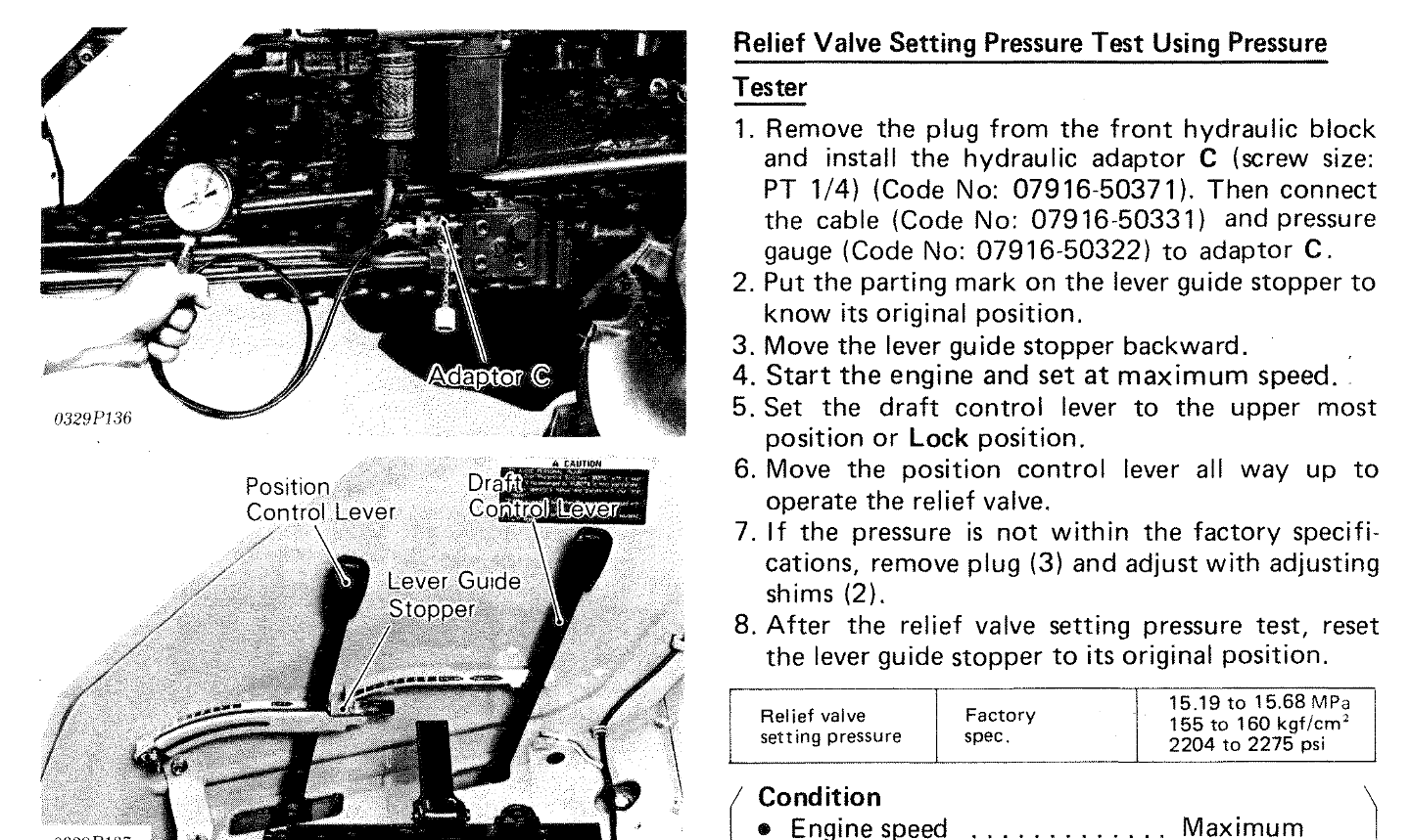

You check pressure via the hydraulic block, the instructions are in the WSM.
30,552
6,599
Oh, I see. The loader doesn't have it's own relief valve? I can just check it via the procedure in the WSM?
If you can't find it just ask I have a L3450 which has the same hydraulic block.

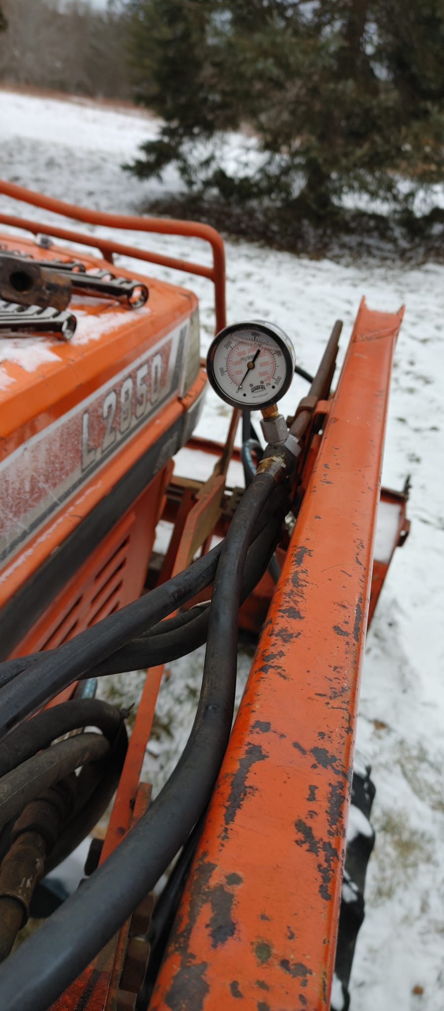

One of the easiest was to test pressure is to remove one line going to a cylinder and put a tee on that with a gauge.
