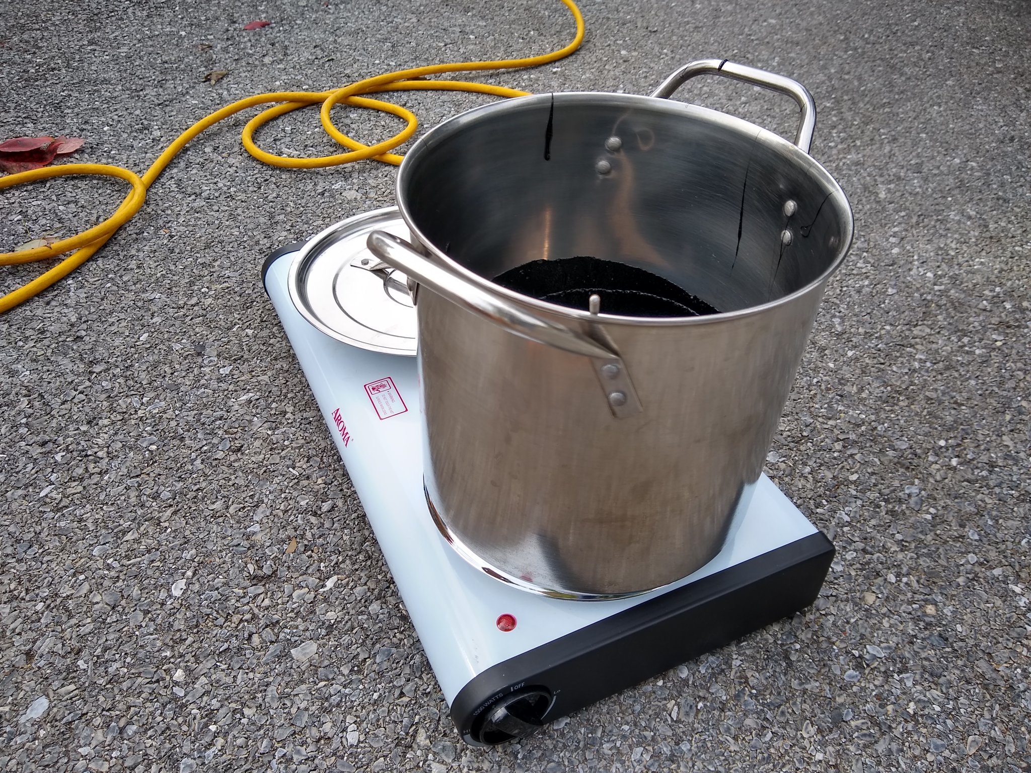

Equipment was simple. Found a brand new 2-burner electric countertop "stove" on FM for $20 and visited a local re-uzit shop for a $5 pot and 50 cent dipper. I melted the plastic wrap right along with the sealer as others have done. Cut pieces tend to attach themselves very securely to whatever they are placed on. It would have been handy to have some plastic wrap to temporarily park pieces on.

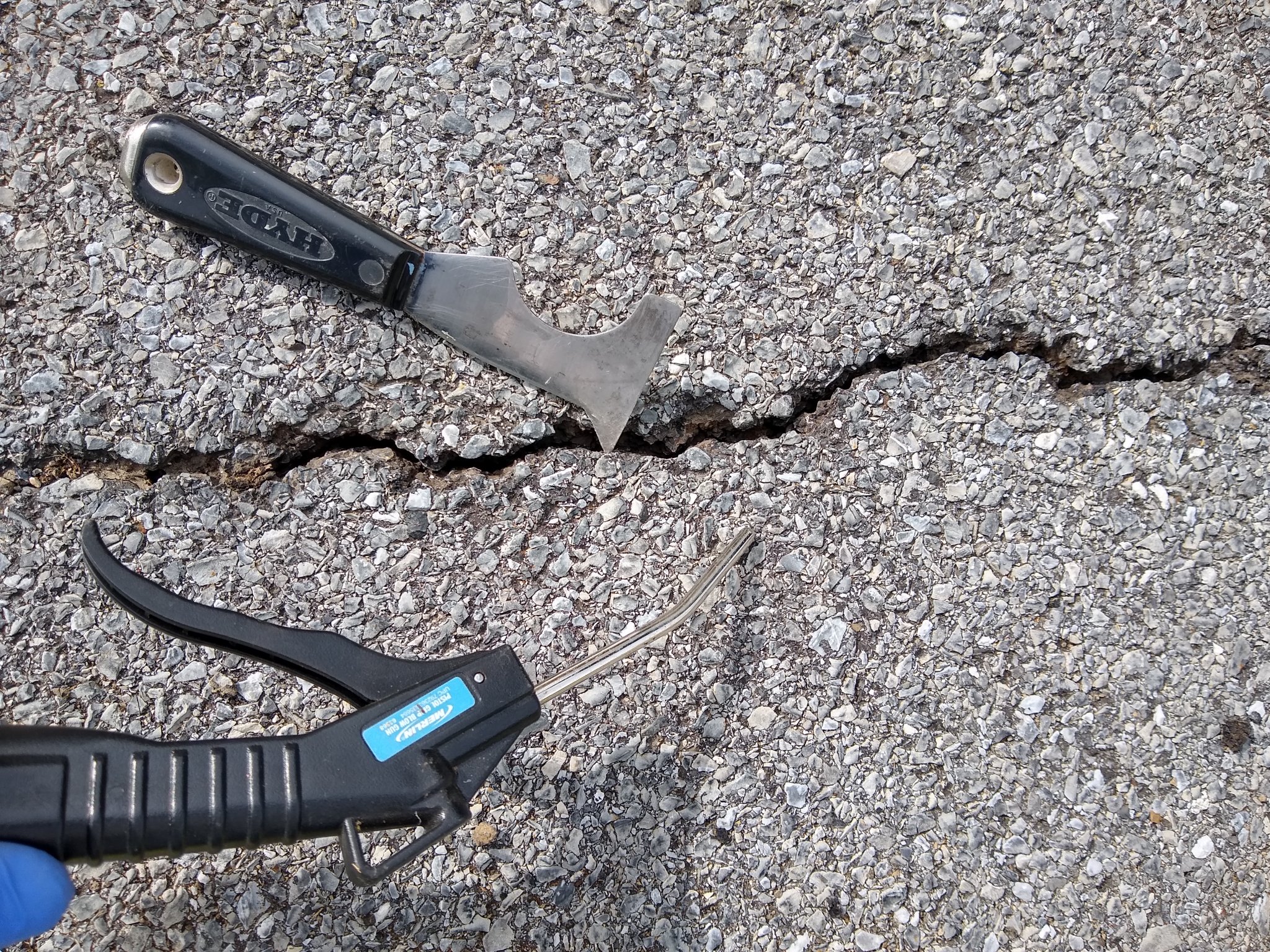

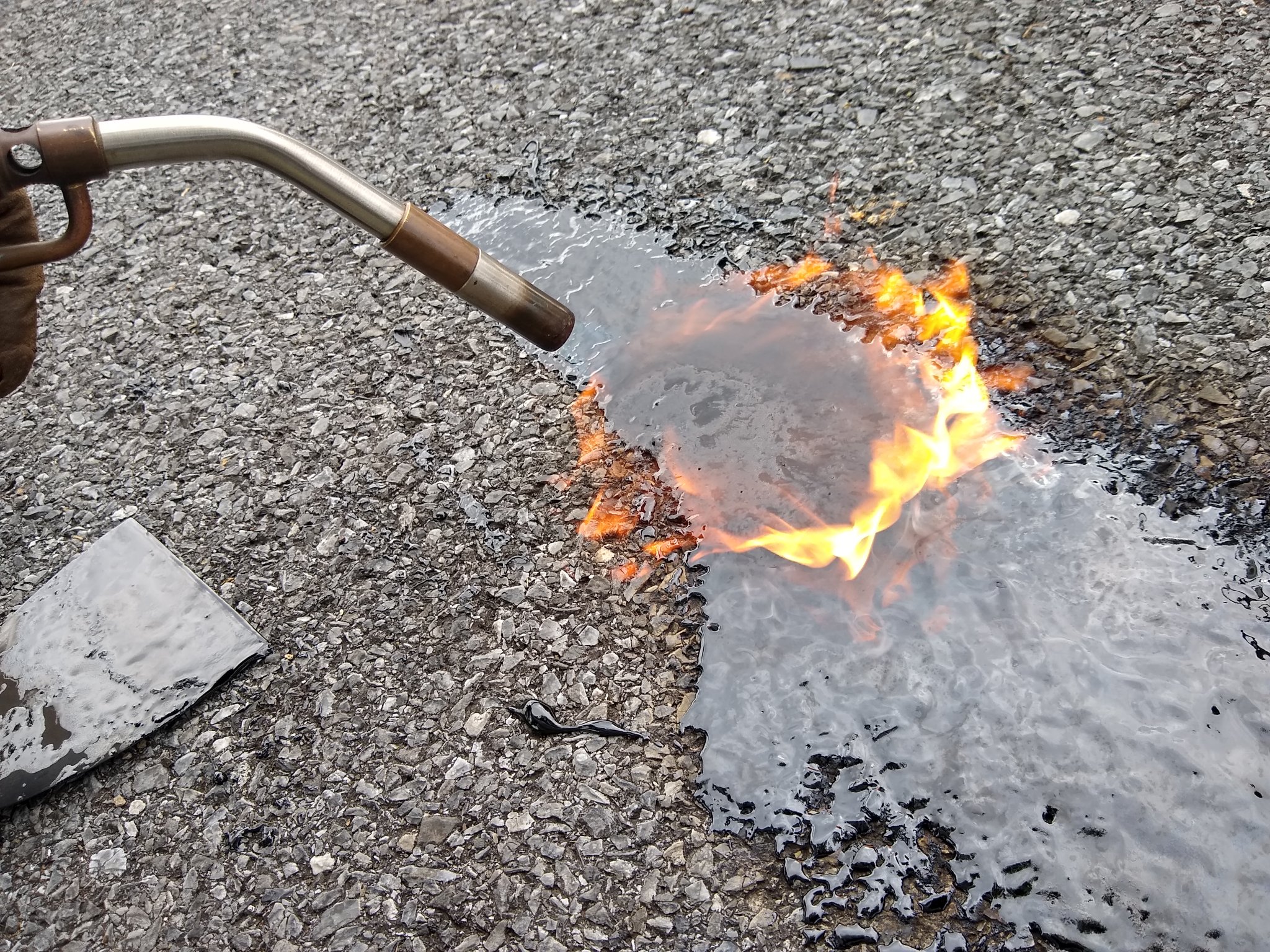

Melting on the 120V burner was surprisingly quick. The pot sure got slopped up but the mini range only ended up with two little black dots. First step was dragging the air compressor out to blow the cracks clean while scraping them out. The they were pre-heated a bit withe a MAPP gas torch. Some of the larger cracks had to be topped off. due to the sealer flowing deep. Then to smooth them out I hit them with the torch. Most cracks were simple pour 'em and go. The trickiest one was a wide one on a hill. Took a little finesse. The sealer wanted to flow over the downhill side of the crack and not flush off with the uphill side. I tossed some sand on the patches near the house.

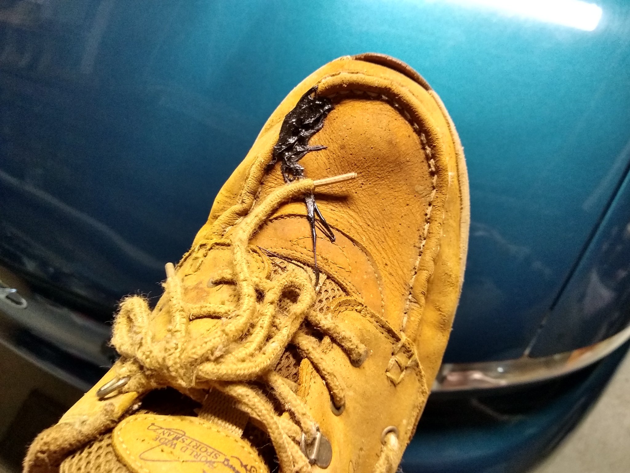

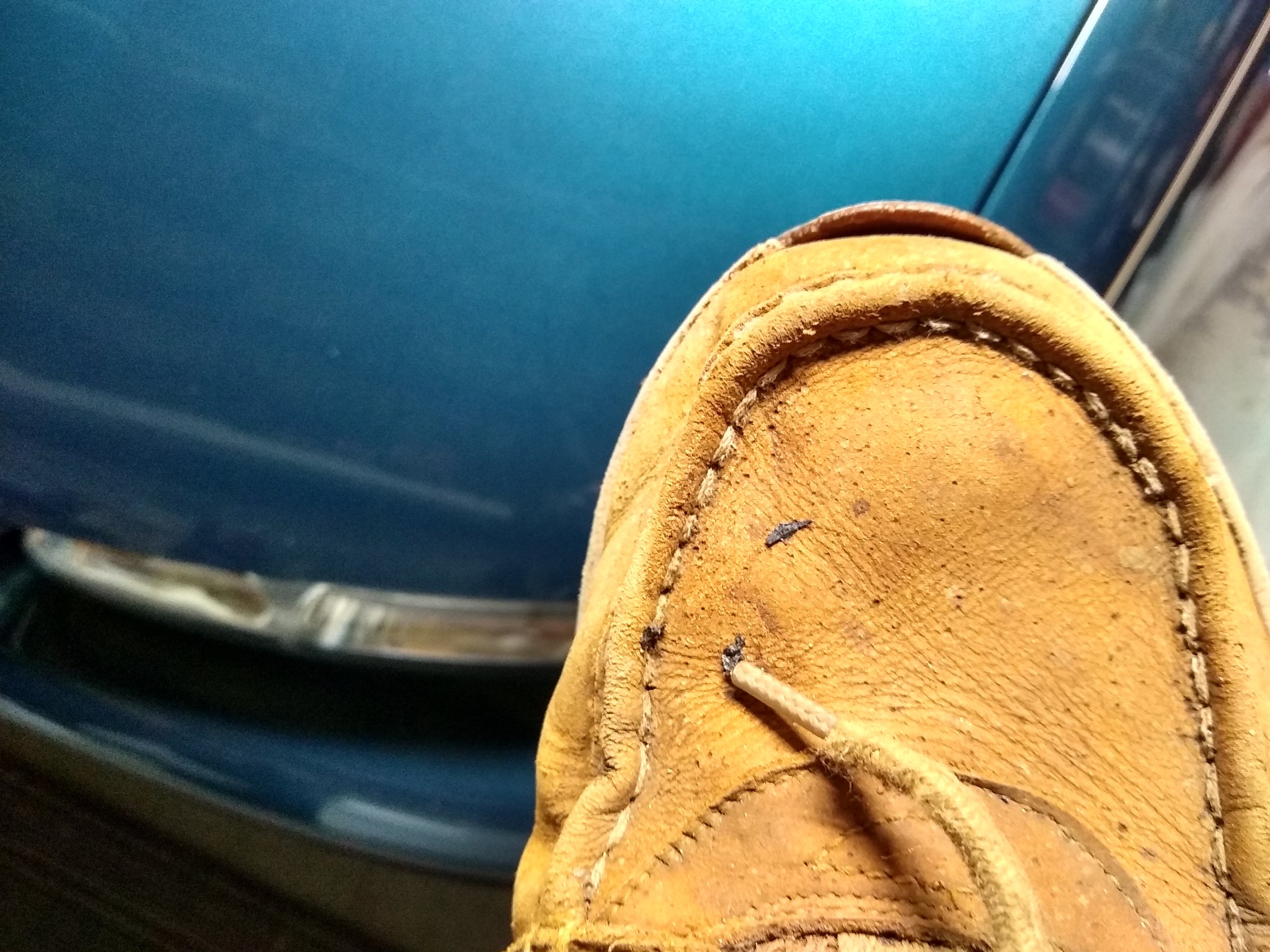

BTW, you told us how much tar found it's way onto equipment, how much was on you at end of day.
I'm happy and surprised to report almost none. Not wearing nice clothes prevented it much like buying a new snow blower prevents snow. "Disposable" clothes were chosen and not a drop got on them. There was one blob that was easily picked off my shoe. I did use an old pair of nearly worn out leather-palmed gloves that don't look much worse now.
As mentioned, the material is different from standard tar. It fuses to the blacktop so well that even without heating I'd bet a piece left sitting on bare blacktop would become part of it in a few hours. Yet it didn't stick to my gloves while handling it to cut it into chunks.
Altogether there were 4 or 5 small cracks plus two larger ones in which I believe tree roots played a part. In addition to a tree root, the largest crack (shown in the first post) was also near the top of the hill. I can envision the seasonal heating and cooling along with gravity helping a section of driveway "walk" downhill a bit with the separation happening at the weak spot (tree root) near the top.
