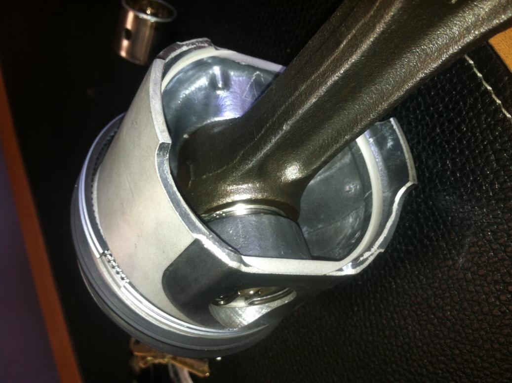

Early yesterday I took my piston assemblies to the machine shop that was touted 'to heat pistons' to insert pins.
They seemed to not have heard about heating pistons. Also said their good machinist was retired & came in only when needed.
So I then went to the machine shop used by the other Kubota dealer. This dealer & the machine shop said the pistons were 'press fit' & did not need heating.
My assessment yesterday morning,
- long time in business
- build & ship engines all over the U.S.
- have many, many, repeat customers
- have always done 'good' work for me in the past
- used by local Kubota dealer
- really, really, a nice owner to talk with
Because of this I asked him to:
- pull the pins, check for anything that should be replaced with new,
& put in new bushings (properly fit)

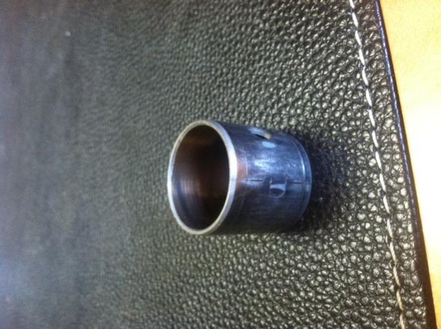

A couple of hours later I picked up the assemblies & didn't think about looking at the work at that time. Later that evening I was looking at one assembly & noticed that the rod bushing was exposed on one side but not the other. Looked at the other two & they were the same way. Edges of new bushings show edge damage.
My concern is the bushings are not centered & would not center the load properly & 'might' have reduced the oil hole opening by the offset amount (can't tell because it is at the top of the rod).
The new piston appears to have two cracks in the bosses, one on each side. They catch my fingernail if I scratch them. Might not be cracked but visually appear so. If they are cracks then this is probably because it wasn't heated. The picture does show the cracks but not at first glance.
Also looked at the old bushings. Looks like one was removed with the aid of a chisel. That's ok as long as the rod wasn't damaged.
Talked this morning with Country Sales & Service - Ohio". They are a Kubota dealer & also rebuild engines. The service manager told me they would look at the three assemblies, check for damage, round the rods, replace anything that 'needed' it, center the bushings, & they routinely heat the pistons if it is called for.
Will be packing them later today.
Pictures are included.

It looks and sounds like the pistons are now damaged and if the are cracked then they are worthless. Pressing a bushing or rod into a hole that is too small will ruin it every time. I would make the shop that improperly assembled and ruined them replace them. They should have checked tolerance before just pressing them in. I really worry about the competency of the shop that would use a punch or chisel to remove a bushing!
I personally would get new pistons, bushings, and maybe even rods (if they were damaged too, and have a qualified shop put them together for you.

Well... Being one of probably very few folks here that has actually ever installed and re-sized rod bushings or had to do a "touch-up" hone on a piston pin bore here's what I think.
If the bushings are off center, they were just being sloppy and often that carries over to the rest of the job. That being said, the bushings are always press fit into a smaller hole in the rod than what the OD of the bushing is (some really old antique stuff does use a cinch bolt). The interference fit is what holds the bushing in place. After the bushings are pressed in they usually must be honed with a rod hone machine to bring them to the correct size as the pressing in of the bushing usually distorts it some and the ID of all the rods won't be exactly the same due to manufacturing tolerances. The most common problem that occurs here is that an inexperienced or careless operator can hone the hole at a slight angle which causes the piston to be cocked sideways in the cyl. bore (you check the squareness of the pin and journal bore against each other when you're doing the honing. You can also check for axial twist, but this is less a problem than having the bores out of square to one another.
Regarding the pistons & possible cracks - The pistons in the photo are not "press fit" pistons. They are a full floating design. You can not "press fit" a pin into a piston that does not have even/square outer bosses. Further, you don't need retaining clips to keep a pin in something that is press fit. Your "cracks" may very well be scratches, which again is often a sign of carelessness and can also cause stress risers that could (not likely in this application, but could) lead to a pin boss crack later. I also think that the piston would be seriously deformed somewhere if enough pressure was applied to crack the pin boss.
The heating issue has nothing to do with a "press fit" in this application since the specs list a "clearance" tolerance. Rather it has to do with ease of installation. Where a fairly tight clearance spec is quoted it can often be difficult to slide the pins in the pistons. The extra heat increases the clearance just enough that the pins install more easily.
Too bad you had the bad luck of using a shop that may not have been real careful with your stuff. You had no way of knowing aside from possible references and previous experience. Most people would've put it back together without noticing things weren't quite right, and probably, everything would have been ok. BUT....
I'd be talking to the shop owner about setting things straight no matter where you take them next.
