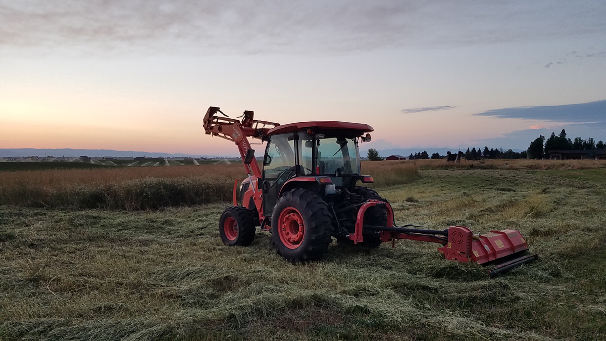

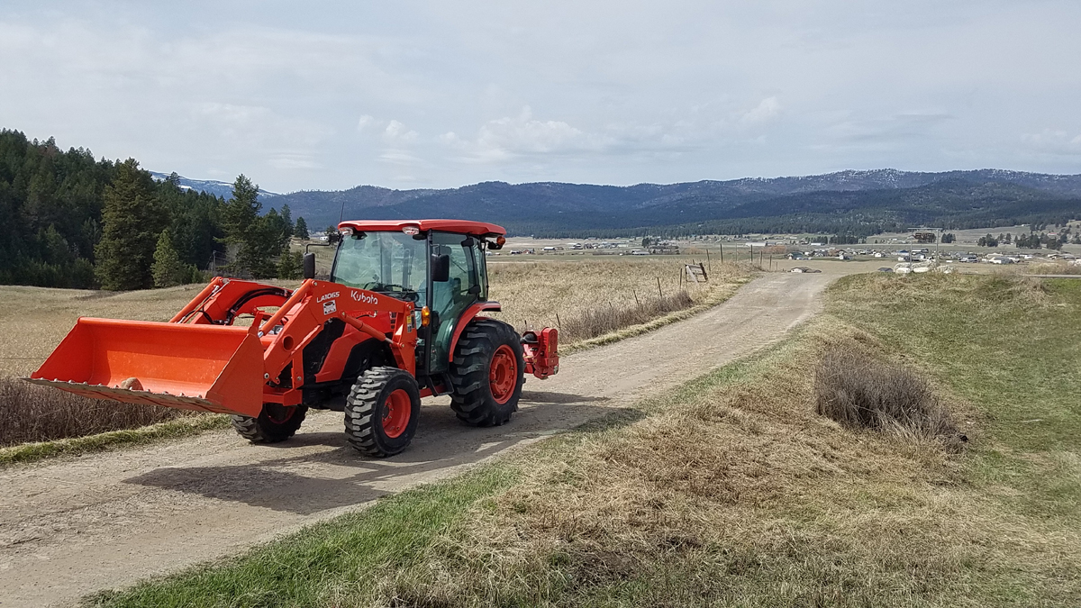

There are ditch bank models suitable for smaller tractors, but as I mentioned above, the cutting head width is reduced due to the offset weight. On those occasions when the cutting head is tucked in behind the tractor you might find yourself wishing that you had a wider flail. But this is the trade off. When the cutting head is all the way extended it will certainly change the balance of the tractor. Increasing rear tread width or adding weight to the tractor in the form of liquid ballast and/or wheel weights will help.
I don't know what you're dealing with in the wooded areas or what your objectives are, but an hydraulic offset flail offers more options than a typical rotary cutter. I'd sell the RCR1884 before the Del Morino flail simply due to the versatility of the flail.

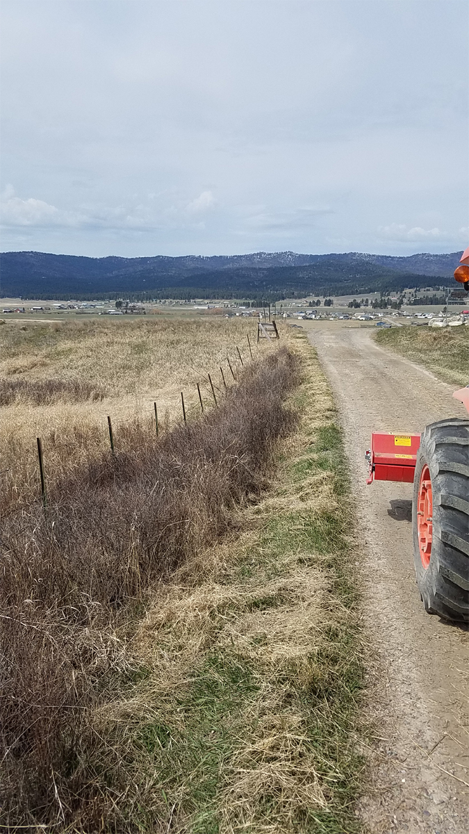

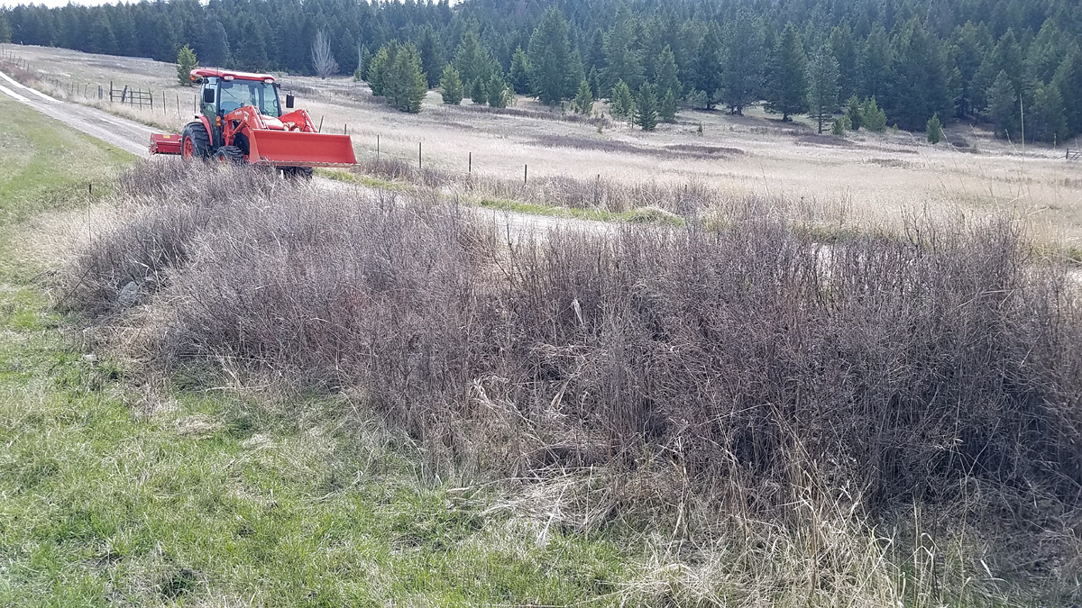

These banks are steeper than they look, and not something that I could cut without the ditch bank flail. And when you want to use it as a mower, it works for that too.
