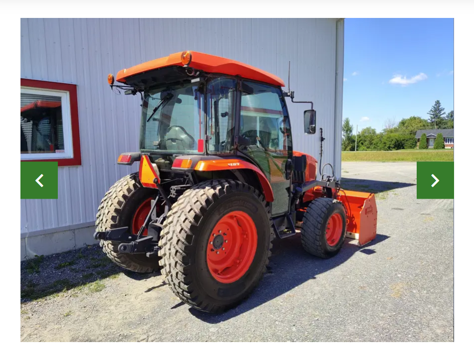

Depending on what rims you have, you may be able to adjust the spacing with the wheel center/rim and not need spacers. Post a picture of the wheels.
If your wheels look like these, you can simply swap the tire/rim side to side to gain width. Leave the center in place and remove the 6 bolts on rim.
