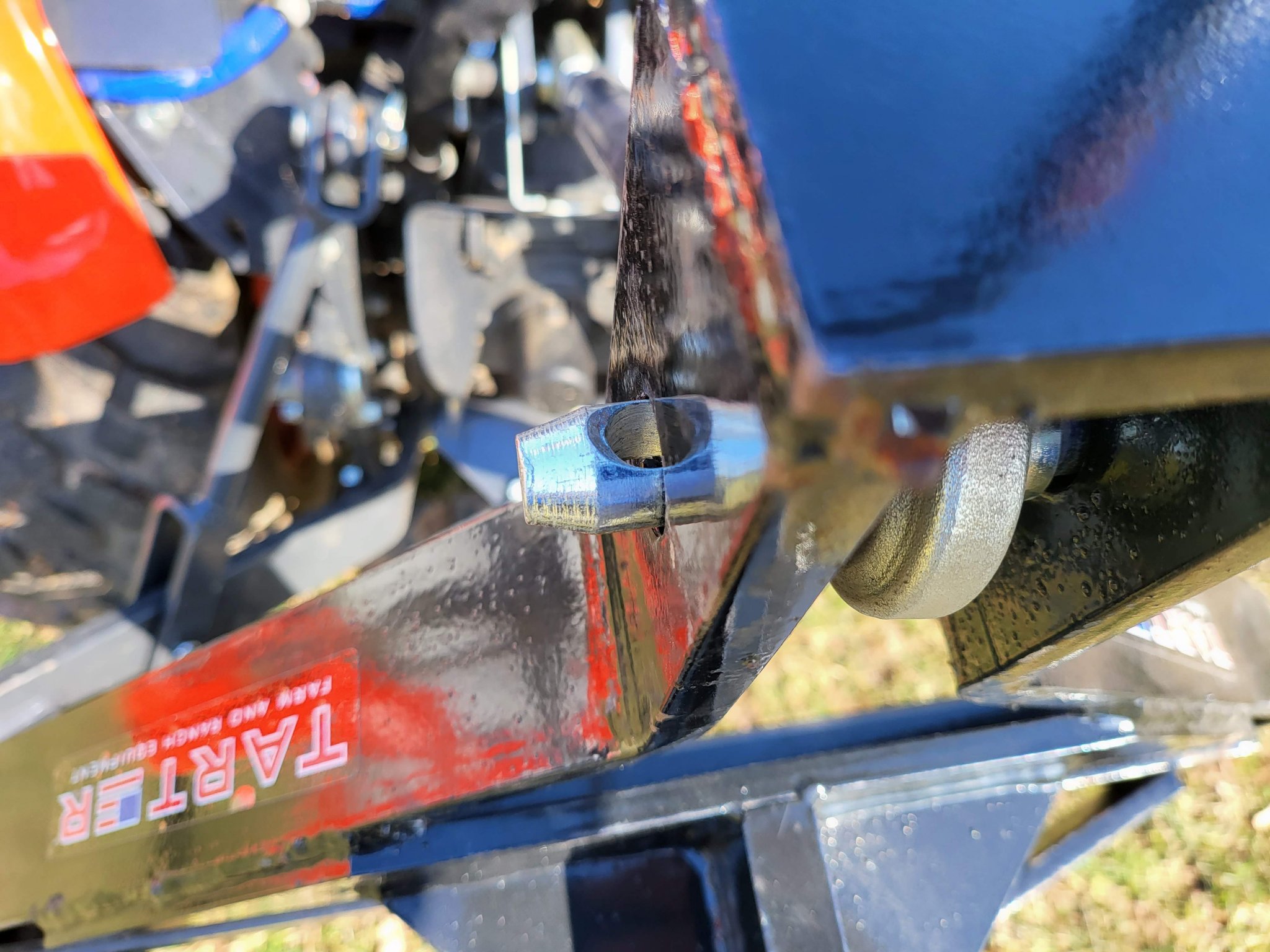

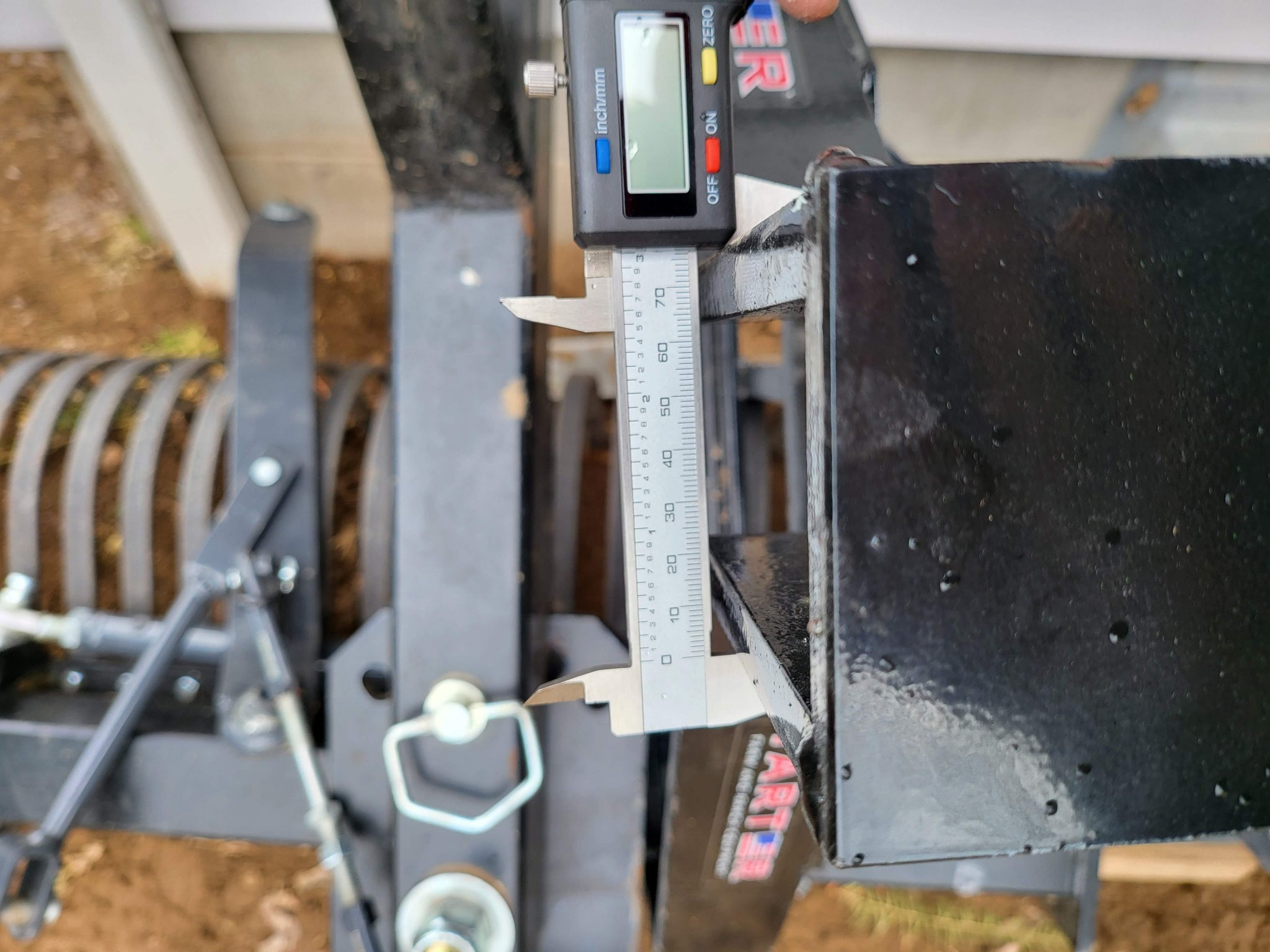

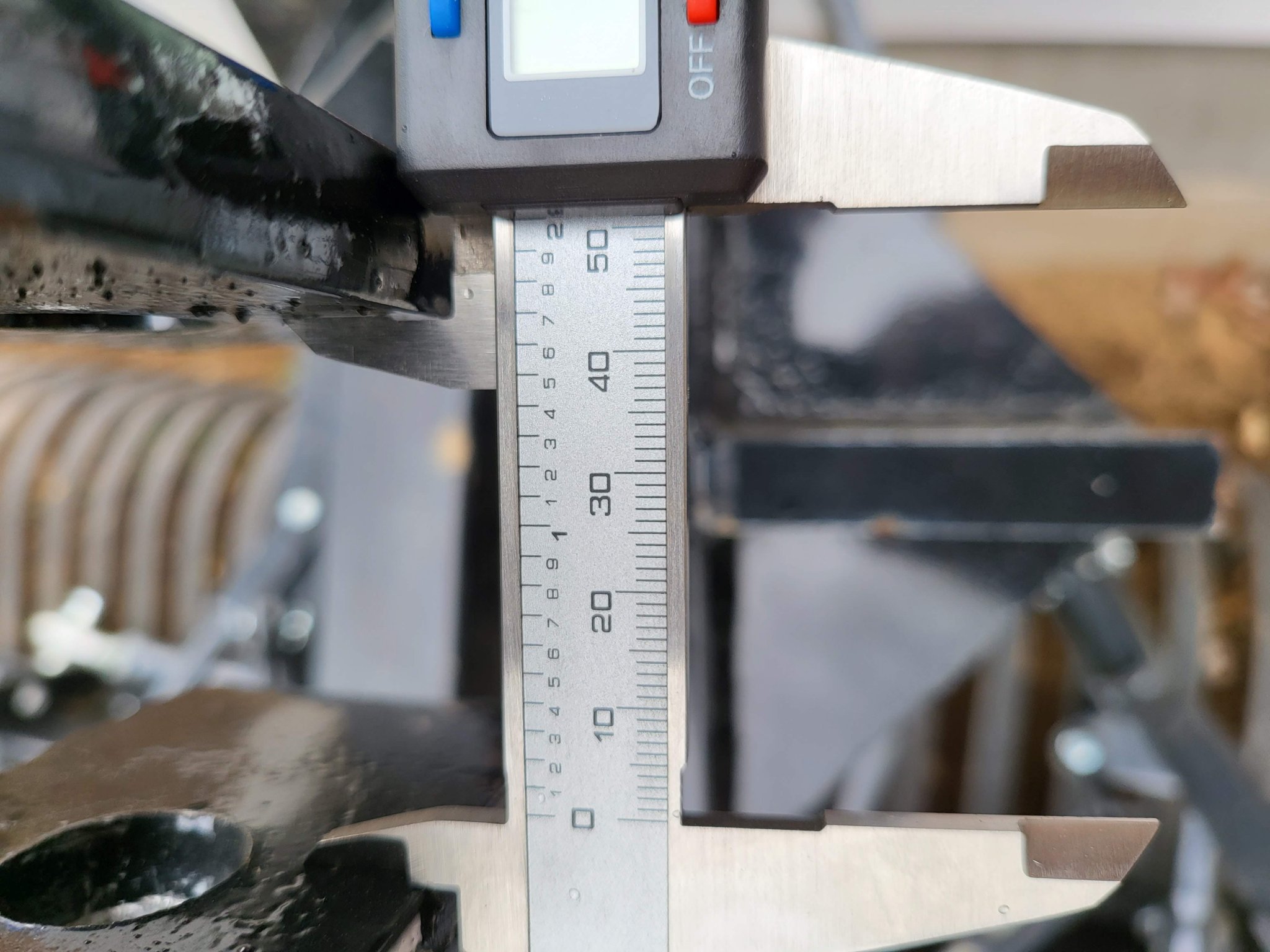

Hello. I've researched but cannot find if there are standards for the upper pin mount--specifically inner and outer measurements. I've found tons of standard references for pin sizes and numerous other data points but not this.
I'm asking b/c my pin does not go through this implement far enough--see pics.
Thank you!

There is no standard length, just get a longer pin from a tractor supply or internet.
