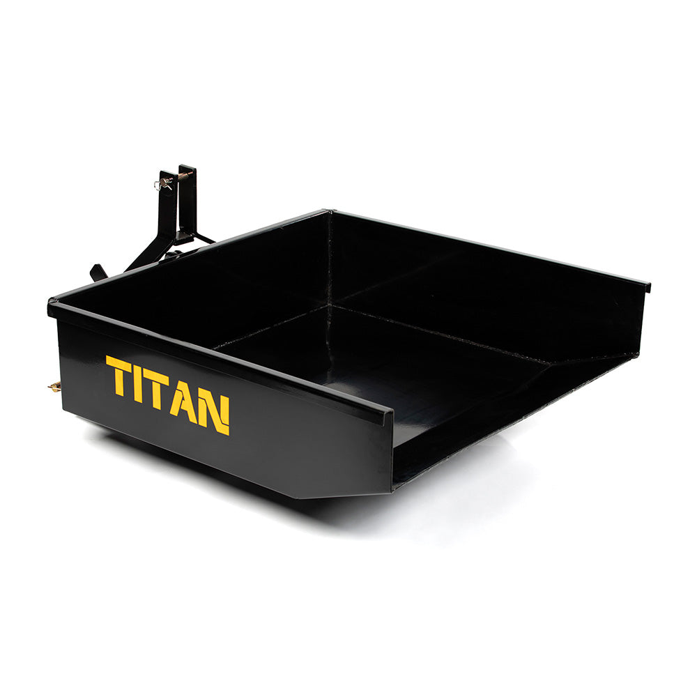

I have just purchased my first tractor. A L2502 with FEL. I am looking into options for a ballast box, and always like the idea of one tool performing multiple tasks. For what I will be doing I will be getting a carry platform like this one from Titan…https://palletforks.com/products/3-point-carry-all-with-steel-platform.
What are your thoughts on using this as ballast? I would strap down bags of play sand for the weights.
Thanks for any and all input.

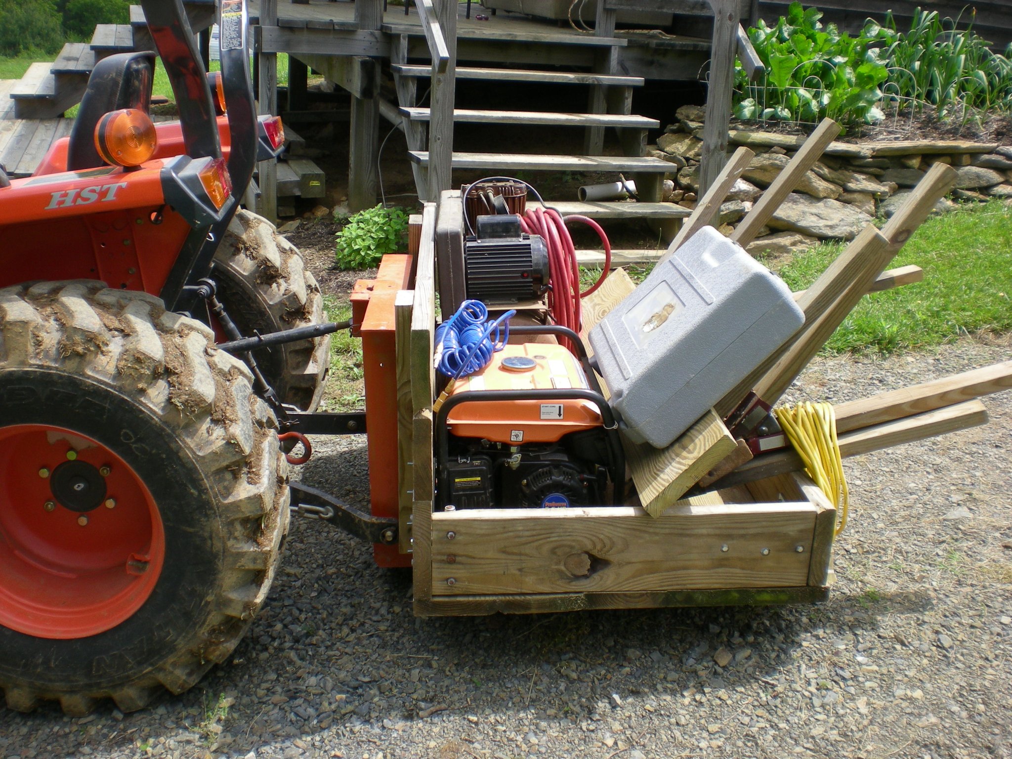

You could have a 3rd skid as a 'tool platform'.

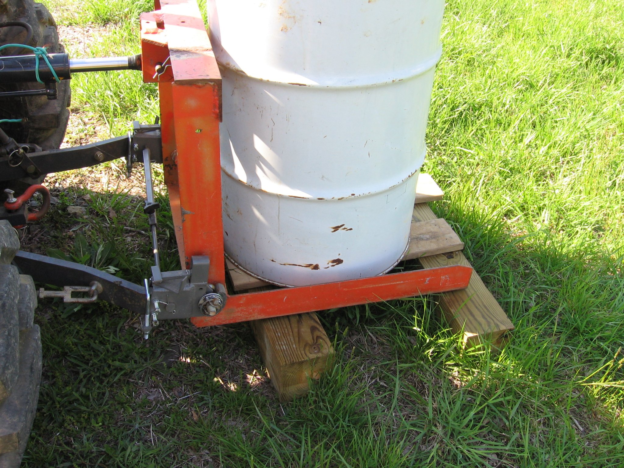

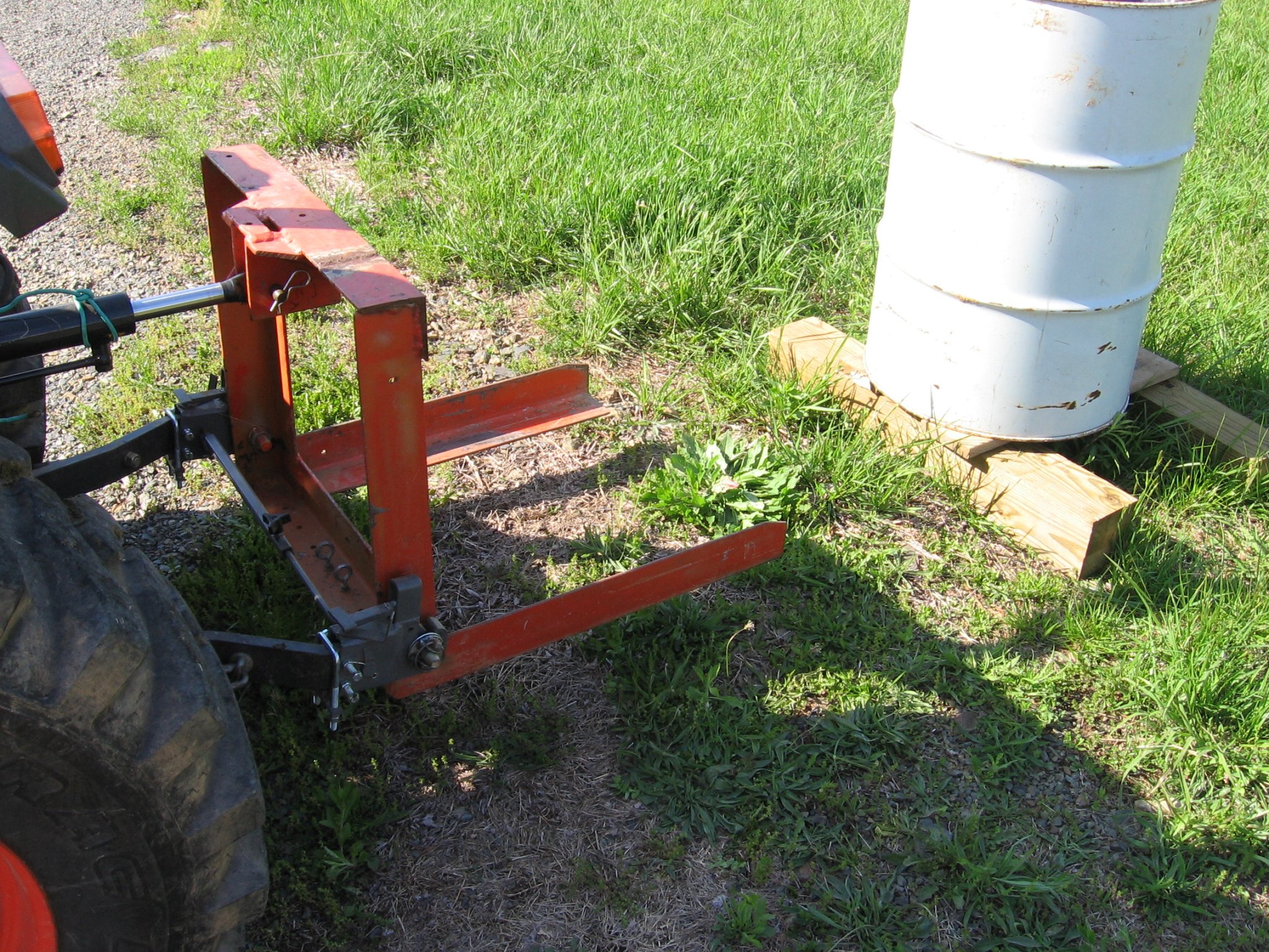

I use a set of homemade forks (fixed width) to pickup 55 gal. drum of weights. Or an empty wooden box to carry tools. Loading and unloading bags of sand sounds like more work than I would want to do!

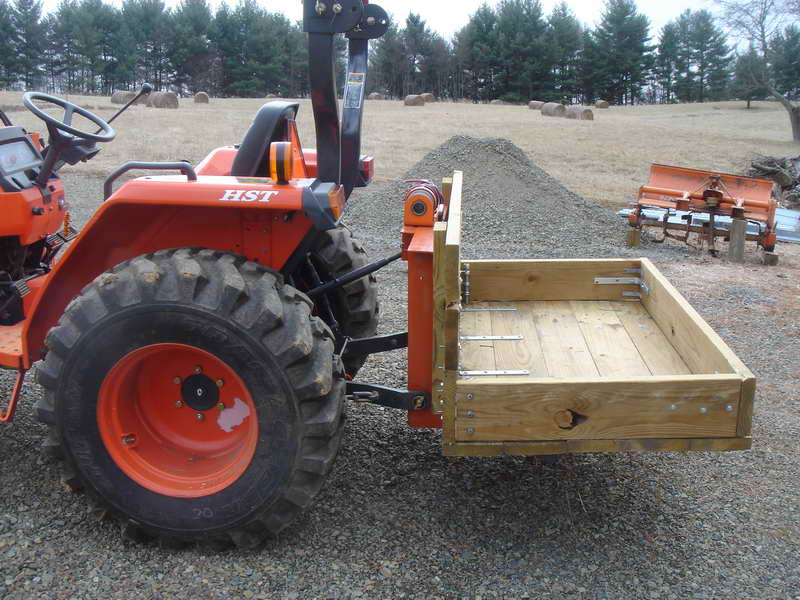

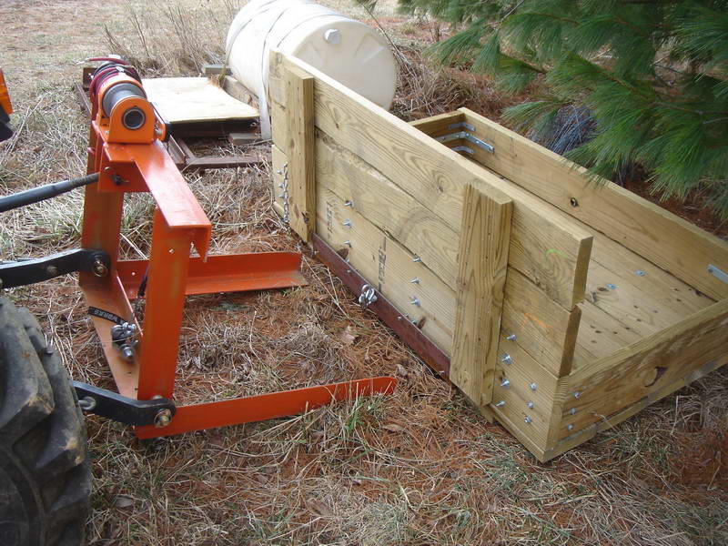

if planning to start with the titan as a platform, I’d probably add some stake pocket brackets and make some side and a tail gate of some sort…might make it more versatile.
The rural king / tsc carryall frames are a good start point as well (that’s what I have).

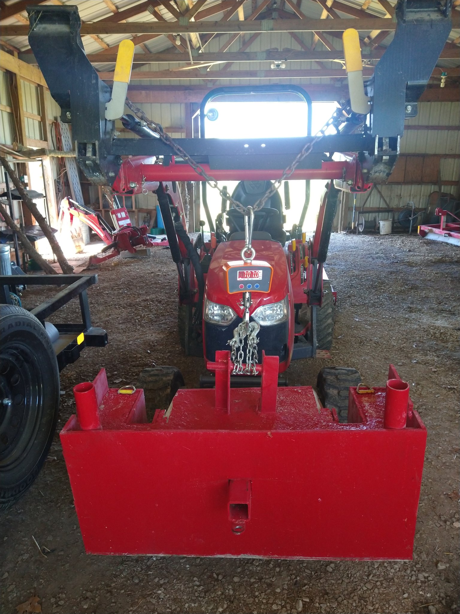

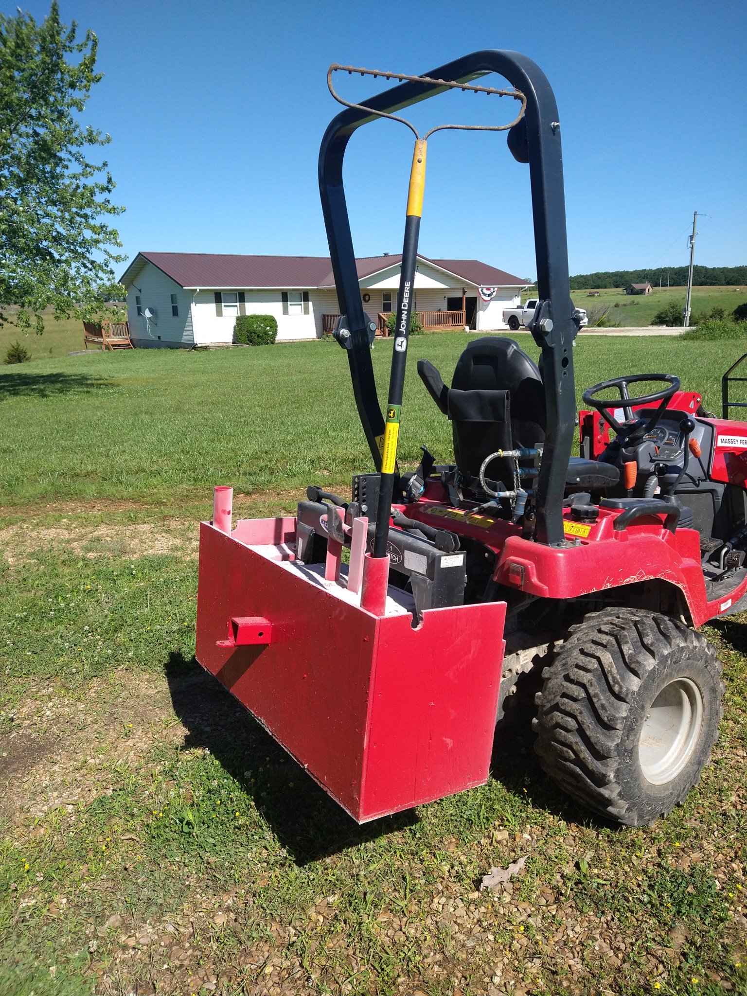

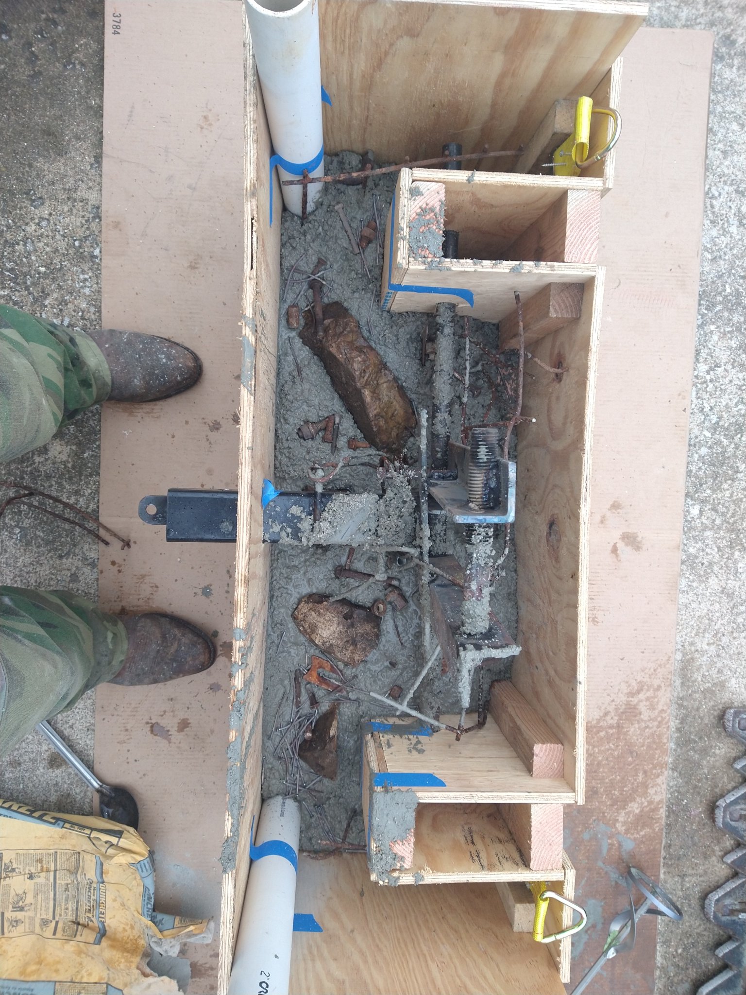

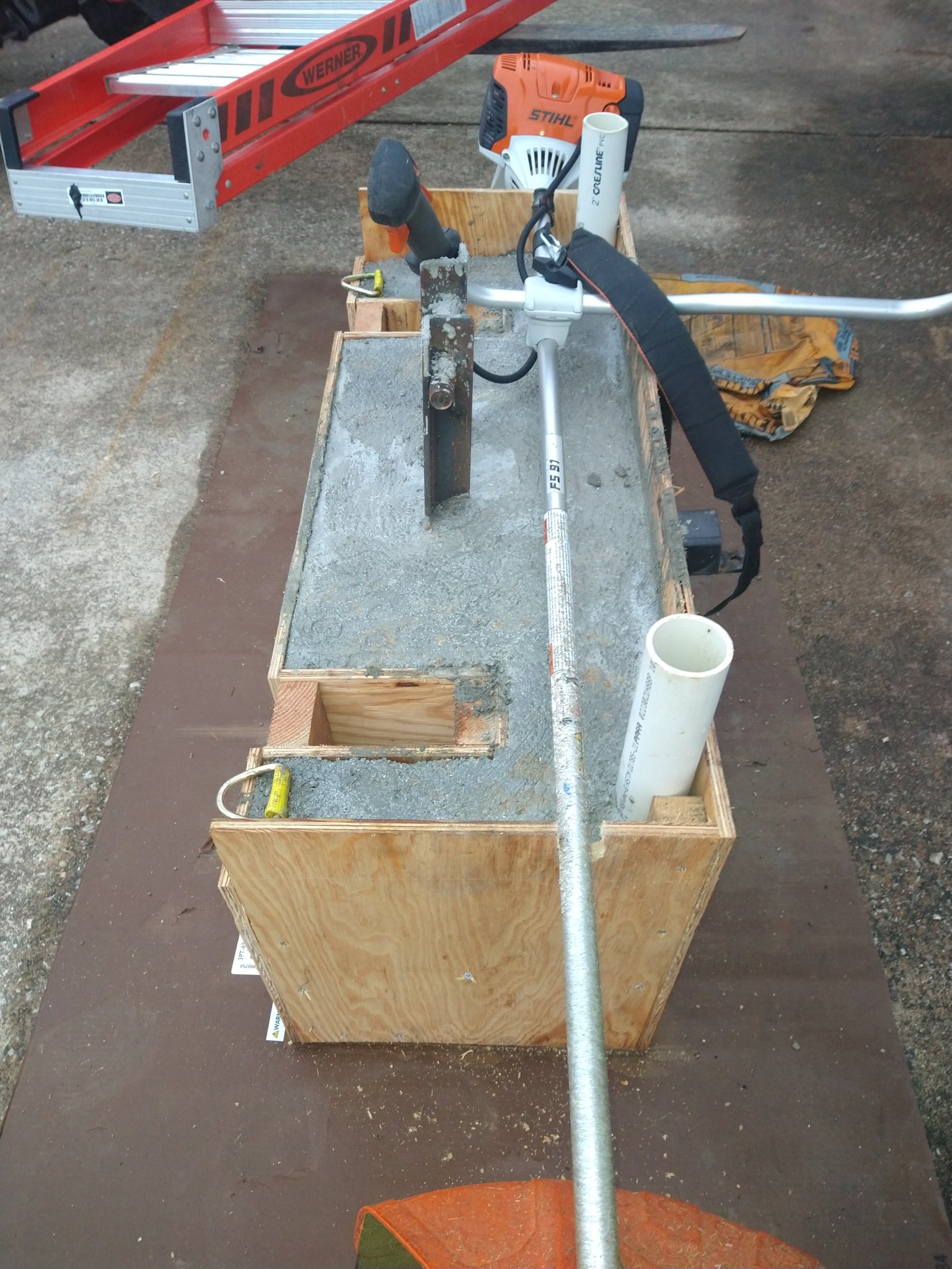

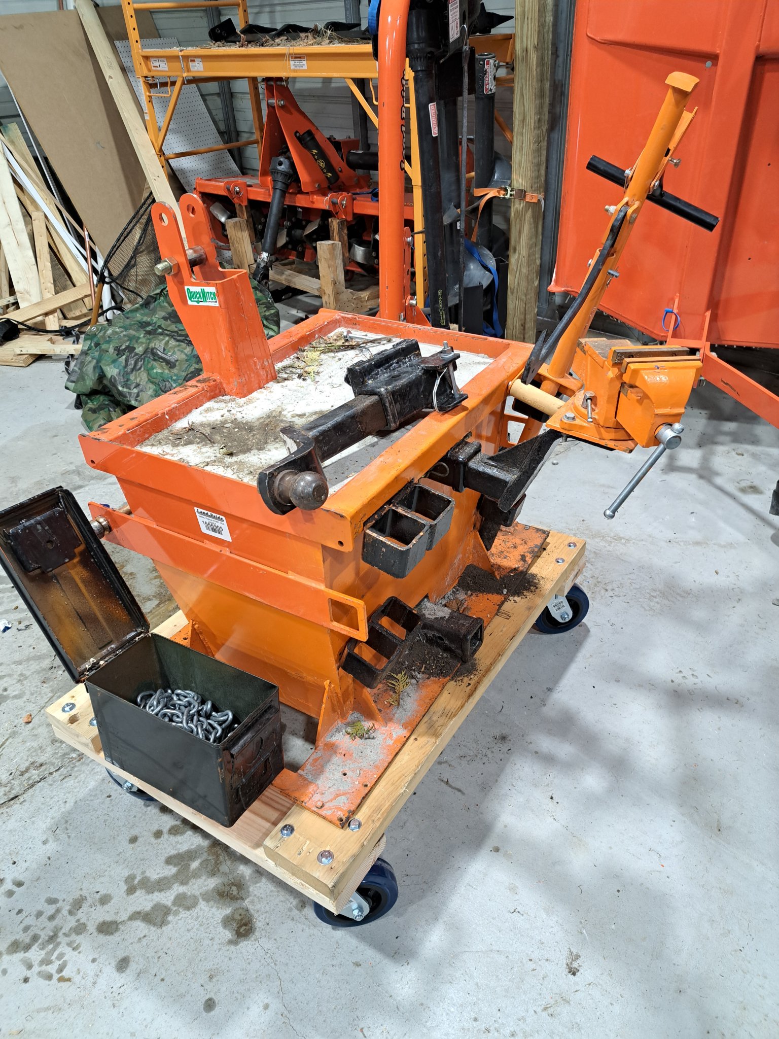

I built my own ballast box, but usually have other things in the back, currently a BH ... My BB has vertical tubes, horizontal "slots" to carry my trimmer, a lip around the top, tie down points, and a 2" receiver hitch also ... It is not only quick hitch compatible, but sits closer to my rear tires than any standard BB that isn't making use of a QH ...

Thanks Shawn T. If you have time and the inclination, please add a pic of your setup.

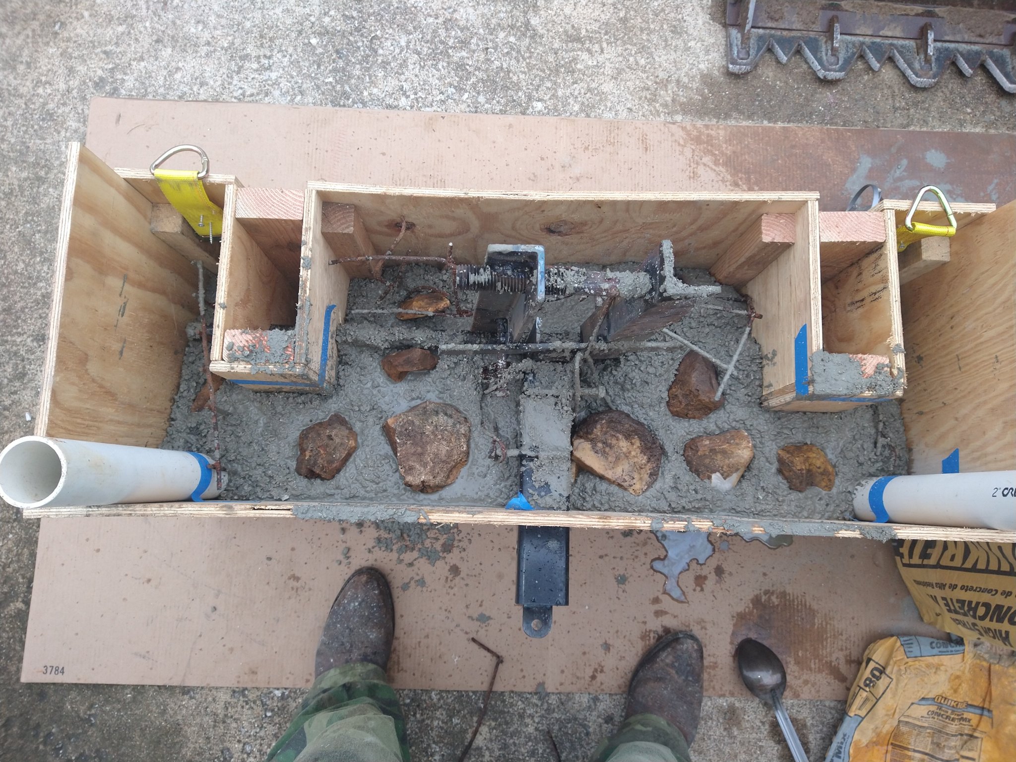

Please note - this was designed by me, for me, I'm a truck driver, not a designer ... Borrow whatever you want, if any ... Cost me less than $100 and time, I had the steel already kicking around ...

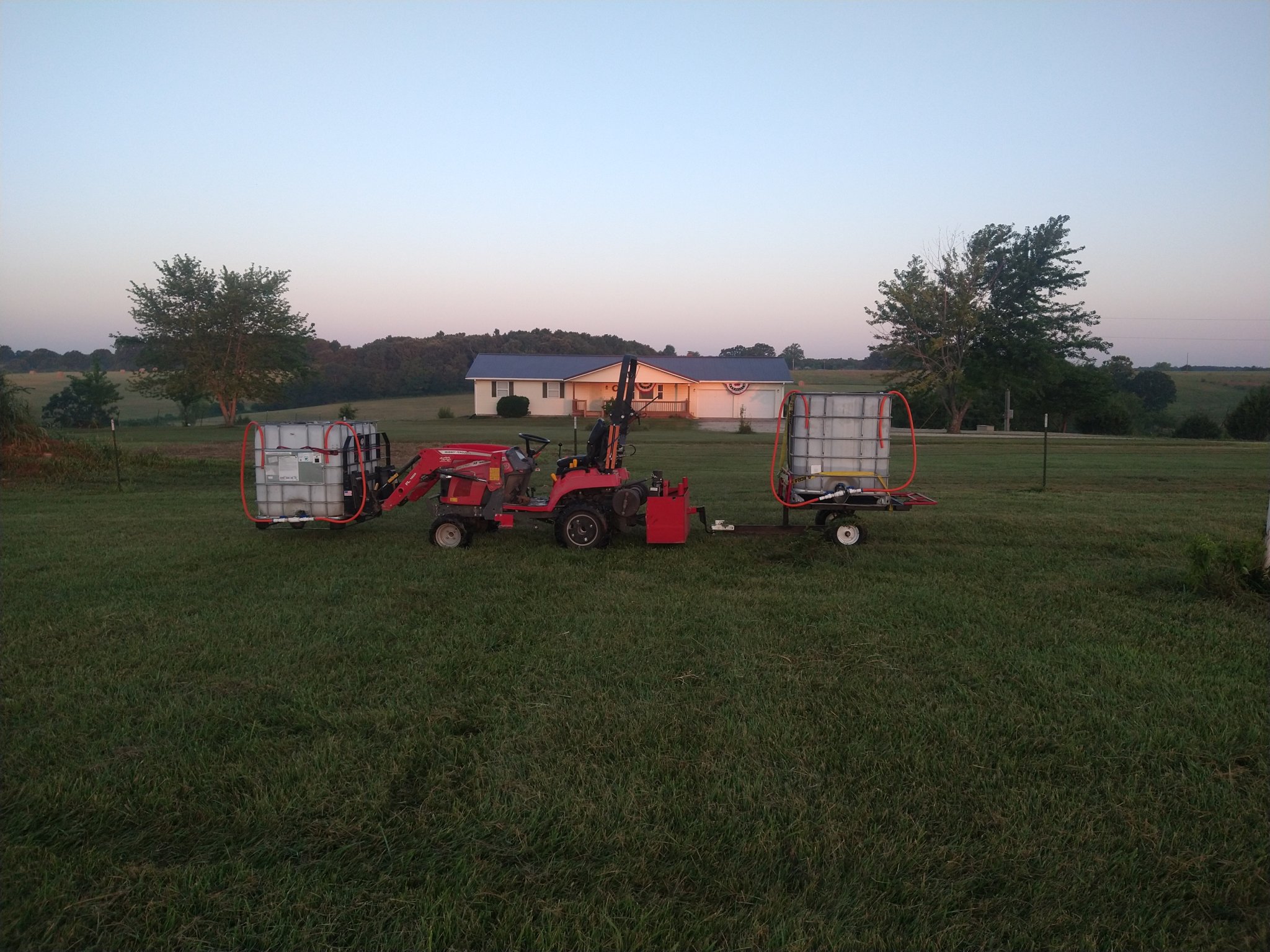

My design was for the lower arms of my QH to fit into the recessed areas, to keep it as short as possible, by also making it wider than the normal BB which usually rides between the lower arms ... My "PRIMARY" Purpose for it was to offer rear ballast for carrying a tote of water on my forks on the loader in the front, AND pull a trailer with another tote of water on the back ...
I made a box of plywood ... And practiced my welding ... I added rocks to "stretch" the 6 - 80 Lb bags of concrete mix ...
I painted it to match my tractor ...This weighs 707 Lbs!
This is my primary use ... It's still kind of a long set up ...
My Massey Ferguson GC 1725 MB is similar to a BX series Kubota ... If you are buying forks, I'd recommend the lightest weight ones you can find, 42" and a "backrest" ... Mine I bought during the COVID supply chain shortage, and mine are rated for 4,000 Lbs, which is way overkill for my little tractor, yours too! Mine weigh 347.4 Lbs, which means it can't lift as much stuff ... For example I can only carry 50 gallons of water in the front tote, due to my little tractors lift capacity, weight of forks, and weight of tote ... !

I forgot to add ... That it won't work with just regular lower arms, it needs the quick hitch to be able to reach in and "grab" the lower pins, which really is a single piece of either 3/4" or 1" black iron pipe ... I just used masking tape to hold the plywood in place, as once the concrete was poured and set up, I had to wiggle those upright 2x4's out, only the 1.5" square wood pieces are screwed to the plywood ... But you can barely see the pipe which goes through the upright 2" angle iron ... And I tossed in a bunch of old rusty bolts and junk too, steel is heavier than concrete!
Yep, that all makes sense. I was wondering about the lower pins for quick hitch. I was assuming you had something down there that I wasn’t seeing. I see it now.
