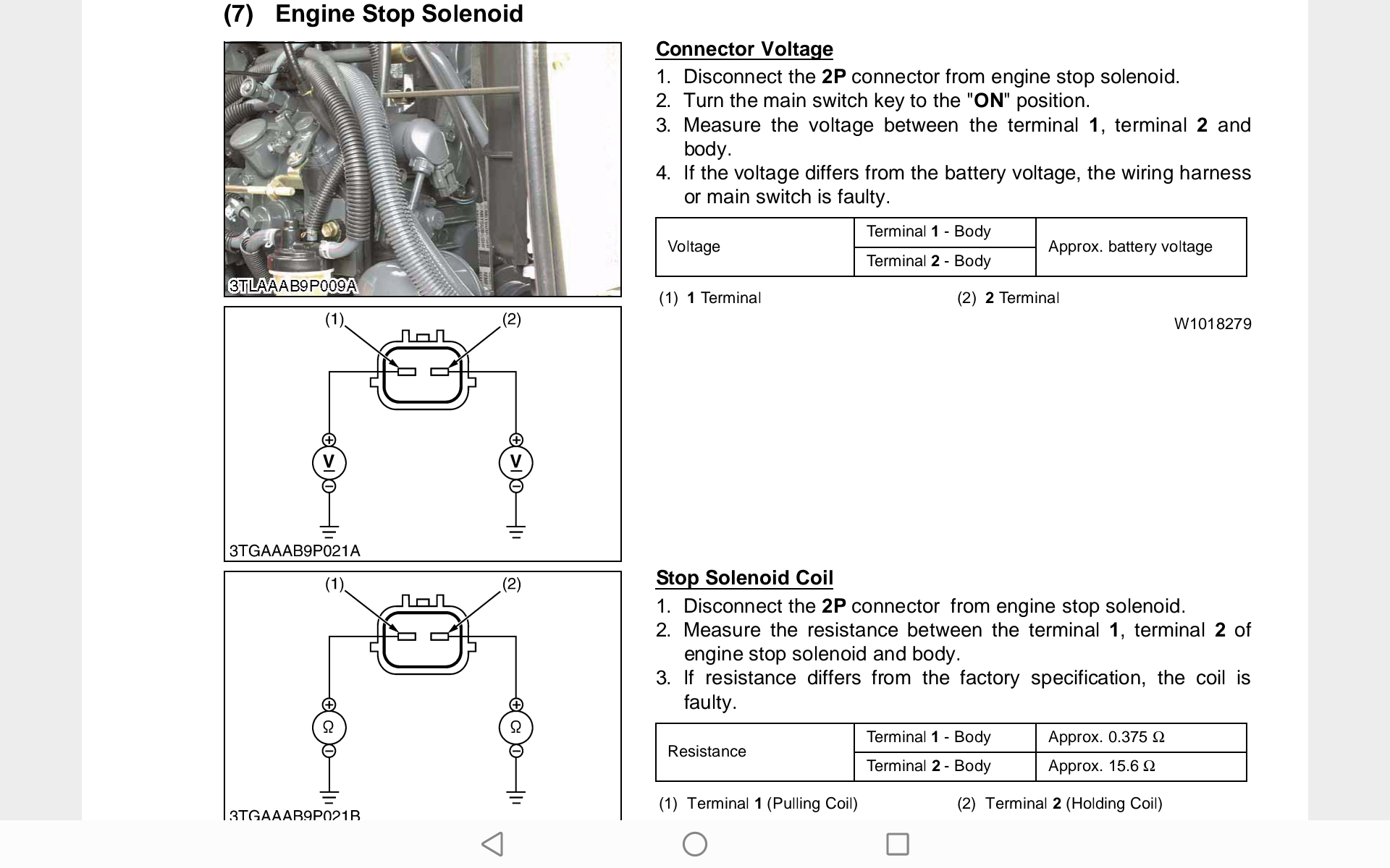

The stop solenoid you have stops the fuel supply when the voltage is off. It has two coils, one with very low resistance of 0.375 Ω for pulling in the plunger and a second one with 15.6 Ω to hold the plunger while running.
The low resistance coil is disconnected by an internal contact when the plunger is pulled in (engine running). A fault in this disconnect contact would burn the winding, but then the 30A fuse would blow, I would think. Did that happen?
Another reason could be the holding coil dissipating too much power, for example when your alternator voltage is too high. Have you measured the battery voltage while the engine is running?
And yes, the question from GreensVilleJay: what happens when the solenoid dies? Did you measure the resistance of the two coils? Is it possible that there is a problem with the connector contact and at some stage the pulling in coil does not get enough current and the engine does not start?
Is it possible that the mechanism connected to the plunger is not running freely, so that it takes a while for it to engage and the pulling in coil gets too hot and evetually burns out? Or some of them cannot pull in the plunger at all and hence the 30A fuse blows?

You could try a sort of operational check. Jump from 12 volts to each connection separately on the solenoid. When you energize one, the hold coil, nothing should happen, since it won't have enough force to pull in. When you energize the other, pull-in coil, it should buzz as it pulls in then de-energizes. If it clicks and stays energized, something is preventing it traveling and turning off. This would result in over heating that coil. Don't energize the coils for more than a few seconds during this test.
