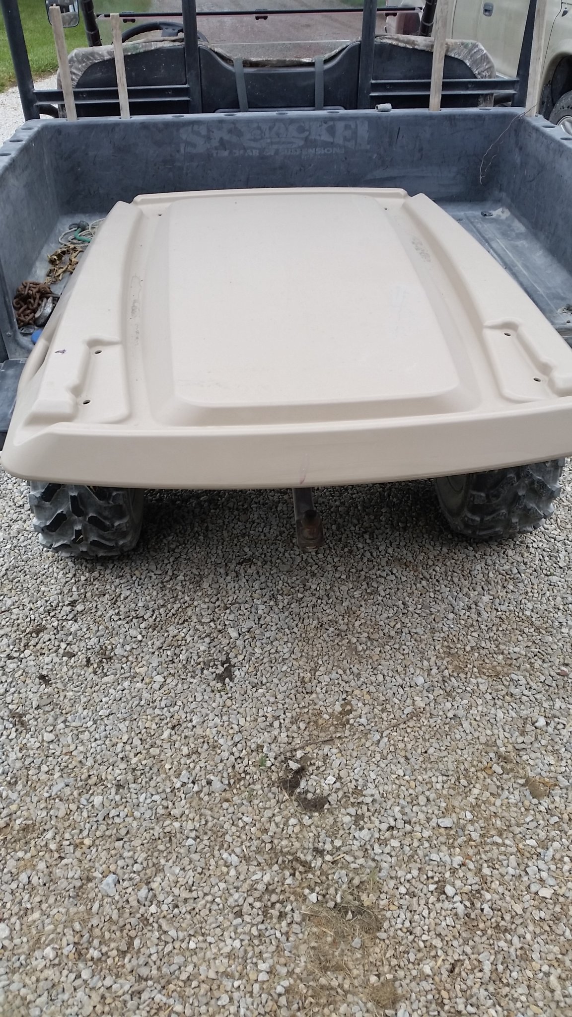

This is where I get mine. He has a bunch. $20 each.
They are too heavy to mess with shipping, but you may find some at your local golf cart dealer.

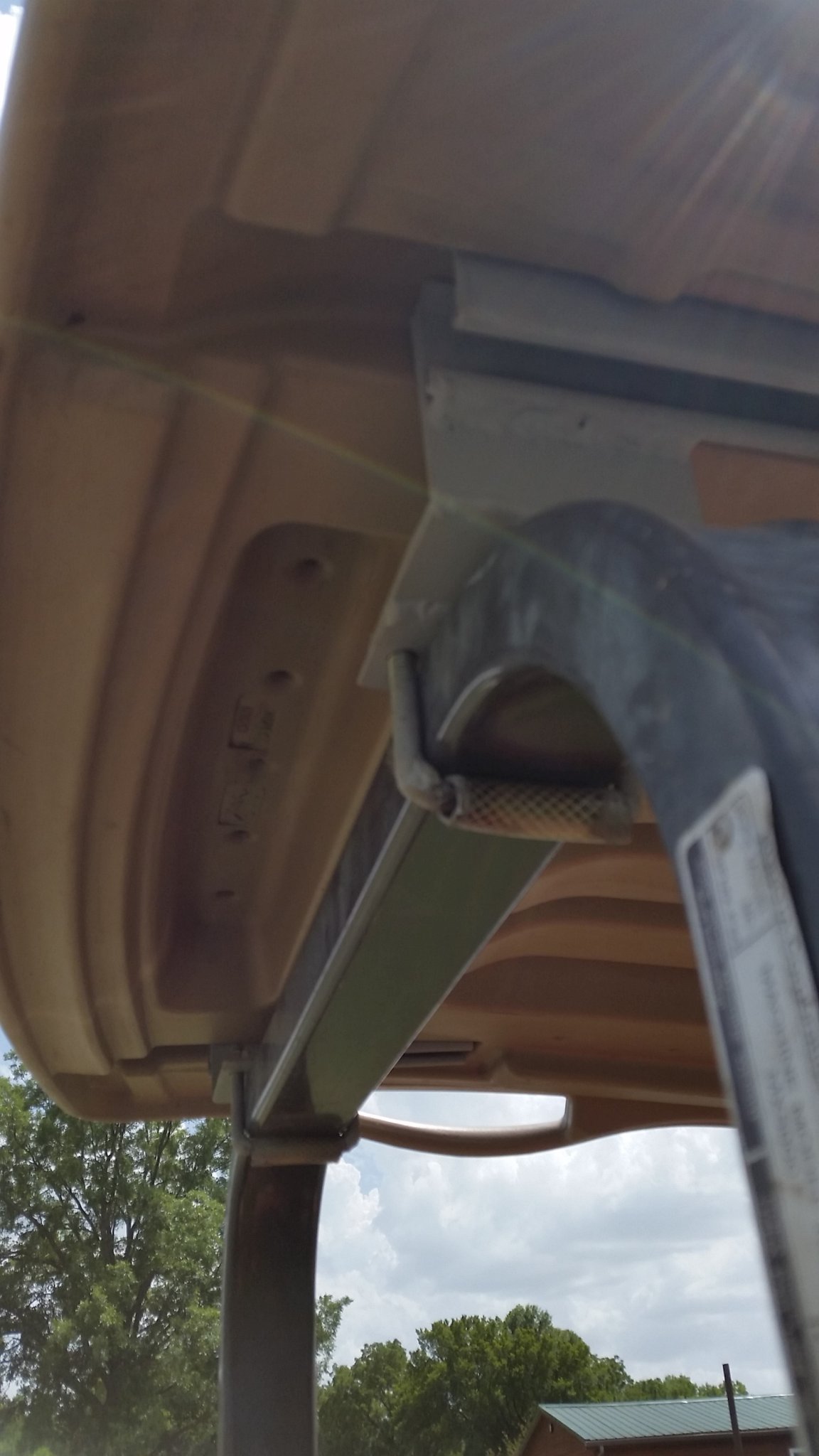

The hardest part for installing was allowing clearance around the ROPS - I think I measured 8 times and cut with a multitool. It did fit like a glove. And the other hardest part is installing the #$%$@#$ thing with zero help....... as I recall I had to "A" frame ladders and a piece of 2x6 to get it to stay inside the ROPS to be locked down.
I have towed the BX at highway speeds with zero problems too - nice to have places to hide stuff too on the golf top. Canopy.jpg

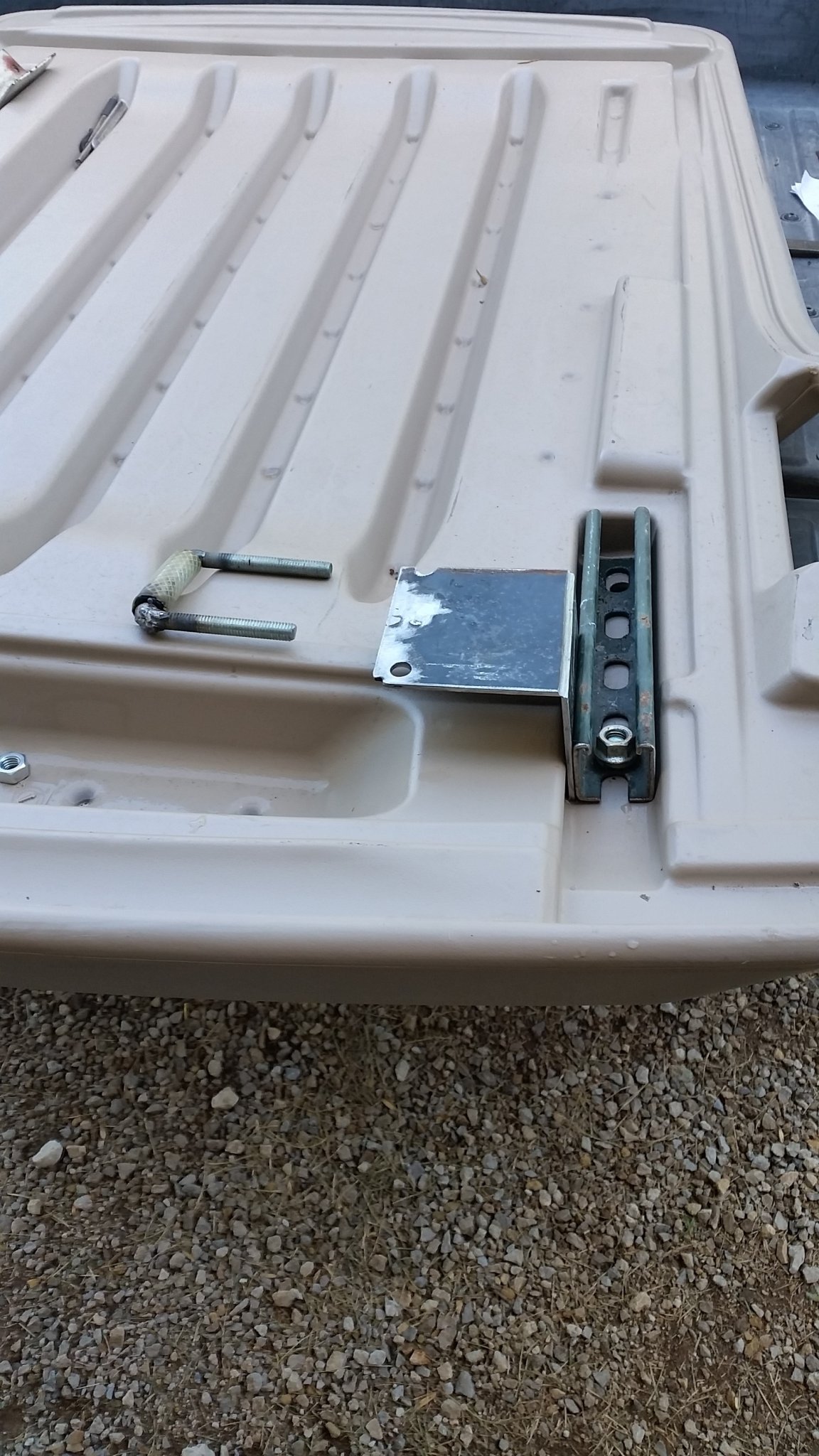

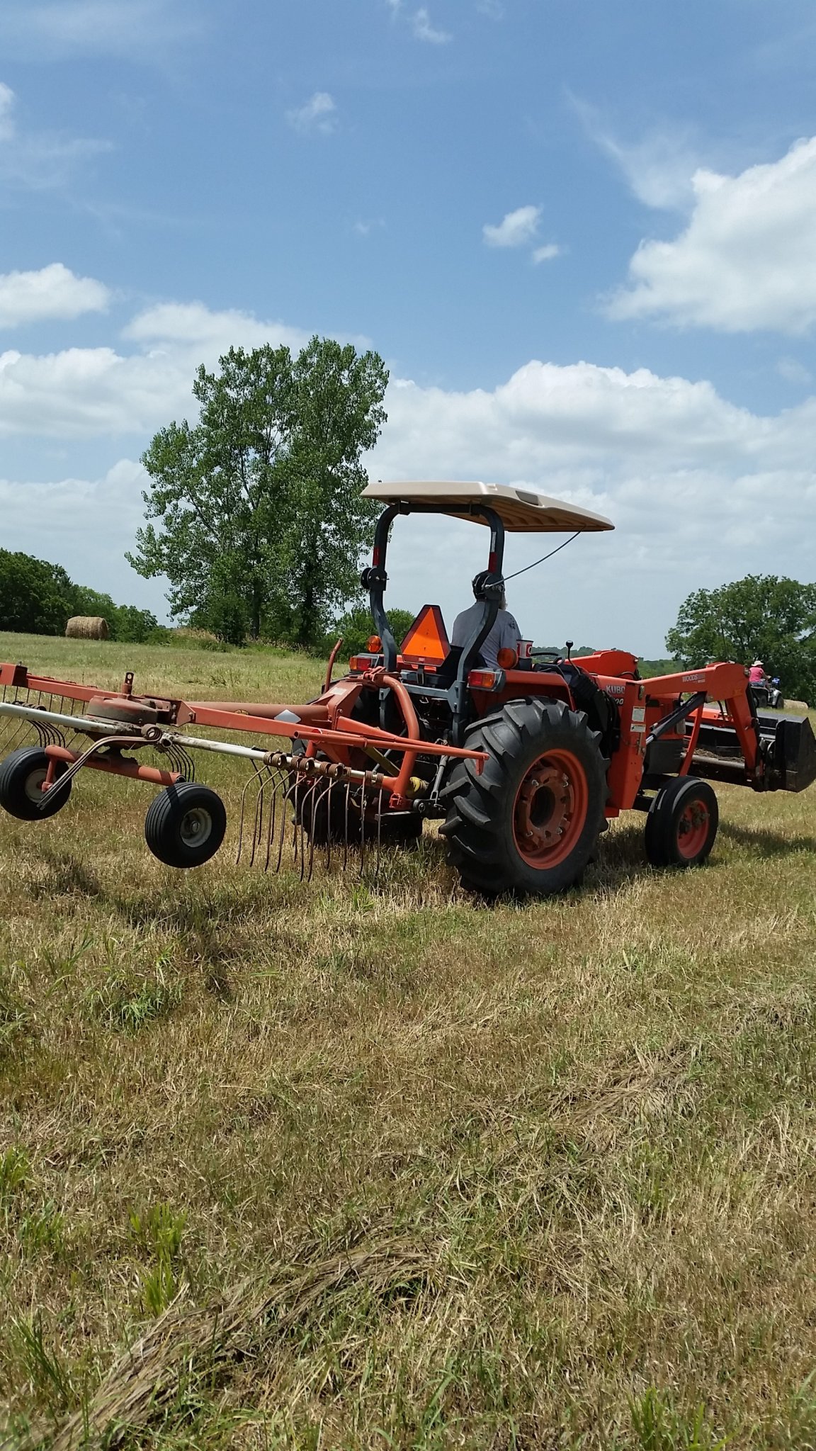

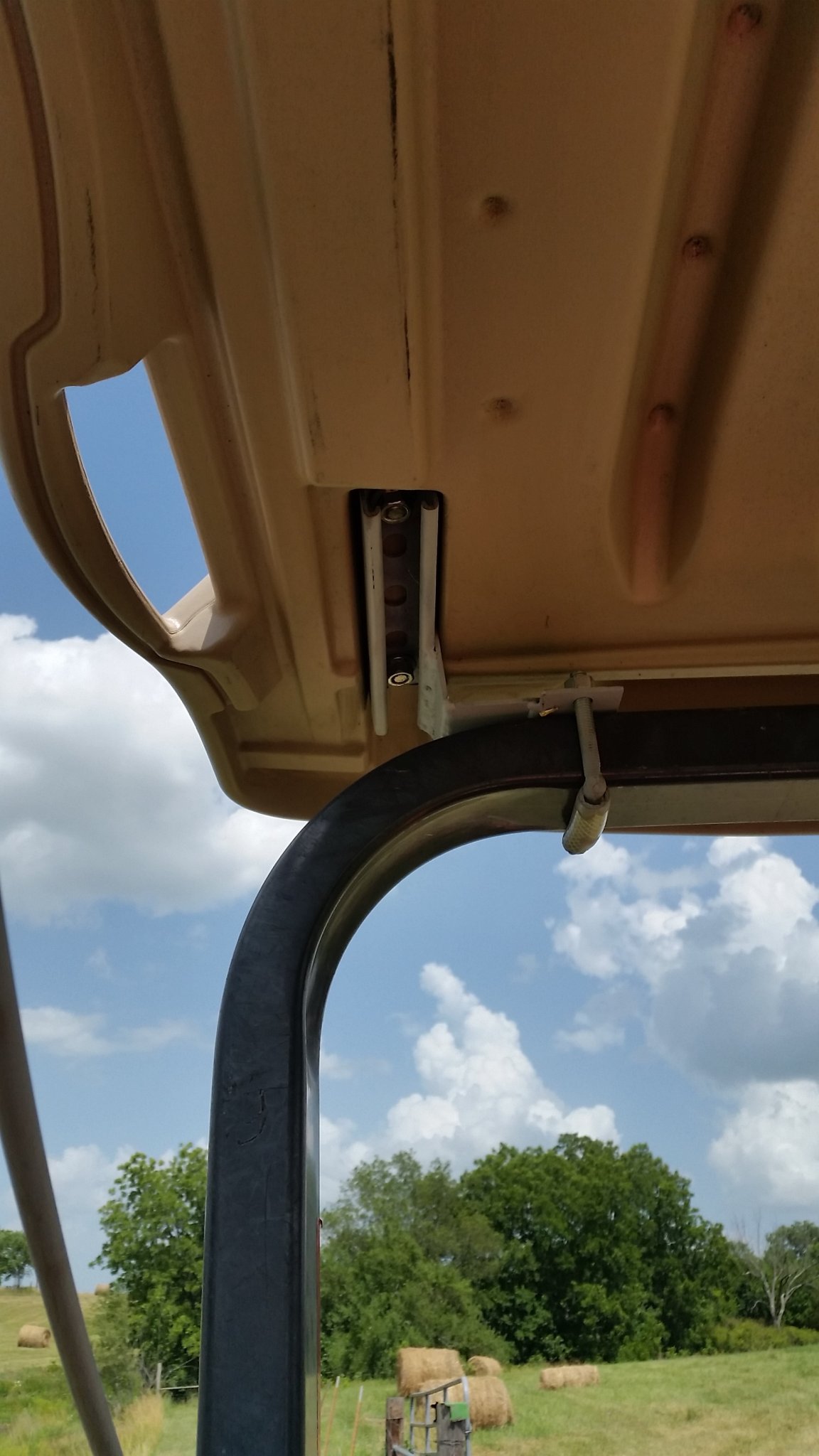

I went the easy route. I had all the materials and just created as I went. My neighbor cut, raked and baled a small field for me and would not accept anything for it. His wife did all the raking and it was 95 deg and she wore a big hat, so I decided to help her out. It was "her" tractor (an M50xx something). He baled with an M9540.
I did not drill any holes, only used what was already there, even for the rod used to brace the outer edge.
