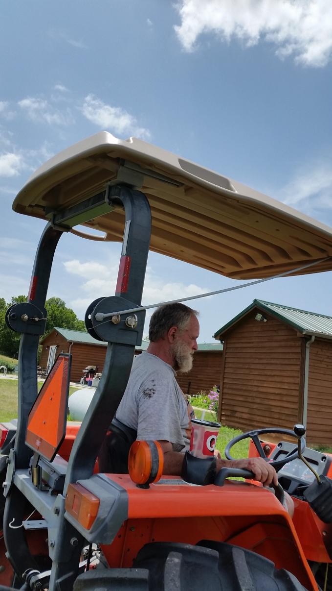

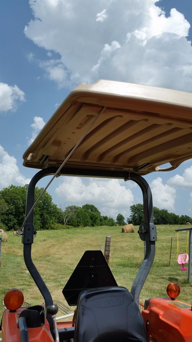

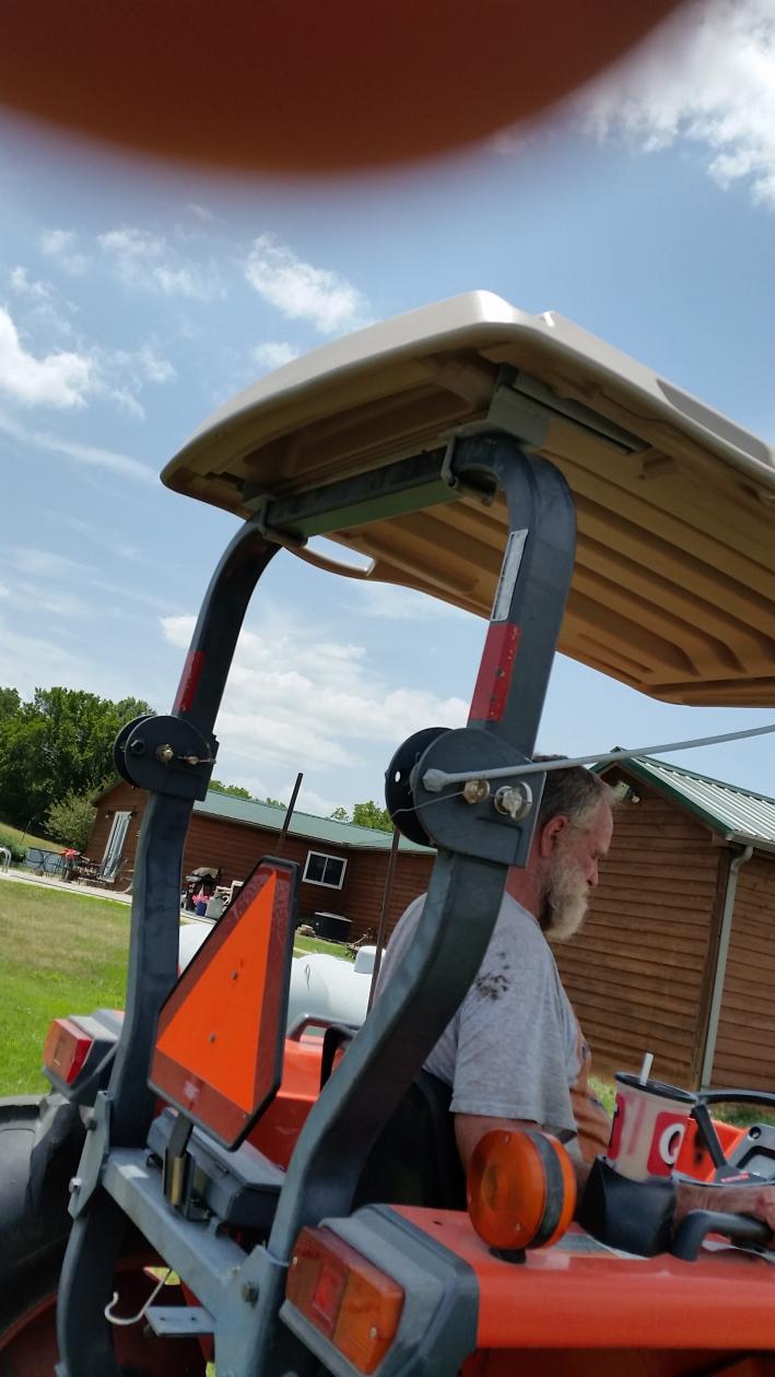

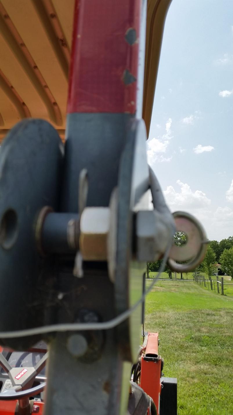

Here's some pictures that may give you an idea of how to fix it. Adapt as required to fit your situation.
This canopy already had a hole in the front (actually on both sides, I just used one side) and I took a 3/8" rod, welded a bolt on one end up at about a 60 deg angel. I could then put that up through the existing hole in the canopy, install a flat washer, lock washer and a nut.
The rod then comes down at an angle and then welded a bolt at 90 degrees to fit into an existing hole on the ROPS. (It's the hole for the bolt when it's down) Put a flat washer, nut and drilled a hole in the bolt for a hair pin.
