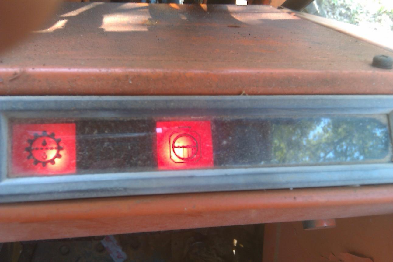

Can anyone tell me what these warning lights mean?

Not my model, but the one on the left looks like a low crankcase oil light, the one on the right I can guarantee you is a low coolant light.
There is a reason these lights are red and not a soothing green or yellow. I would verify the oil and coolant levels, asap.

YEP agree with Asbug, check your fluids ASAP and check the front of the radiator and make sure thats debris free so air can get to it.
