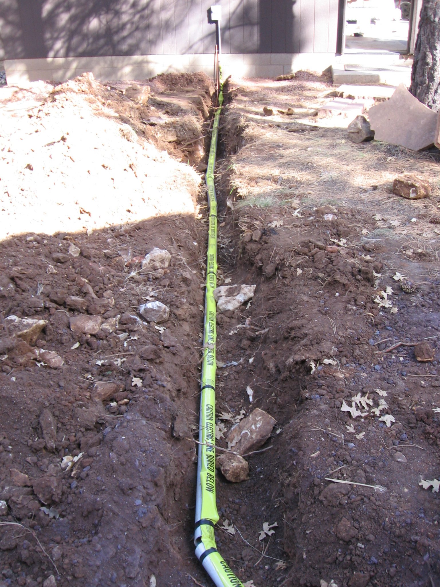

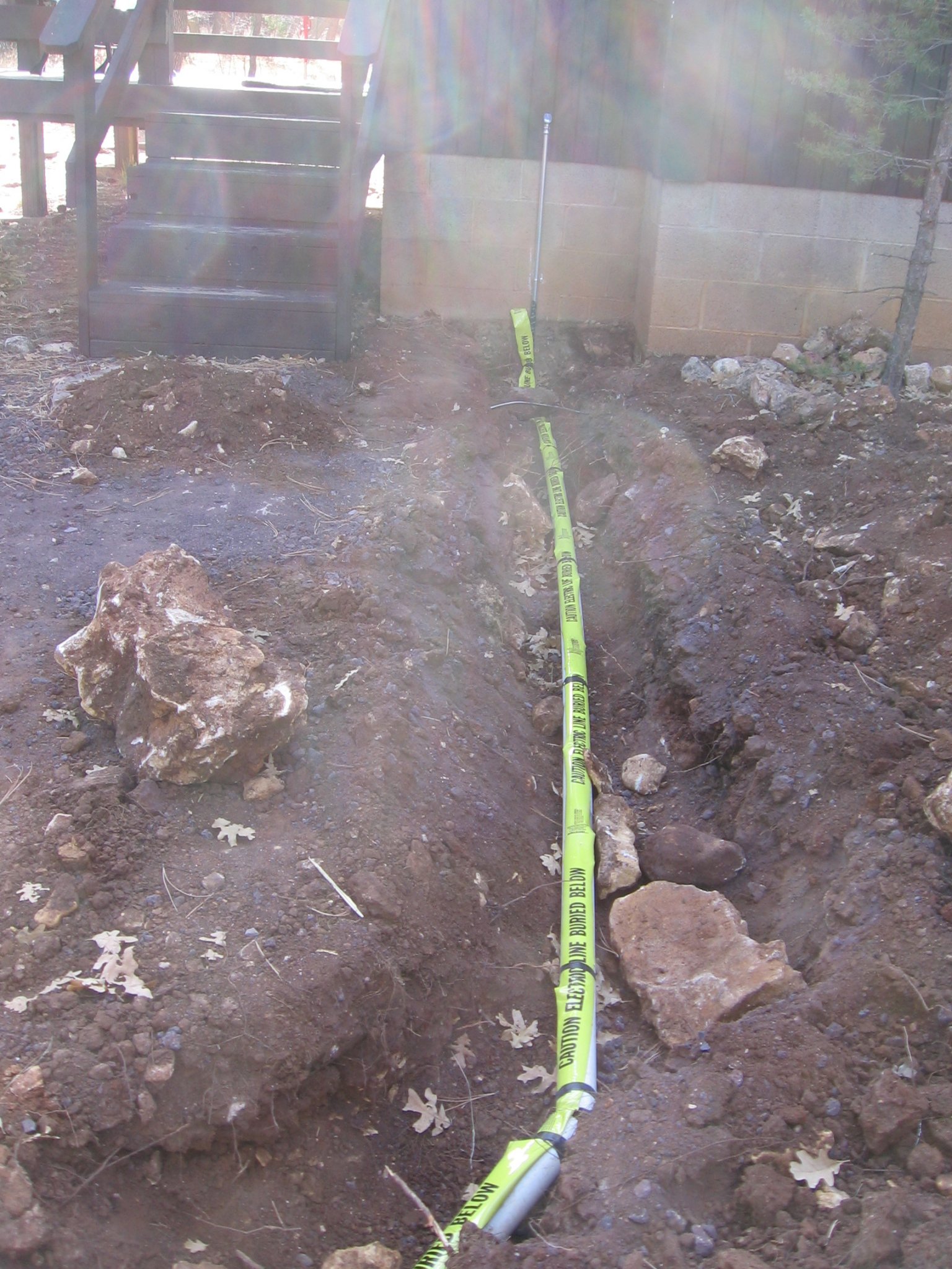

When installing your own "utilities", tracer line is cheap and easy.

What is "tracer line"? A search on that didn't pull up anything that fits.
It is like a foil wrap around the plastic pipe so you can hook up a toner and follow the line underground.

From what I have seen, it is just a wire buried along with the utility line. Some detectors can find the wire without any additional help, some require a toner. For giggles, I hitched up my old telephone wire toner to the gas line tracer and was able to detect it. It is about 18" deep. The wire can be color coded to tell you the utility is, but I'm not sure of the point of that. If the wire comes out of the ground beside the gas line, I would suspect it is to trace the gas line.

In my case, it's a roll of foil tape.
