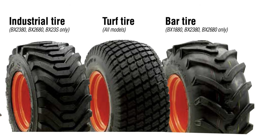

When you go on kubotausa.com the page that comes up shows a BX with R14 tires on it ..... has anybody "heard" if Bx's will be offered soon with R14 tires ? If i "build" a BX it doesnt show R14's as an option, yet.
Are you possibly mistaking the industrial tires as R14? The ones I saw on that website all look like industrial tires. See attachment below for BX tire selections from the BX brochure from the website.
