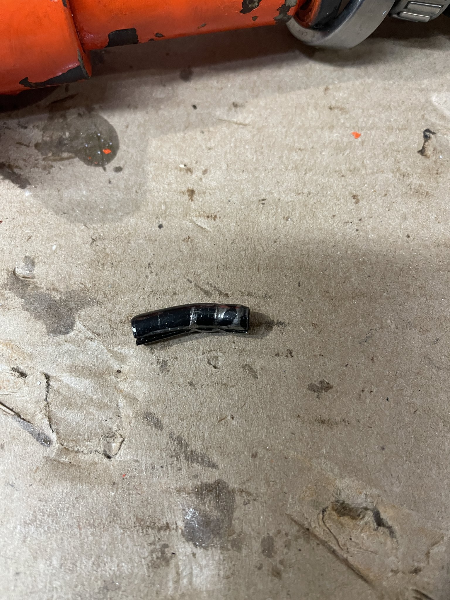

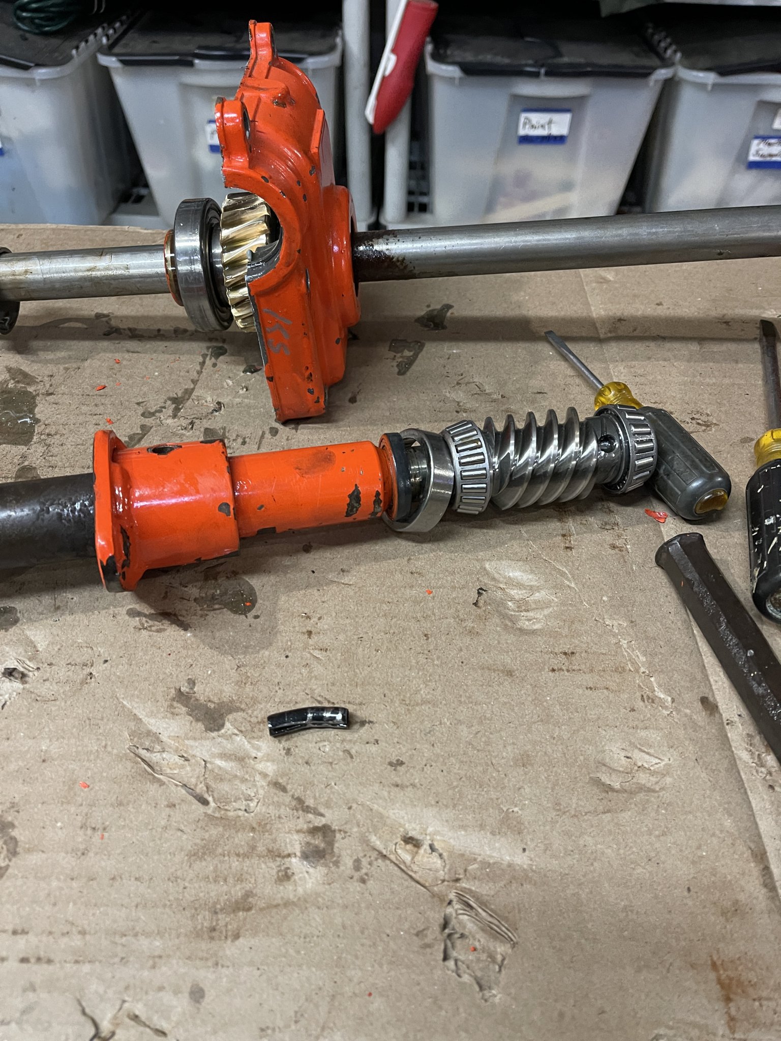

Four year old snow blower hardly used as I have the plow and sweeper for lesser storms. Hooked and ready last storm and the augers would not turn. Shear bolts were fine long story short had to disassemble the whole blower and replace the spring pin inside the front gear box. Never abused or have hit any big rocks etc… anyone else had same luck? Little disappointed in Kubota I paid good money for this equipmen.

wow, man I feel sorry for you..... you'll probably have 10 HOURS into the repair for a $5 part.
'spring' pin is another name for a 'roll pin' or 'spiral pin' ?
I'm thinking it wiggled loose and jammed up the gears ?
if so wrong pin or wrong tool to install. Proper tool has a short, tapered cavity in end of it ,to allow 'spirol' to reduce in diameter without damage when installed.
I've also see instructions to put a SECOND pin inside the first ,for strength
be nice if dealer gave you the new pin as I bet he's NEVER seen that before !

Is the pin now the length of the round shaft..... I am guessing the ends of the pin were sheared off.
I would suspect something was jamming the blower fan and this pin acted like a shear pin.

hard to tell why the pin 'walked' out of the holes,seems nice and well oiled.
perhaps not a tight fit ? part number from kub cda parts...

This a a very common issue with spring pins, either wire or put a second roll pin inside of it to lock the roll pins in place.
