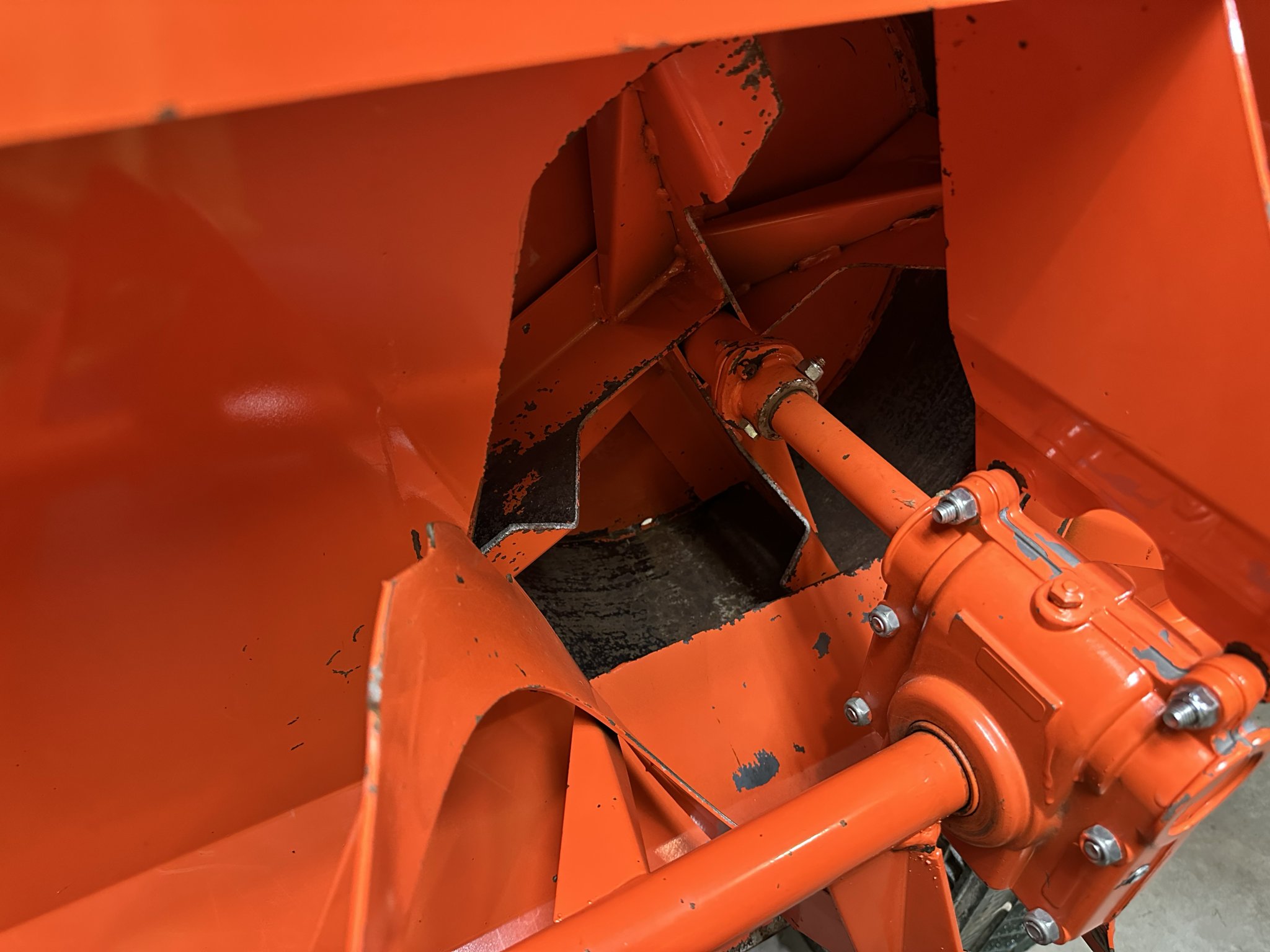

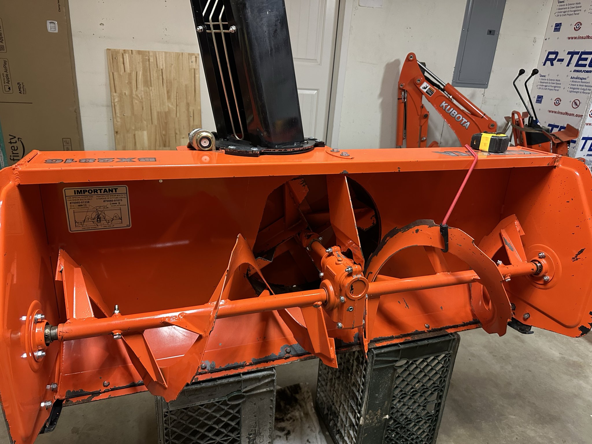

I just purchased a 6-year old BX2816 Snowblower for my BX23s

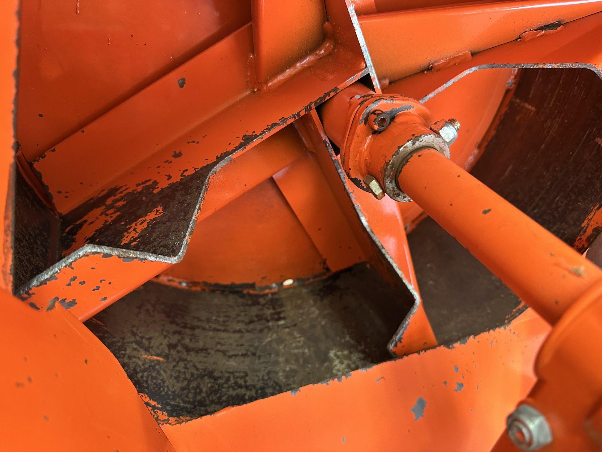

3/4 of the impeller housing area is bare metal..... The bottom is kinda rough.
Should I just coat the area in something like fluid film? Or Wax? Or some other suggestion.
OR should I take it apart and sand and re-paint it.
That impeller housing area is always a area that usually gets the paint worn away.... so I don't think my rattle can primer/paint job will last too long.
What I have always done is use a spray on wax.... preseason and this has helped my 18-year old walk behind snowblower.
10,151
7,007
Working on a stone driveway, my BX2750D snowblower looks like that every spring. Been that way for 12 years.
Same for my JD425 tractor and snowblower for 12 years before that….
I use the rattle can touch up.
I don’t believe disassembly and sanding the blower is time well-spent.
Will look the same after a few sessions in November or December…..
