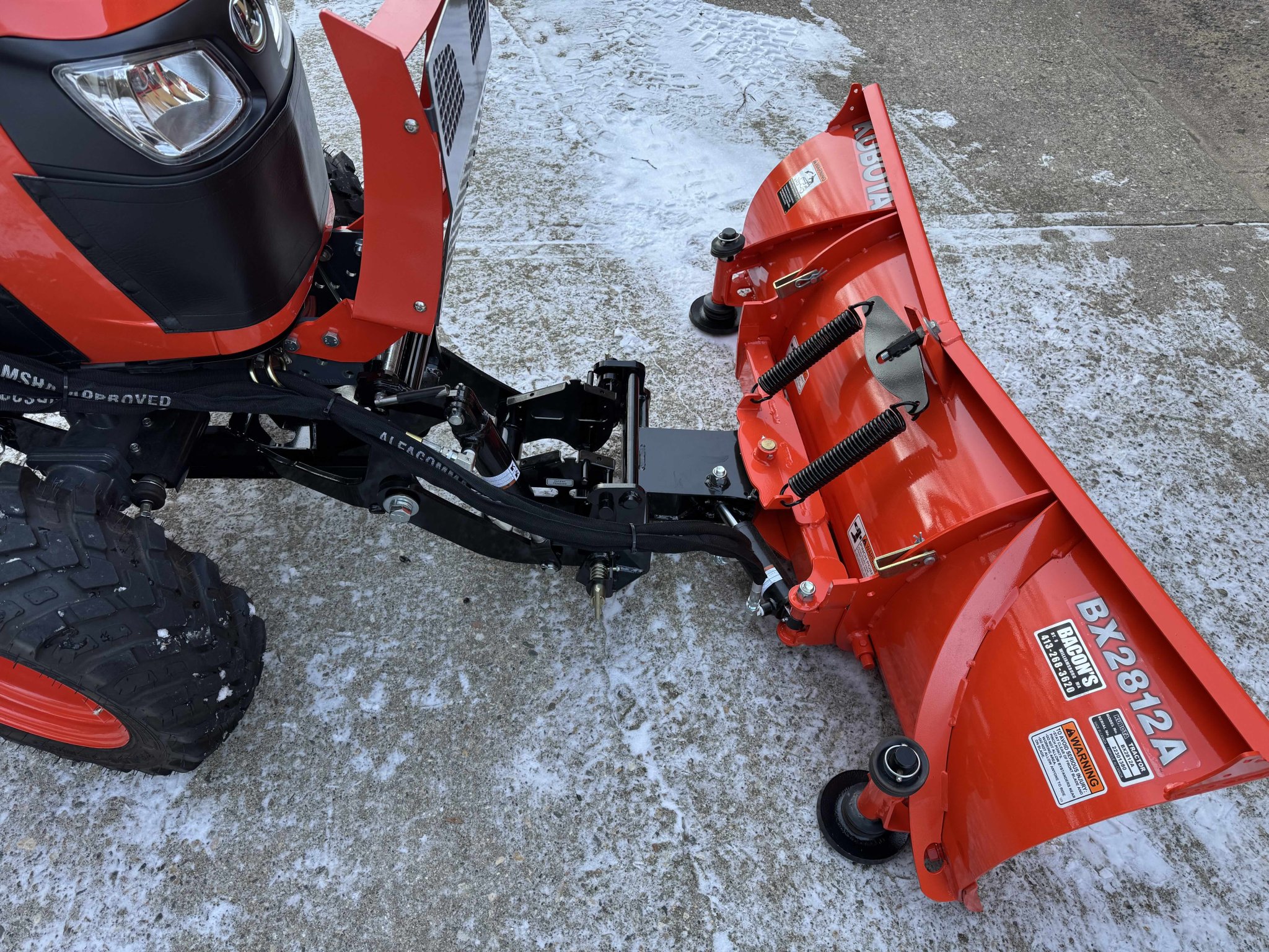

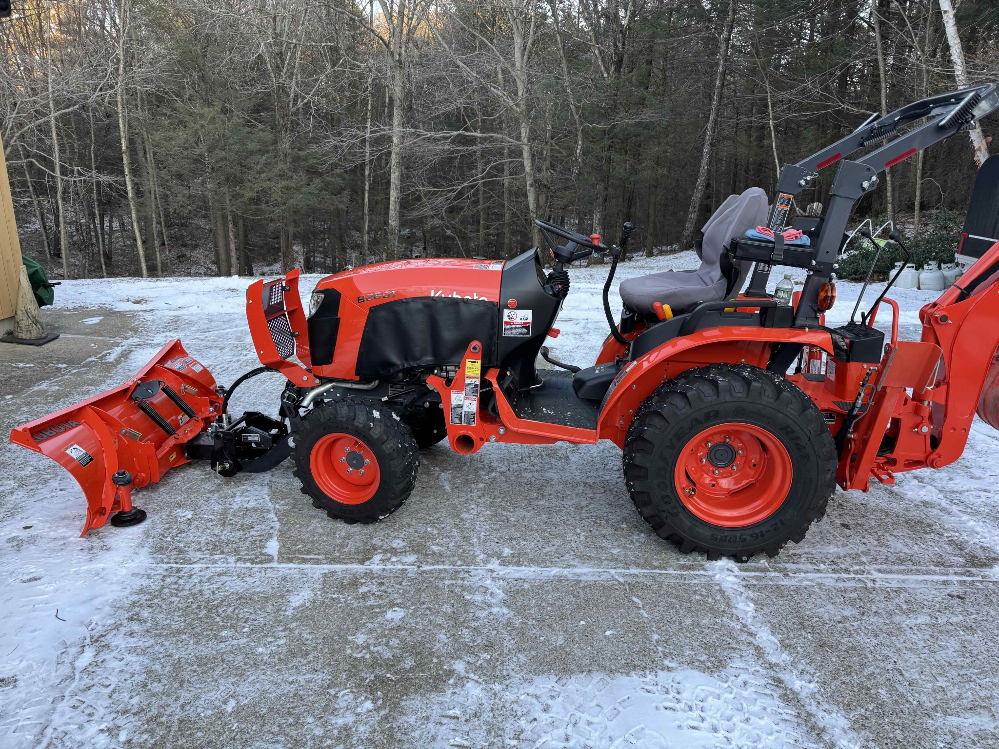

While exploring new snow removal options I finally settled on a snowplow setup for my '22 B2601 TLB. I contacted my dealer early Dec '24 and was able to acquire a BX2812A blade, B3410 K-Connect setup & BX2825 skid shoes for the blade, picked up early Jan '25. Install went very well and the setup was used for the first time yesterday for 6" of fresh cold powder. The setup works better than expected; I elected to keep the BH on for the most weight available.

curious, what are the silver U-shaped 'clips' on the uprights on the blade for ?

Those clip-looking devices are apparently used to prevent the blade from tripping when pushing denser material, like dirt.

OK, I looked and looked and THEN the lightbulb came on.....
They're in the unused spot now... you move them to the hole down below, and they 'connect' the blade to the A frame !!!! Clever bit of kit !
I learned something today, thanks !!
