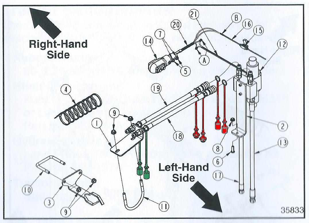

If it is the "factory" deal, it is a diverter valve with a single button built in the joystick handle. With my BX1880, I got the the Land Pride SGC0548 Grapple that included the 380-137A BX Third Function Valve Kit.
The original joystick handle was replaced with a two button handle. All installed by the dealer when the tractor was purchased.
With the L&P third function valve mounts on the tractor. Two extra hoses are connected to the FEL.
With the factory diverter, there are no extra hoses going to the FEL, just wires and the valve is mounted on the FEL.

Thank you For the reply’s. I spoke to the dealer this afternoon. He did indeed quote a “true” 3rd function valve.
Could you please ask him for the part number, because I just went through the same discussion with my local dealer, and he said that the Kubota unit was a diverter type, and that the Land pride unit is a true 3rd function valve. Here are the instructions from the Land Pride website. https://www.landpride.com/ari/attach/lp/public/manuals/380-304m.pdf

Kubota owns Land Pride, and it is a wholly owned by Kubota, but to say that they are a subsidiary of Kubota isn't necessarily correct. You said in your original post that you were purchasing a Kubota product, and I asked for the part number of the Kubota product. No mater how you want to twist this, if you are buying a Land Pride product, that is not a Kubota product. Land Pride is separate from Kubota. I had already told you about the Land Pride unit, and the difference between the two units. Calling an apple a pear, doesn't change the fact that they are two distinctly different fruits or entities, when discussing Land Pride and Kubota in the same breath.
