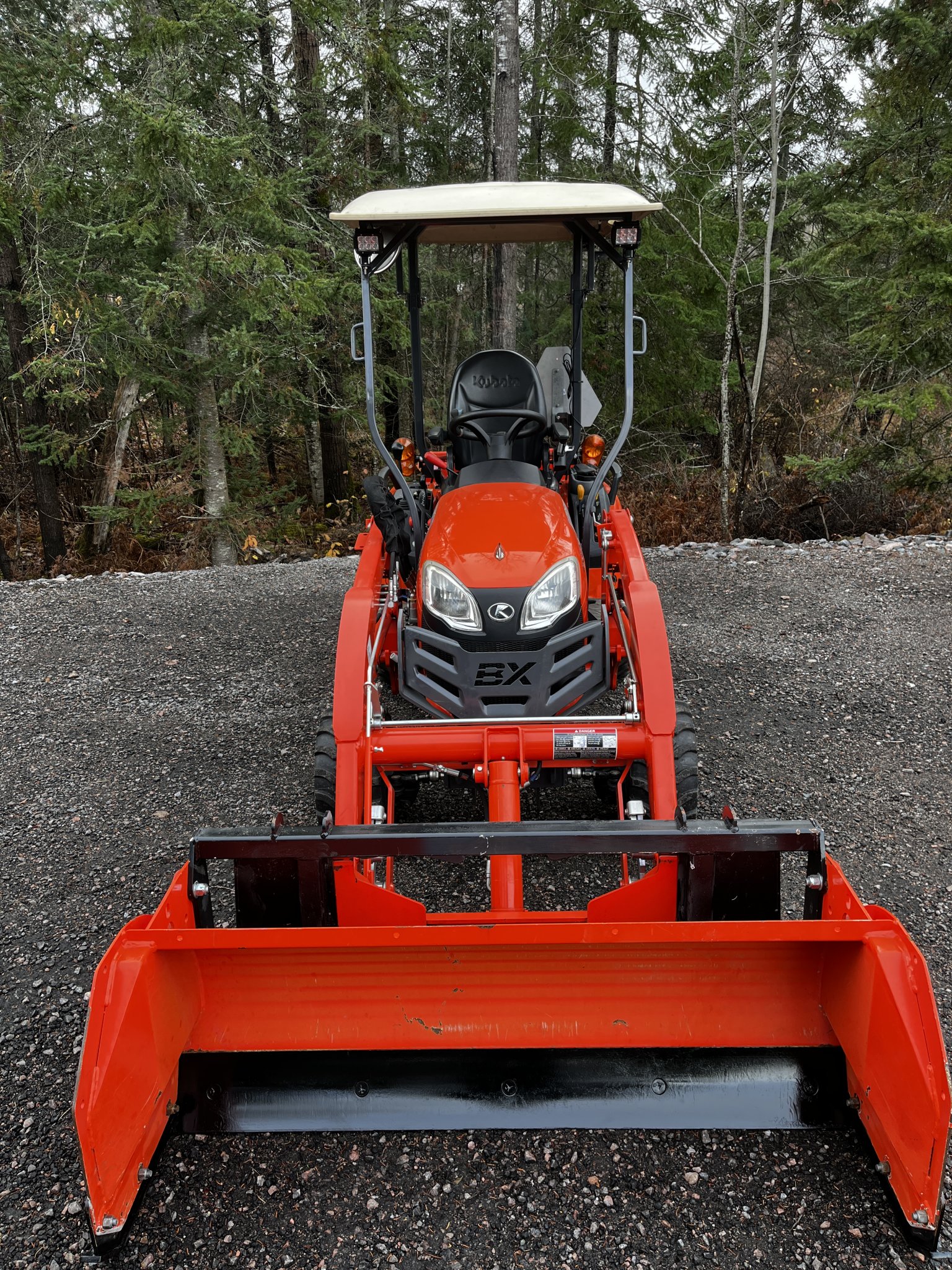

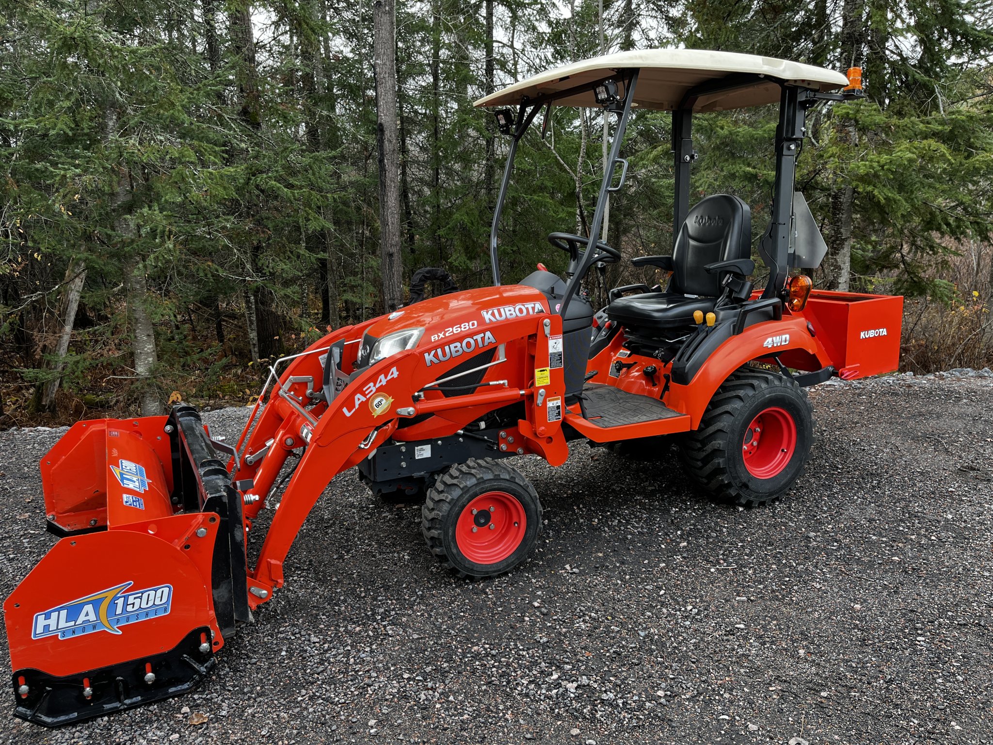

Hi everyone, just thought I'd show off the custom cab canopy and works lights I had built for my BX2680.
LED Lights, Beacon Light, grab handles, and plexiglas rear window to keep the wind out. Look out Snow !!

That's nice! Did you fab the front supports from scratch, or modify something to fit? Where & how does it attach?

Can you tell us about the snow pusher? I went to their website, and I like what I saw, but there was no information about snow pushers for compact tractors.

As someone mentioned, its an HLA 1500 54" Snow pusher. It's quick attach, and you can purchase a back drag option, if you move snow near buildings. As I have a gravel driveway no need for backdrag.
Also yes going to look into some Plasti-Dip paint and paint the top orange. But I am digging the beige it gives it a nice contrast.
The cab is fully removable, all Electical connections are quick disconnect, and the cab is mounted on existing Kubota hardware mounts, with rubber pads under not to scratch the original finish.
I may remove it in the summer when mowing, but I'd rather trim the few branches that might catch, versus being exposed to the sun.
Thanks for the compliments, very happy with my machine.

I like it but I am another vote for painting it orange. Maybe black if your looking to keep contrast. The way it is it looks like a golf cart canopy. Still looks clean though.

I was totally sold to paint it when I first bought the canopy used, as it was filthy and was used. I was going to paint it with PlastiDip Orange, or black, but once I cleaned the canopy the beige is growing on me. Might just keep it.
