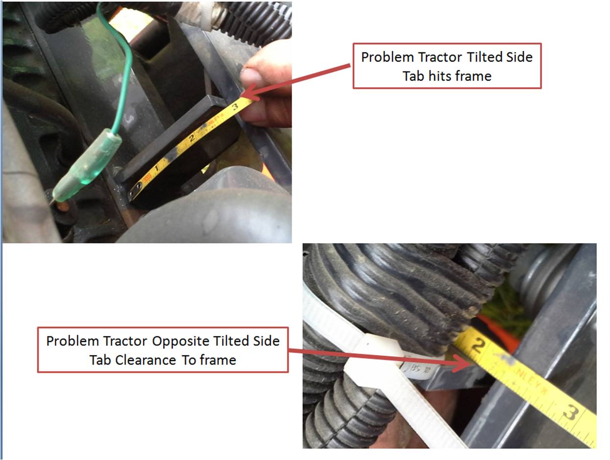

Bought a new BX2670 a couple months ago and love it. Got a fel, mmm and a 50" rev tine tiller but is primarily used for mowing 3 acres of mostly flat ground. But since new I have had a knocking/vibration sensation that could be felt throughout the tractor. Very noticeable. The times I feel it are when traversing alongside a hillside and making abrupt quick turns. The hillside is probably less than 15 degrees. I finally tracked down the spot that is causing the vibration/knocking issue. The bracket that bolts to the motor to the rubber mounts has a 1/4" tab welded to it and it sits perpendicular to the frame with about an 1/8" gap between the tab and frame. Its the same on both sides of motor. Well I've found that when I get on an angle or turn abruptly the motor shifts and that tab vibrates on the frame. No harm yet but very frustrating. I took to dealer to look at but didn't find anything obvious and have not heard any others doing this. They are waiting to hear back from the Kubota Techs. Sorry for the long story but curious if anyone else has heard of this before? From what I've gathered on the the web is that the older 26hp bx's would occasionally break the rubber motor mounts. So Kubota updated the mount by welding on these tabs keeping the motor harnessed better between the frame to prevent excessive motor movement breaking the mounts. So I get why they are there but hope its not something I have to live with on a $15,000 machine. Any help would be appreciated.

Corporate kubota finally got back with my dealer and issued a bulletin. Supposiably, there fix is too cut upto a 1/4" off each bracket for clearance on bx tractors with this issue. Kinda seems like a cheap fix, but then again the older bx's didn't even have that metal tab sticking off the motor mounts. So get with your dealer. I've got some pretty heavy rubber bolted in there now, but when it where's out I'll be cutting on mine. The right bracket is the only one that hits on mine but will trim equally on both sides.

I have had the same problem since August. No response from Kubota representative that came out. A couple of things. The problem with older models was more severe where the fan could hit the radiator or cowl. So trimming up the tabs is dangerous since that is why they are there.
I just compared my tractor with another one from the dealer. On a side of a hill my tab hits the frame. The other tractor motor stays centered in the frame. Guess at this time is weak rubber mounts. We'll see if Kubota responds.
Doesn't appear Kubota does not want to resolve the issue with the tractors.
