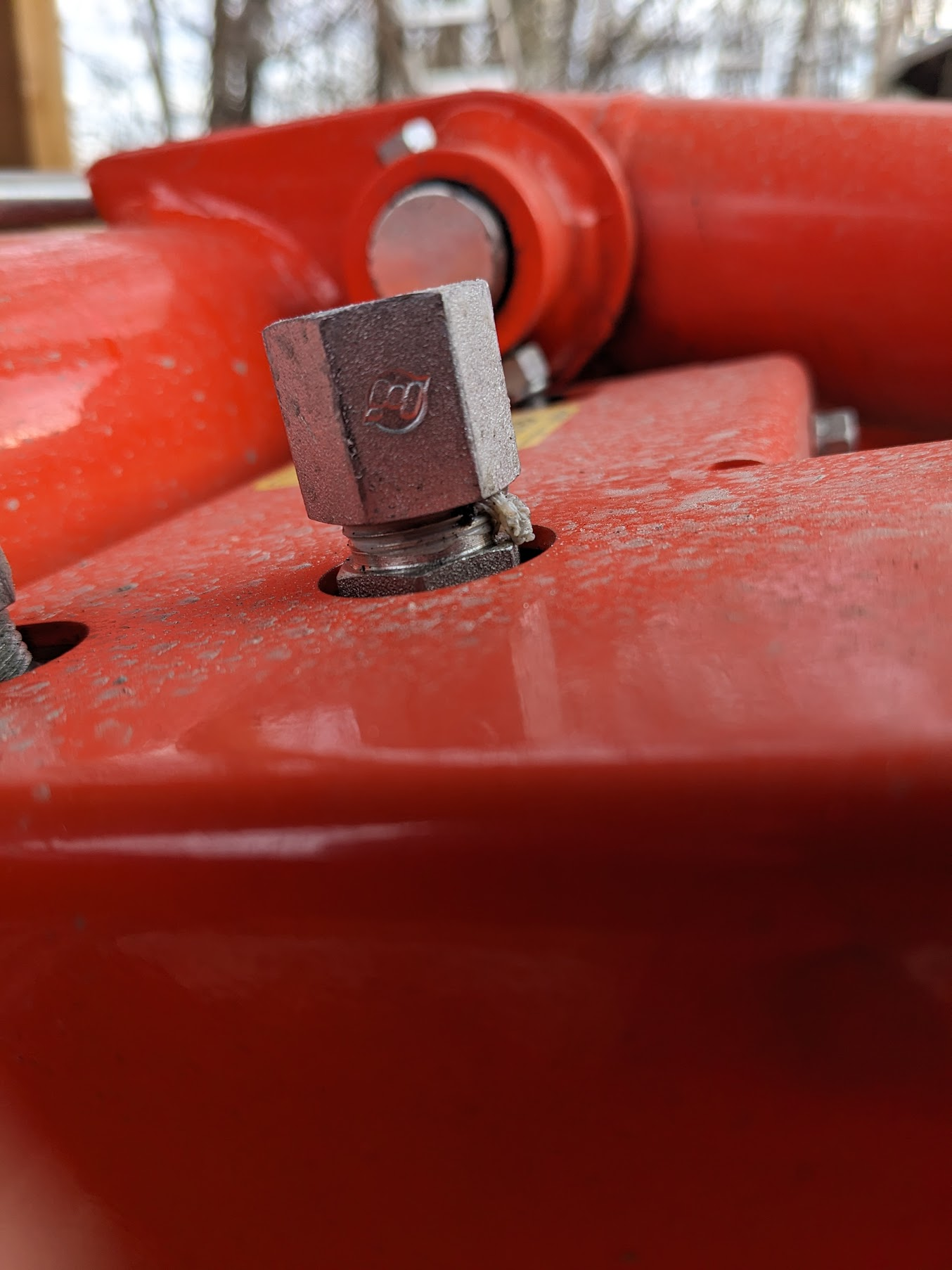

So I had a BX2412 third function installed on my BX by my dealer. They apparently did not know what coupler to put on it because they didn't know what my snow plow had on it, an neither did I. Now I need to buy the couplers myself, but I'm not sure what size.
On the plow: the bxpanded plow comes with "Hose ends terminate with ¼” male NPT swivel fitting to allow you to connect as desired. A tube of Loctite liquid thread sealant is included for this connection as it is safer than tape for your hydraulic system."
On the third function: whatever comes on the BX2412
Please, any help would be very appreciated!!!!

If there are no couplers on either side use whatever you want. Kubota would normally use 1/4" flat face couplers
