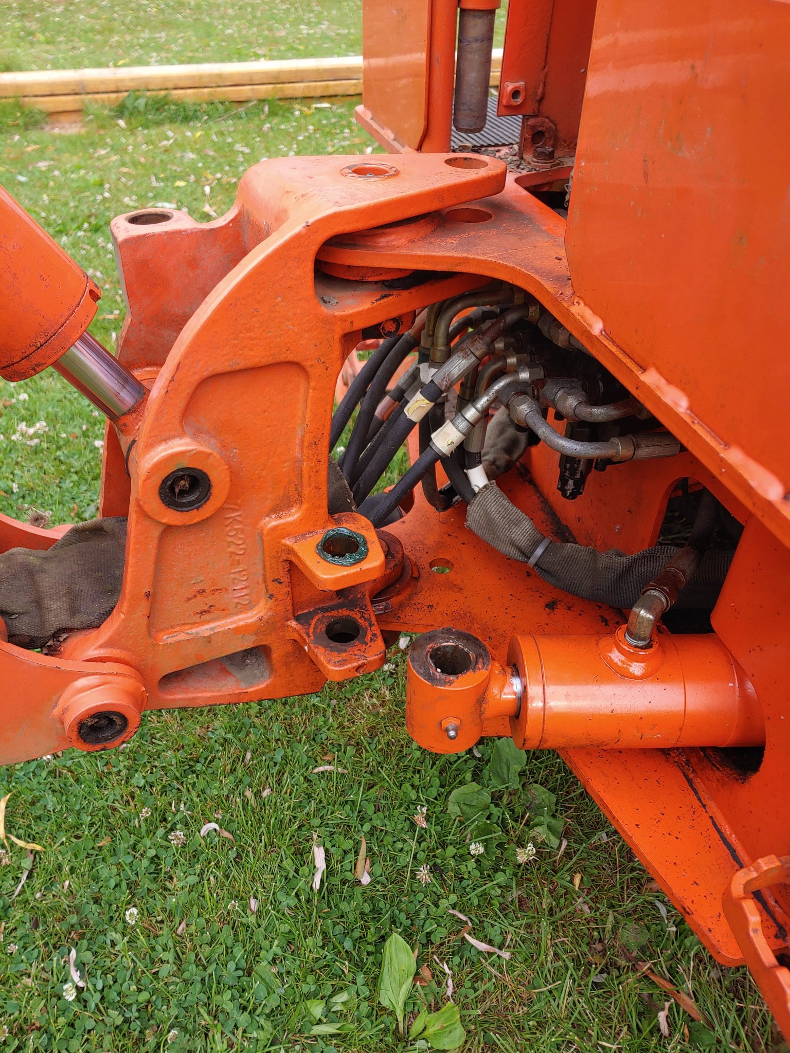

My hoe will not swing left and i have check both swing check valves. I removed the swing cylinder pin that attaches to the swing frame and I can watch the cylinder operate in both directions. I tried to manually push the hoe left and right, but can't. I even tried to use a large tree as a fulcrum and still cant get it to move. Its like the swing are bushings are froze up. I did notice the bottom swing bushing locking bolt sheared off . i had to drill it out. My question is, should I be able to manually swing the how left or right with the cylinder attached? Help!!!

You should be able to swing the hoe by hand with the tractor not running by actuating the valve while pushing on the hoe. I can do that on my BX24. It does sound like you have a seized pivot pin.

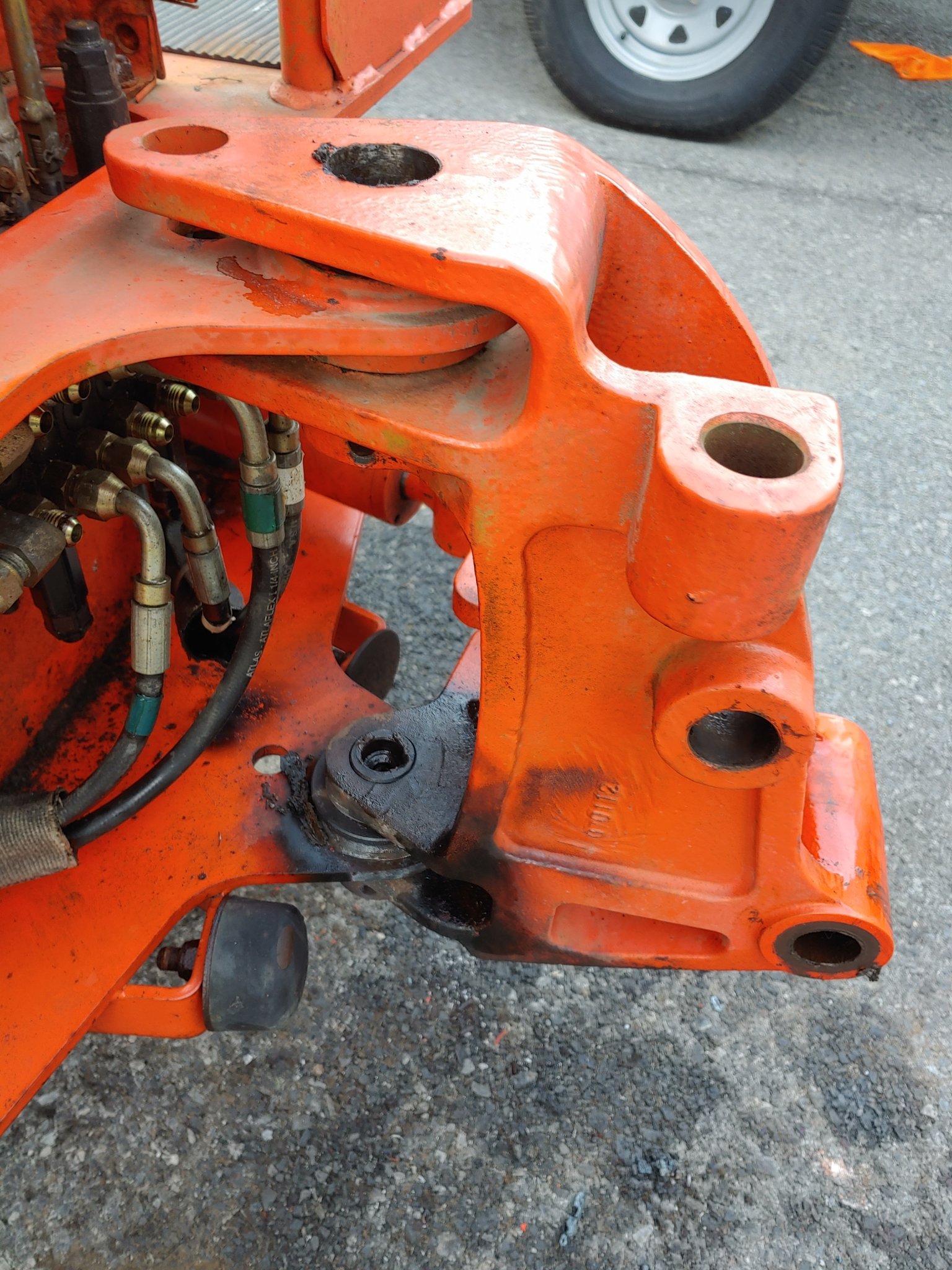

So tue bottom pin is welded in place. I removed the hoe extend arm and then the attachement. I tried pilot drilling the pin, put a torch to it too heat it up and the pin still wont budge.

Is there room to get a saw blade between the frame and pivot casting to cut the pin? I had a pin seized in one of my outriggers and I had to cut the pin with a sawzall to get the outrigger off to drill the pin out on a drill press.

I drilled a 1/2 hole down the center of the pin and all the way through. I thougjt the same thing with using a metal blade and a sawzall. I dont have a large enough drill bit to finish drilling out to accommodate the blade. So I am ordering one. I think if I cut it in two places, it should release and fall out.

Took it to the machine shop, they used a torch to cut a relief and pounded it out. Funny thing is , there wasnt any sign other no grease. They told me it was friction welded.
