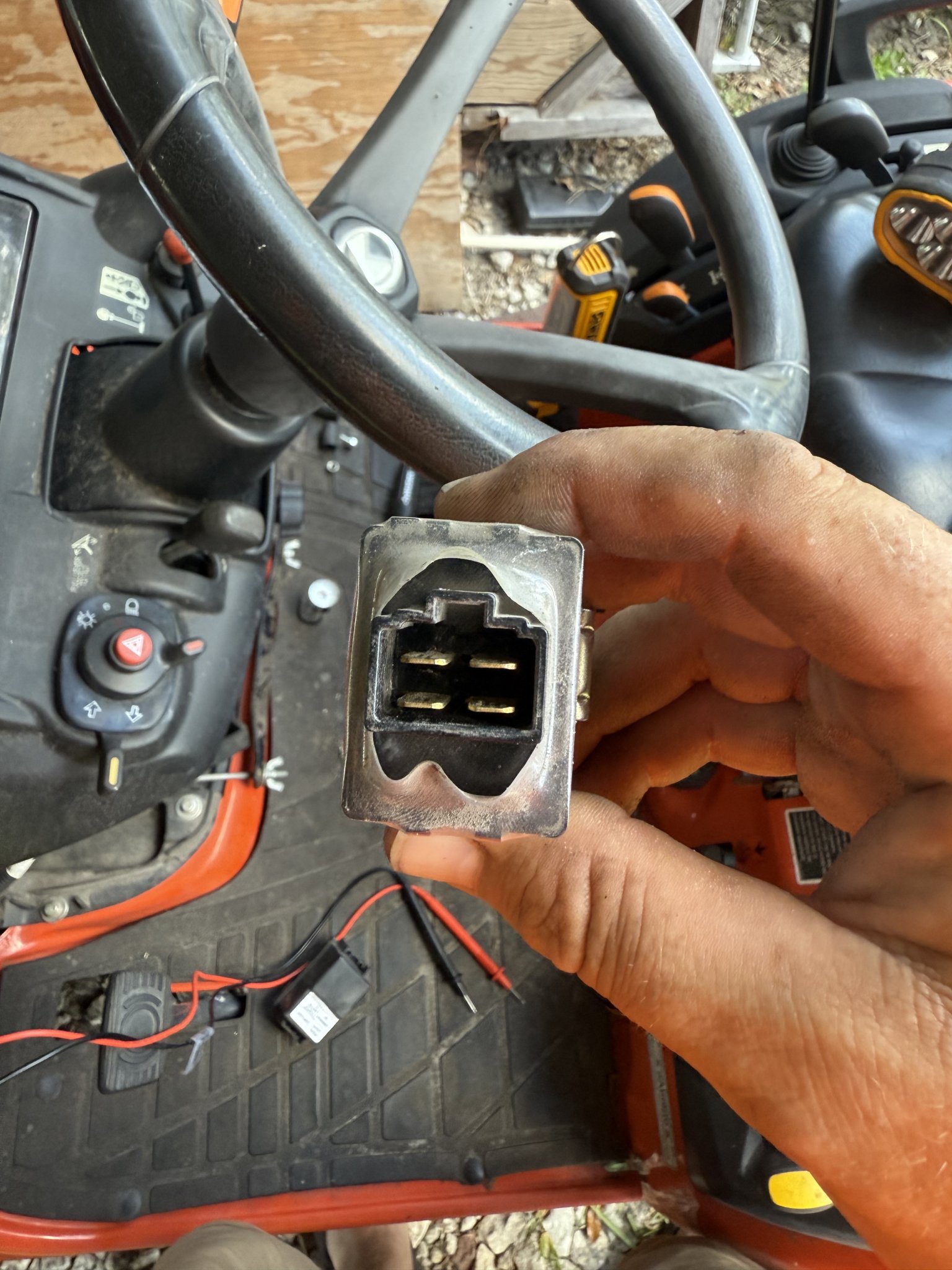

I unhooked the small b/w wire going to the starter solenoid, metered it to the chassis and had constant 12.8v.

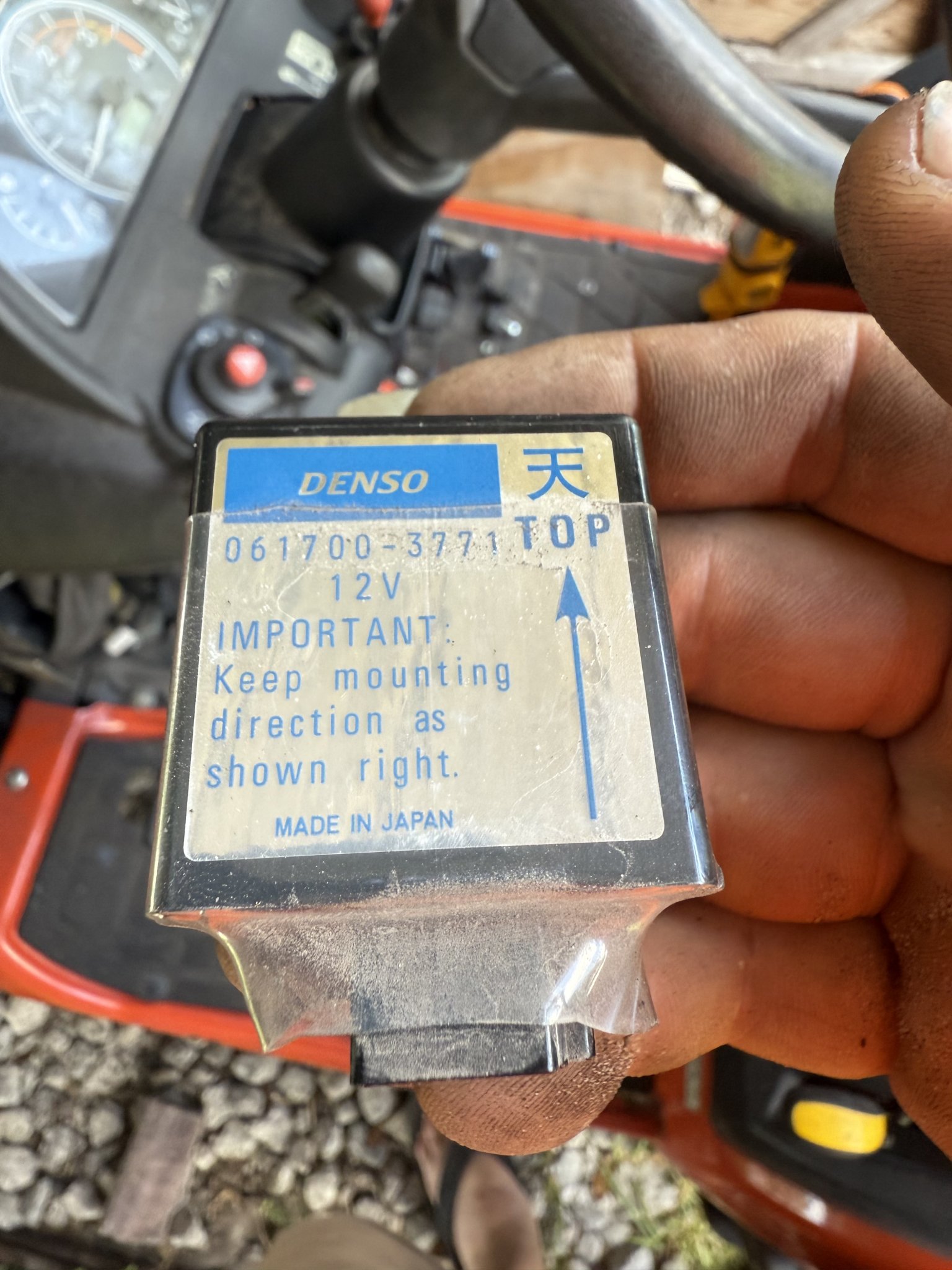

I followed that solenoid wire up to a 7 pin and a 4 pin relay. Unplugged them both and still had 12.8v to the starter solenoid.
No key, no switch, no 7 pin, no 4 pin and the tractor would still crank on its own.

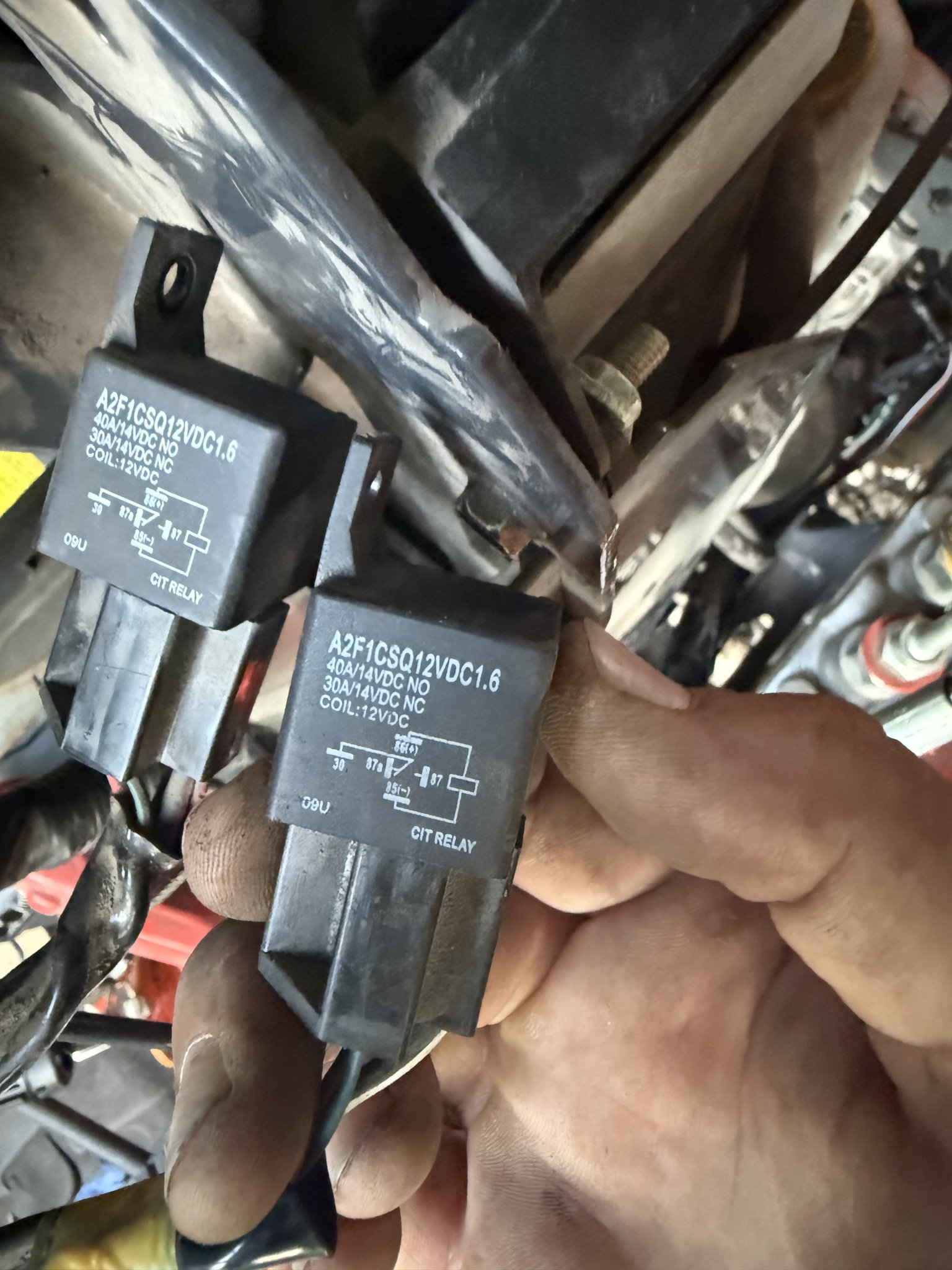

I picked up a thermal scope for hunting hogs at night (God bless Florida) and I thought maybe it would help me find a hot spot. Well it did . I followed the b/w wire from the starter up to the disconnected 7 pin and 4 pin relay and past them up under the dash (now removed) and there are 2, 5pin relays and one is warmer (in the scope) than the other. Ordered 2 on amazon ($7 each)and problem solved. Now for the chore of wrapping all that wire and loom back up so I can till my garden.
