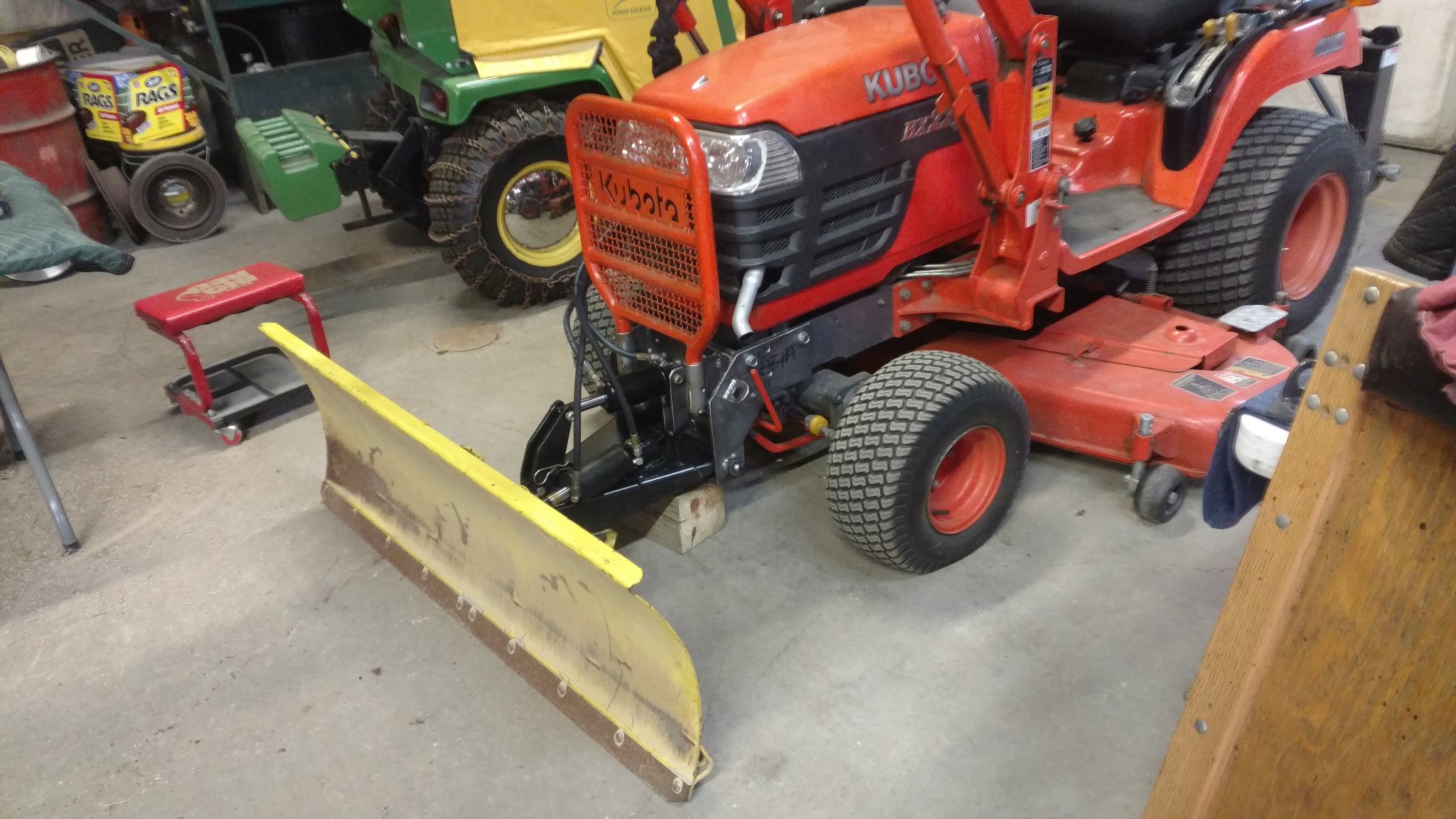

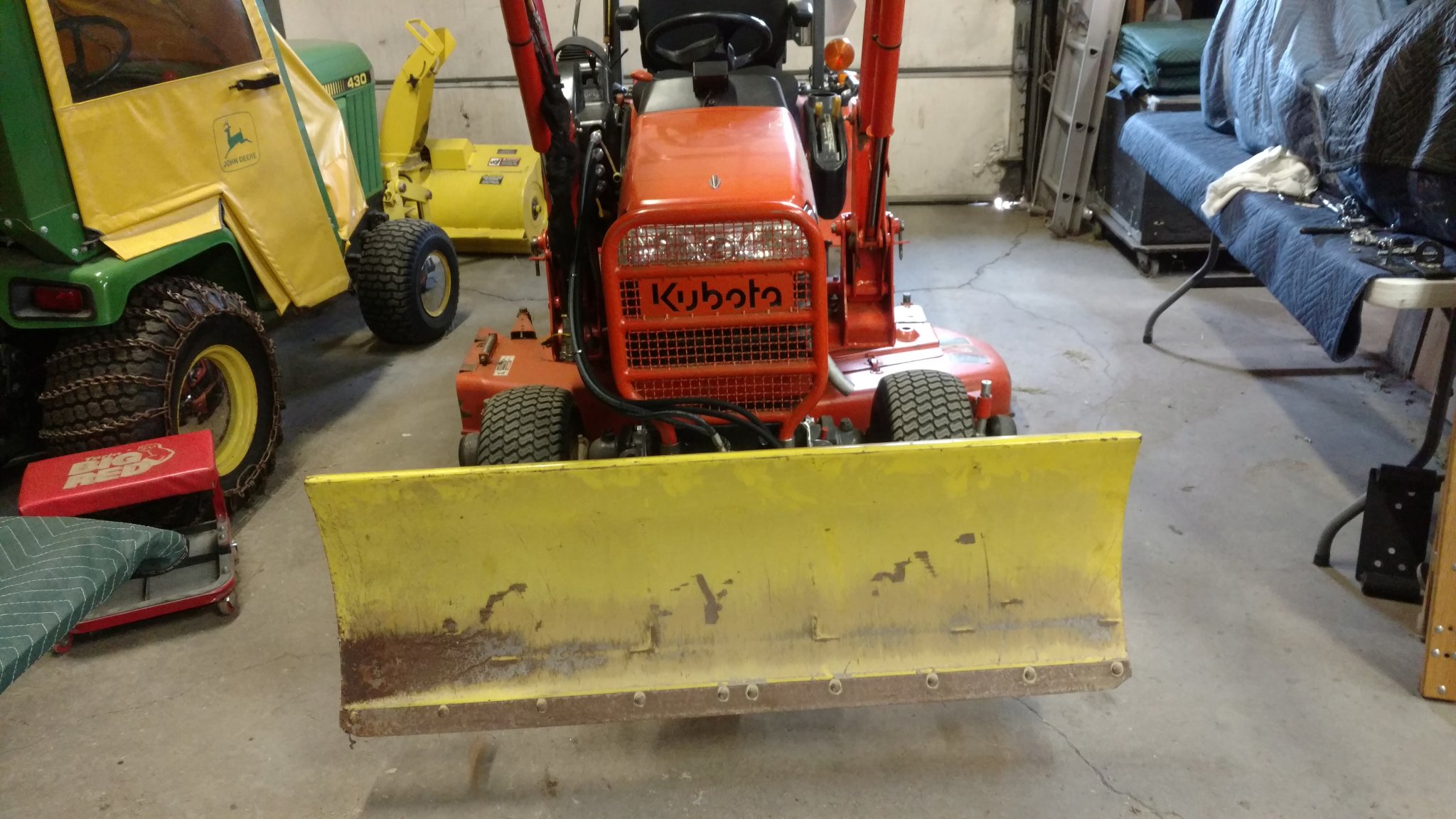

It's not a bolt-on, but I adapted a JD 54" hydraulic blade off my JD430 to my BX with a mount bolted to the front of the frame. Can keep the MMM on, and it used the FEL hydraulics.

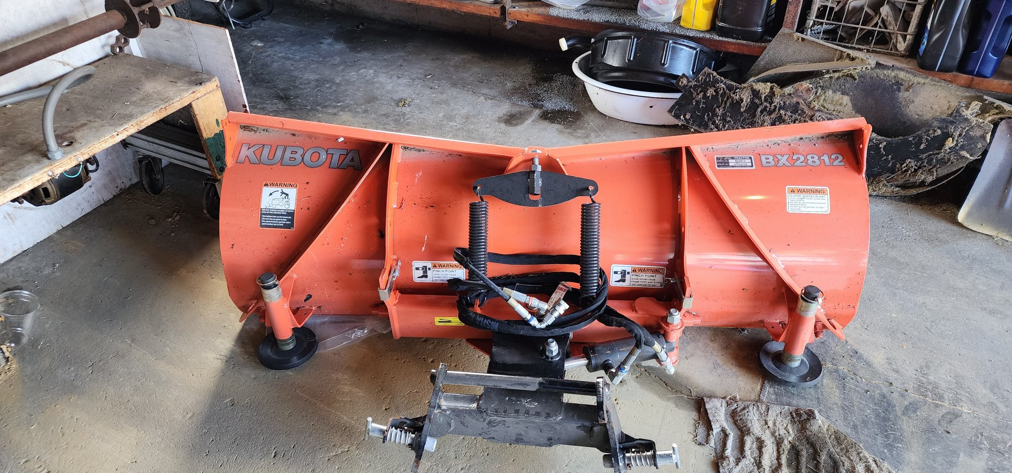

That looks like what I’m looking for-do you know where I could get one?
My Kubota dealer threw it in for free when I bought the 60" mower deck.
Haven't used the blade yet. Probably won't either.
