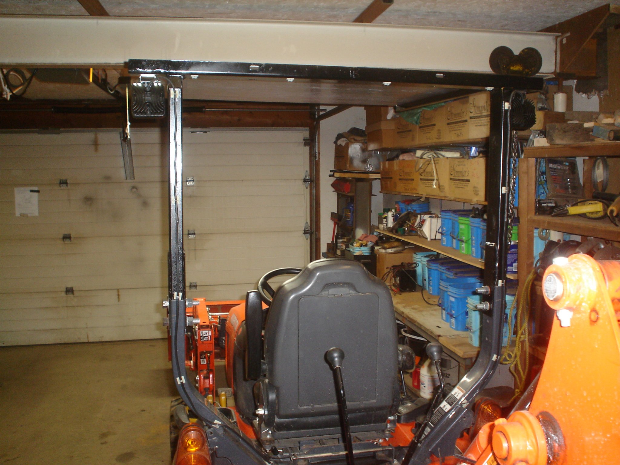

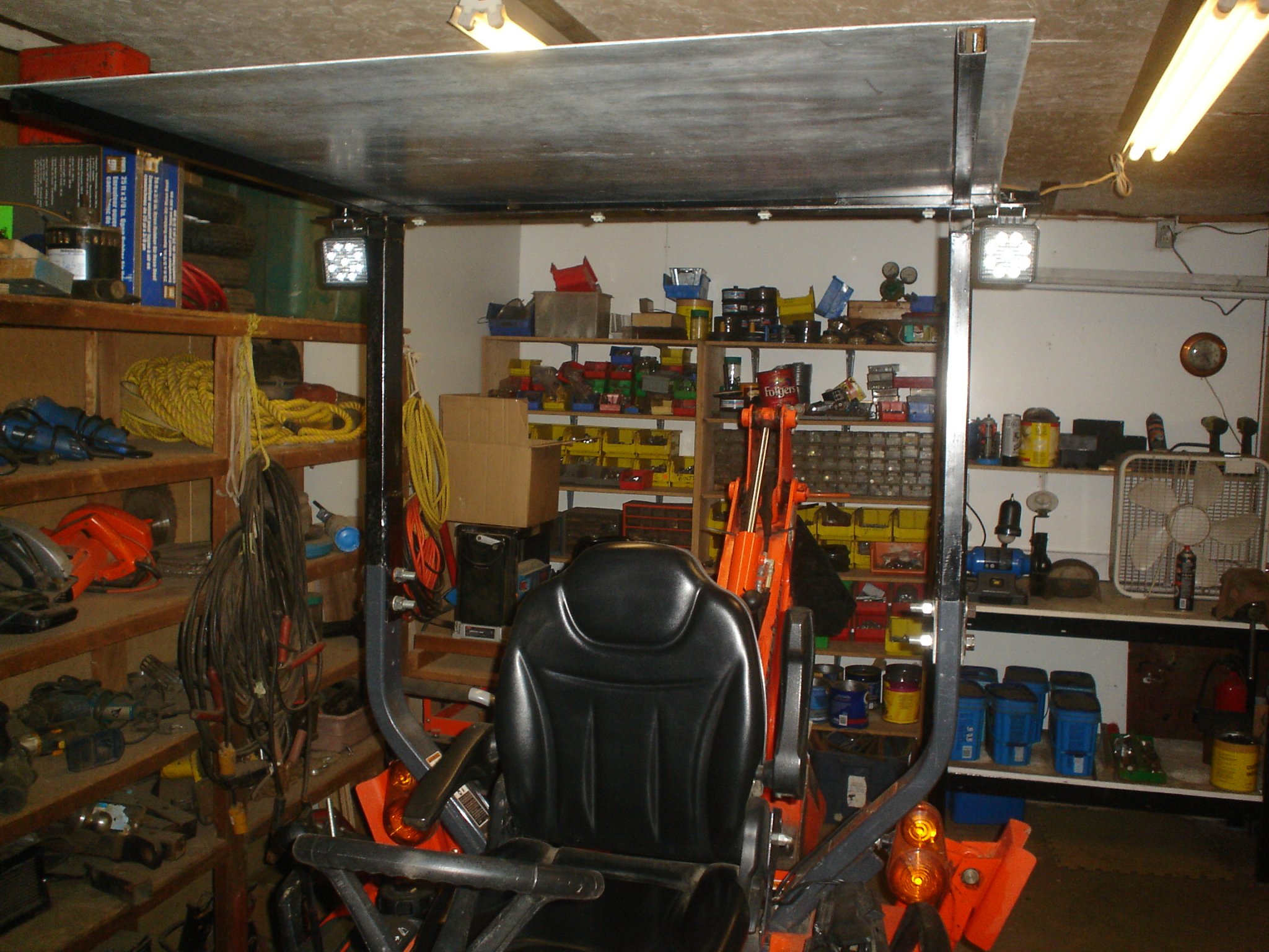

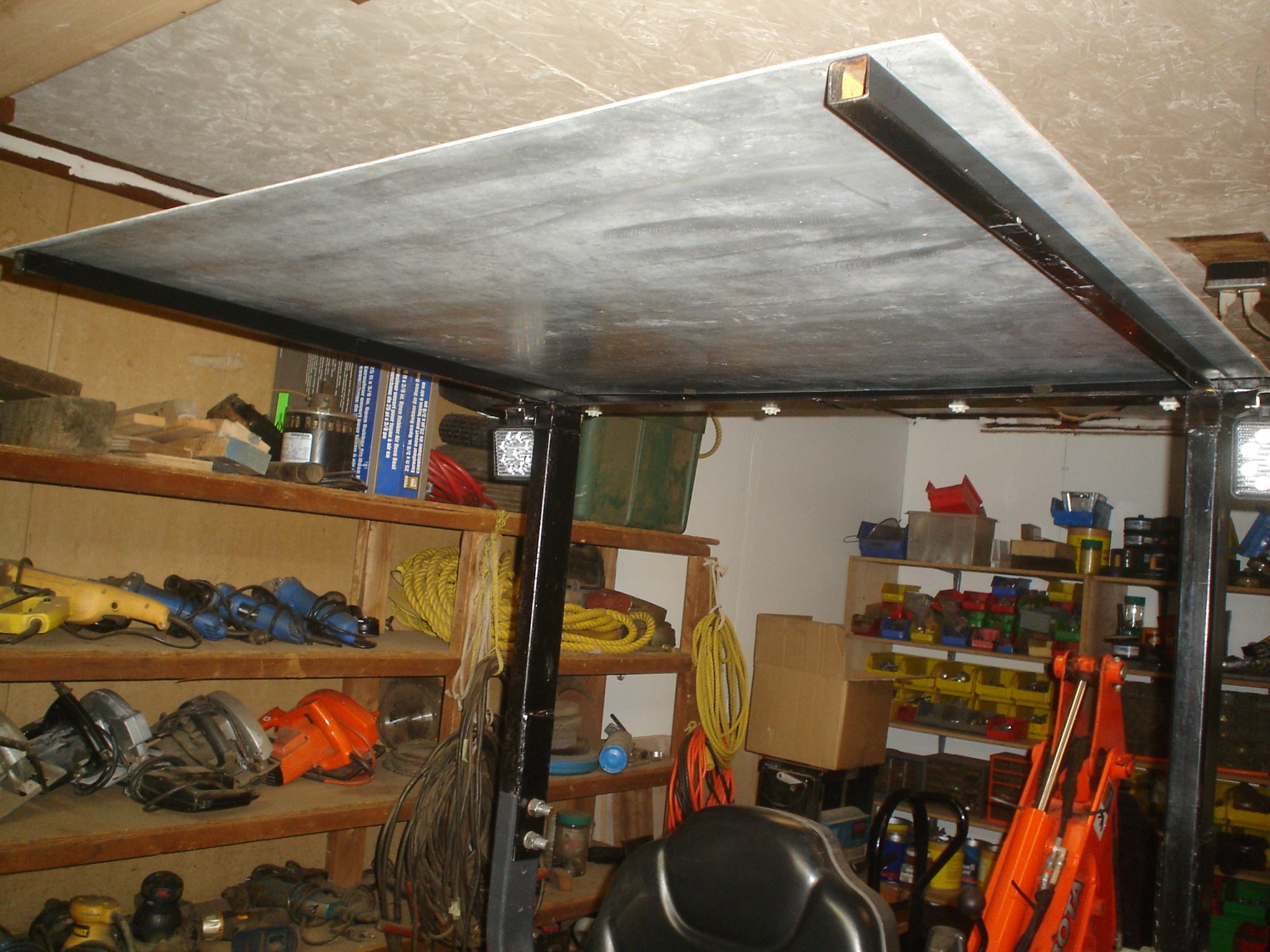

Finally got around to fabbing up a shorter ROPS so I can get into my garage without the pain of moving the ROPS. I wanted something 'fixed' so it's a compromise. Sorry for the pictures, rain here all day, will post better ones once Mr. Sun returns. It clears the door by 3/4". Neighbour donated the aluminum top, the steel is leftovers. Added the LED lights couple days ago and can FINALLY see and be SEEN. Used the power outlet for test purposes,so they're on when key in on. Will rewire them into a 4 chanl RF relay box. Like everything, it's a 'work in progress'. While it may not be 'pretty', it does keep the sun off while driving AND using the backhoe !!

However, I would not be comfortable with your modification without some kind of bracing at the top corners, at a 45 degree angle. It sure looks like it would fold if you ever had a serious need to use it. Hopefully you will never need to use the ROPS.

It looks like you fabricated a replacement for the top half of the ROPS.
It also looks like the transition between the vertical sides and the top cross piece uses pieces of relatively thin wall square tubing.
Personally I would never consider such a design as equal to the factory ROPS.
The Golf cart or other sun shades people use are usually attached to the factory ROPS, not replacements for the ROPS.
No doubt the top you made is stronger than many other things people use. But that is not my point. I think you decreased the safety factor of the ROPS significantly.

The vertical pieces are 1.5x3x 3/16 sections of steel tubing, same as the OEM. Fish plates (connectors to btm ROPS) are 2.5*x6x 3/16 plate steel. Horizontal cross member is a piece of 1.5 x 3 x 3/16. 'canopy ' supports are 1.25" x 1/8 steel tubing. The primary reason was to get a sunshade onto the tractor ,and get it into the garage. Having had heatstroke in 2014 , me and Mr. Sun don't like each other and no one up here is interested in building me a taller garage. Like life, the design is a compromise.
The whole idea of 'ROPS' is interesting,in that you can buy any ATV or 'quad' that doesn't legally require ROPS,yet a 24HP SCUT 'needs' it. Since 99.44% of my land is flat,the odds are pretty good I'll never roll my BX23s,and after 5 decades of experience, I've lerned a few things. Sadly I know of more who've died in ATV accidents than tractor accidents.
