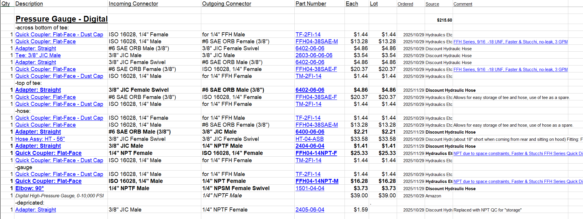

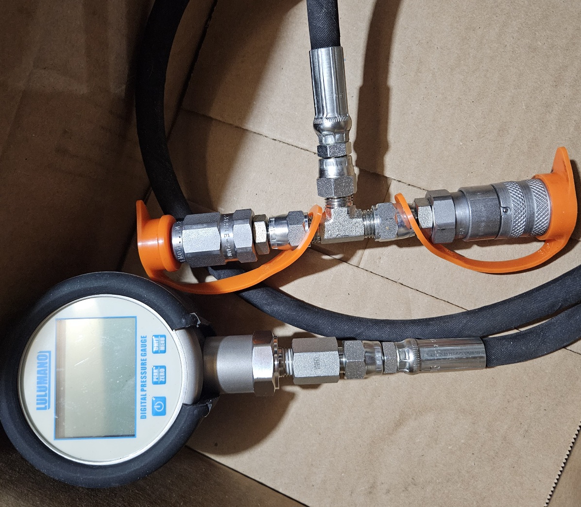

I looked into this and did not find such a kit. Respecting @TheOldHokie's opinion, I want to know how much strain I'm putting the hydraulics under since I tend to do crazy [unadvised] stuff.
I plumbed up a Flat-Face Tee with Male on one side, Female on the other (so it can move between any lines), and the third leg goes to a Flat-Face-hose-Flat-Face so the hose is optional and can be replaced w/any length hose (as long as you have one). With gauge they run about $250 each (I made two, one digital and oil-filled analog).
Is it worth it? Well, if it saves me from messing up the OEM valving by showing me I'm doing something really wrong, then yes.

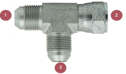

I recommend you ditch quick connects and install male JIC tees eith caps for your tedt points. Put a hose with a JIC female swivel on the gauge.

Here is my hydraulic test gauge. I actually have two to help in troubleshooting circuits.
Test points are locations to connect my gauge. Kubota uses JIC swivels for just about all hoses so installing these at strategic points makes it easy to hook the gauge up. If you leave them in the circuit the middle leg is capped when not un use. The tee abd a cap costs $7.
Put a test point on the pump and when a gauge us connected you can see pressure at EVERY cylinder and valve in the system from that one point. What you cant see is pressure in a cylinder when the valve is closed. For that you need a test point on the cylinder..

You've got a few couplers coming off that gauge... 😬
I'm guessing you have:
Gauge: NPT(male)
Coupler: NPT(female) to NPT(female)
Adapter: NPT(m) to JIC(f swivel)
Coupler: JIC(m) to JIC(m)
JIC(f swivel) hose end
I went:
Gauge: NPT(m)
Adapter: NPT(f) to JIC(m)

That gauge has no COUPLERS and connects to test points via inexpensive JIC fittings. Thats my point.
How its assembled is of no significance but it has a NPT female to JIC female swivel adapter. Then a JIC male union to the JIC female swivel on the hose. I would have prefered NPT to JIC male adapter on the gauge to eliminate the union but had to make do with what I had on hand when I made it up.
