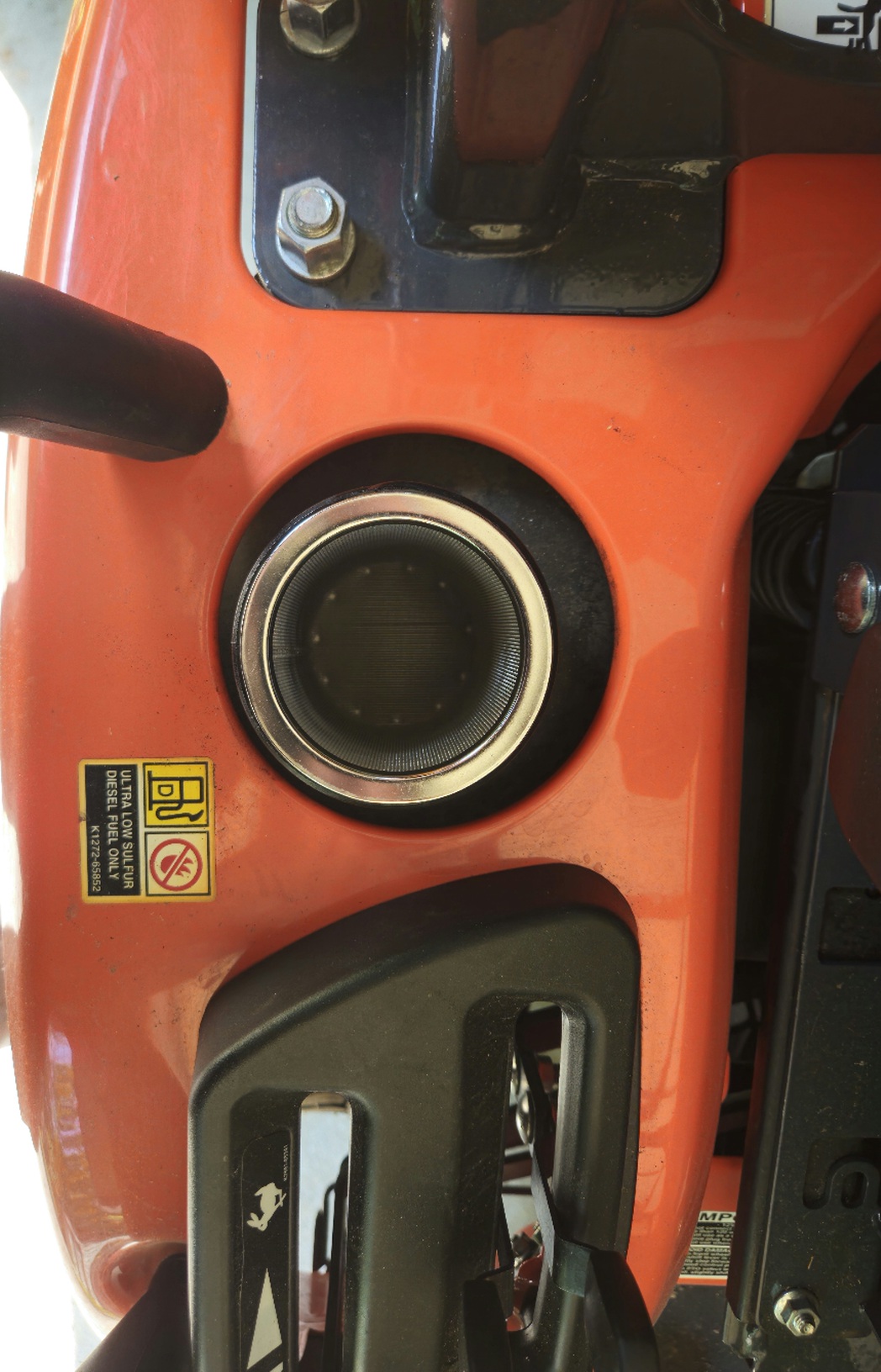

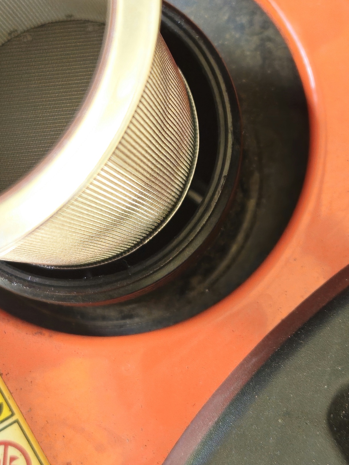

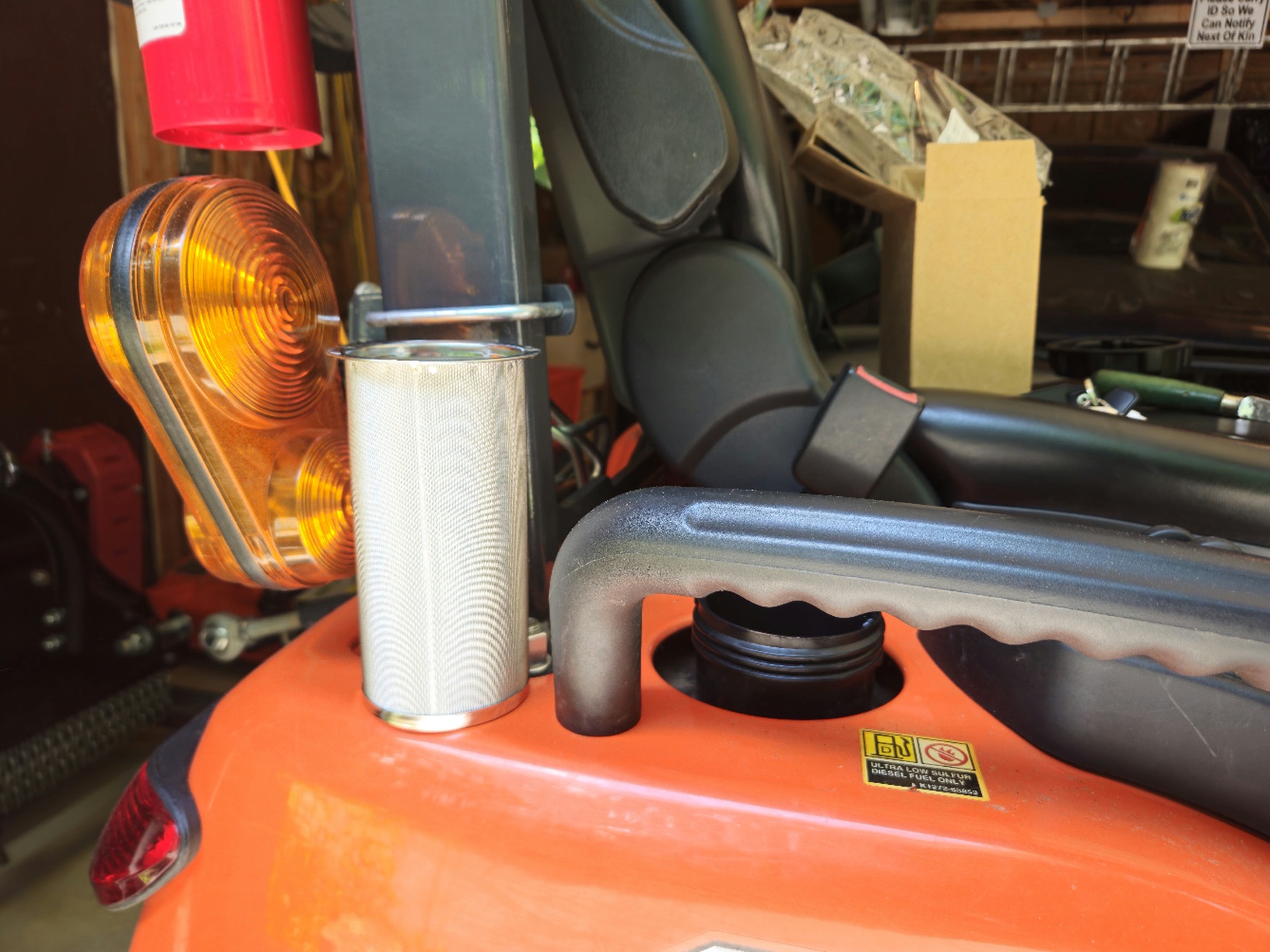

I bought a 'mason jar coffee filter from TEMU for $14 (?) 2 years ago..... fits perfectly, about 7" tall, very fine screen..amazing what it traps !
this one is similar...https://www.temu.com/ca/304-stainless-steel-cold-brew-coffee-filter-cone-with-white-rubber-seal-reusable-leakproof-mesh-infuser-for-iced-coffee-tea-boba--fruit-drinks-acid-resistant-portable-easy--filter-reusable-g-601100644391856.html?_oak_mp_inf=ELC3iLOq1ogBGiBjZjczOTMzZWYyMzE0Mzg5OTRkNWY0NWE0MGI2ODIyNCCB8aXvgjM%3D&top_gallery_url=https%3A%2F%2Fimg.kwcdn.com%2Fproduct%2Fopen%2F58717dd6ef204fa5af1e0f6e9346192e-goods.jpeg&spec_gallery_id=6857415247&refer_page_sn=10009&refer_source=0&freesia_scene=2&_oak_freesia_scene=2&_oak_rec_ext_1=MTE5Mw&_oak_gallery_order=2070065933%2C232198473%2C1217984950%2C666733079%2C173999601&search_key=mason%20jay%20filter&refer_page_el_sn=200049&_x_sessn_id=09u5nwez03&refer_page_name=search_result&refer_page_id=10009_1753116935570_c5ldmw7tsb
..though mine was NOT tapered.

Thanks for the suggestions of the coffee filter for mason jars. Awesome idea. I just ordered mine from Temu.

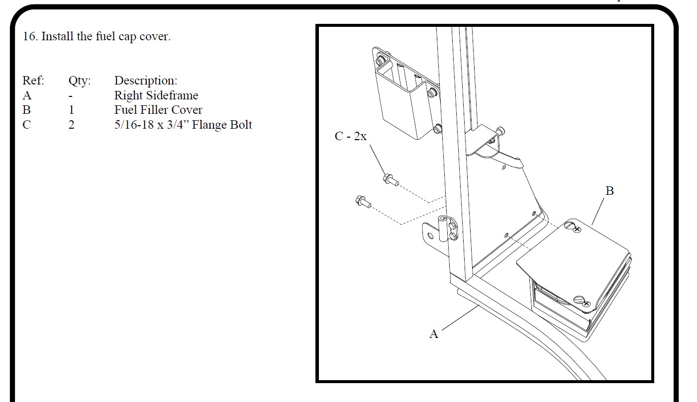

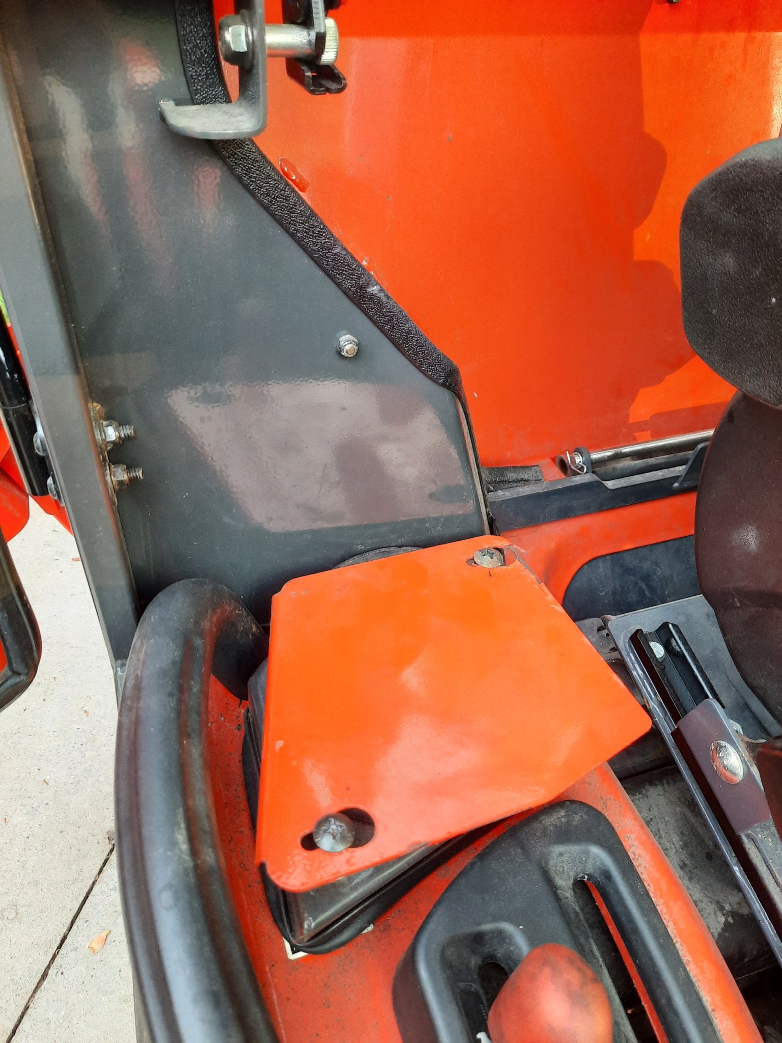

My tractor had a Curtis cab on it when I bought it and as part of the kit, there was a hard fuel filler cover around the fuel cap that would've been very easy to modify with a padlock or something. You'd have to fashion up a mount since you don't have a cab, but if you could order a replacement part through your dealer, or directly through Curtis, it might be a solution. I don't know if the cab for the BX23S looks similar to my BX25D, but I doubt they reinvented too much if they didn't have to.
Here's the part in the instruction manual showing the part (B):
And here's the part mounted in real life:
Edit: Holy crap, I forgot how dirty this tractor was inside the cab when I bought it...

Cause 'Merica! If you've got a 9mm on your hip and do something stupid, that plate was really stout and could stop the average round from messing up your tank.
I really have no idea, haha, but it was one of the most heavy duty parts on the whole cab. I'm guessing it has to do with some emissions compliance mandate somewhere.

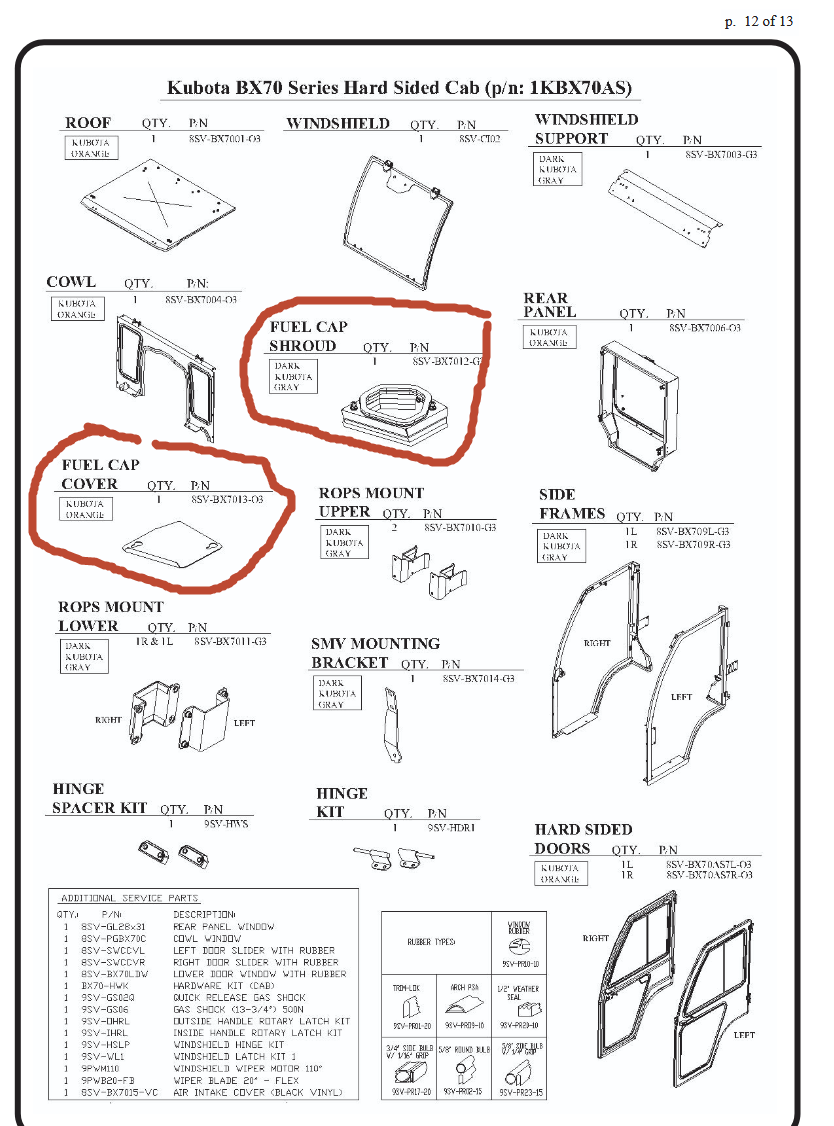

I contacted Curtis Cabs and they sent me the parts list for the fuel cap cover and shroud.
I also asked him what the intended purpose is (as asked by GreensvilleJay) - and the tech support said it's to "keep the gas fumes out of the cab".

That's for the 70 series tractors like mine. Since yours is an 80 series (BX2380, BX2680, BX23S, etc), find out what parts they use for your tractor. I don't know how the fuel filler changed for the newer tractors or if the 70-series parts will work for yours. I can't find pictures or the installation manual for the 80-series to compare.

Would appreciate if someone with a BX can confirm what coffee filter works.
