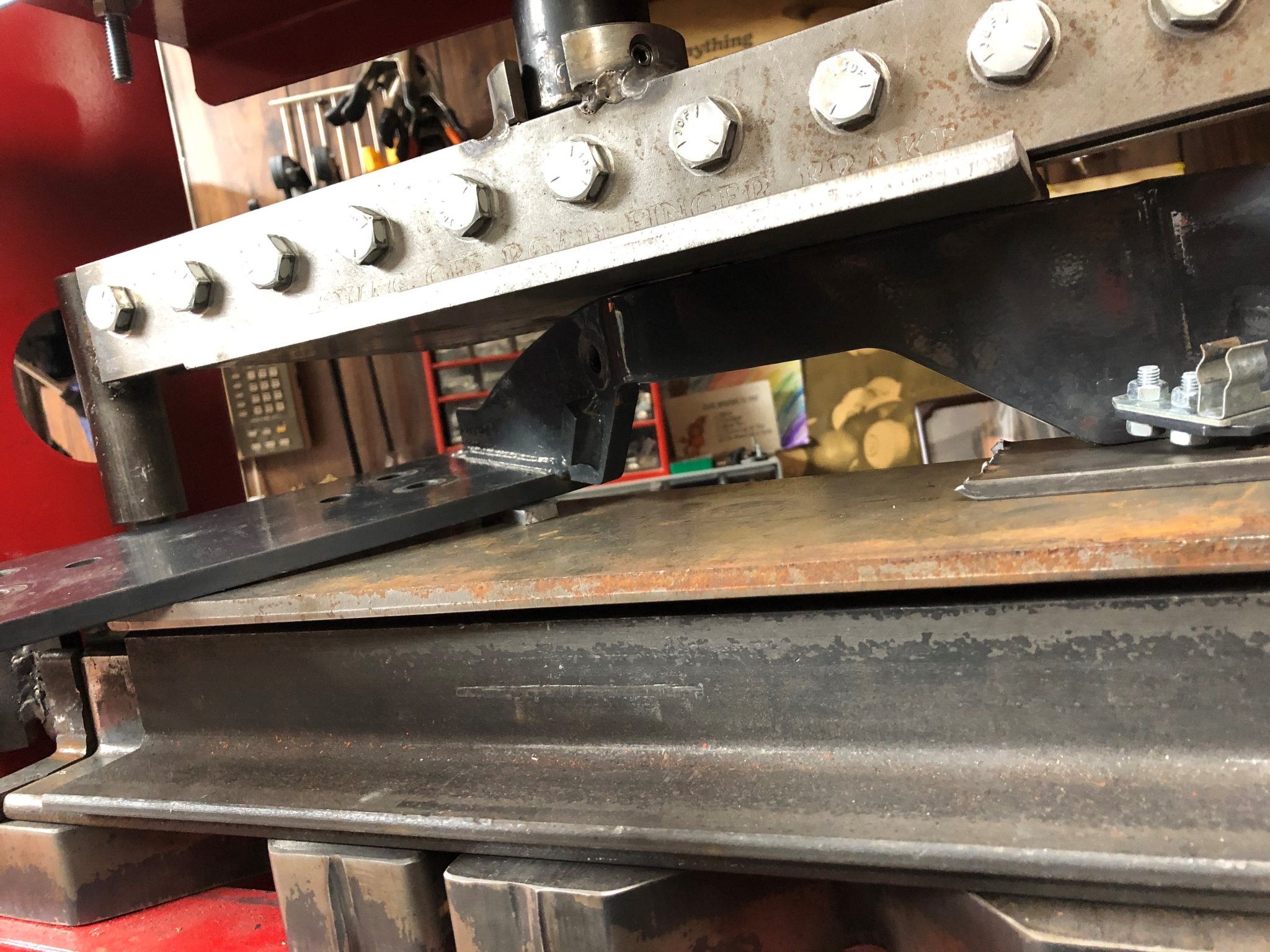

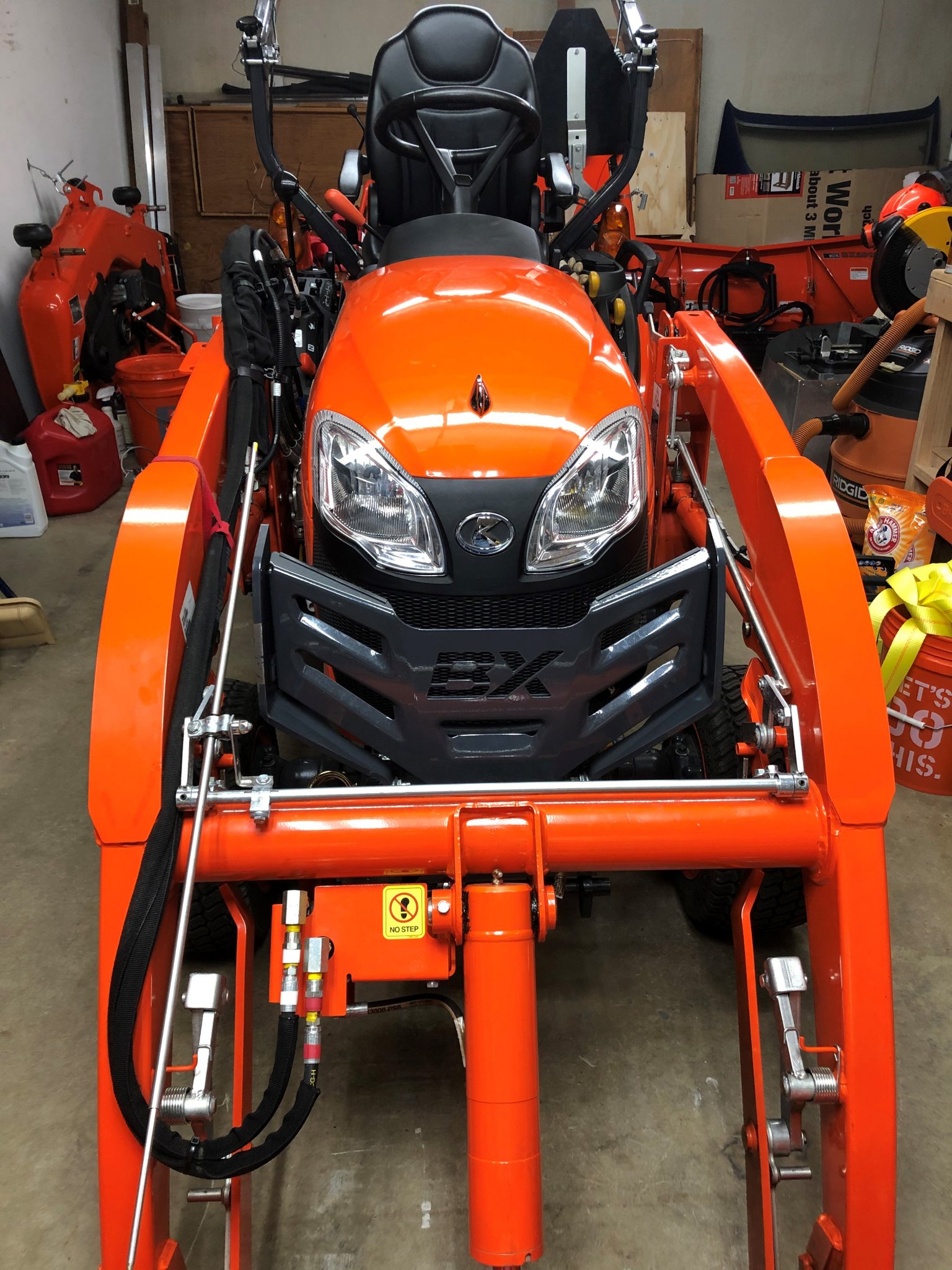

Here it is in the press with about a ½” to go, I was pretty far along in the process before I thought to take a photo. Last photo back on tractor you can see the areas where paint is gone but the guard & center grill are back to original fit. I wanted to complete the bending & making sure everything fit prior to painting so I’ll be taking it off later to sand & refinish those areas.
