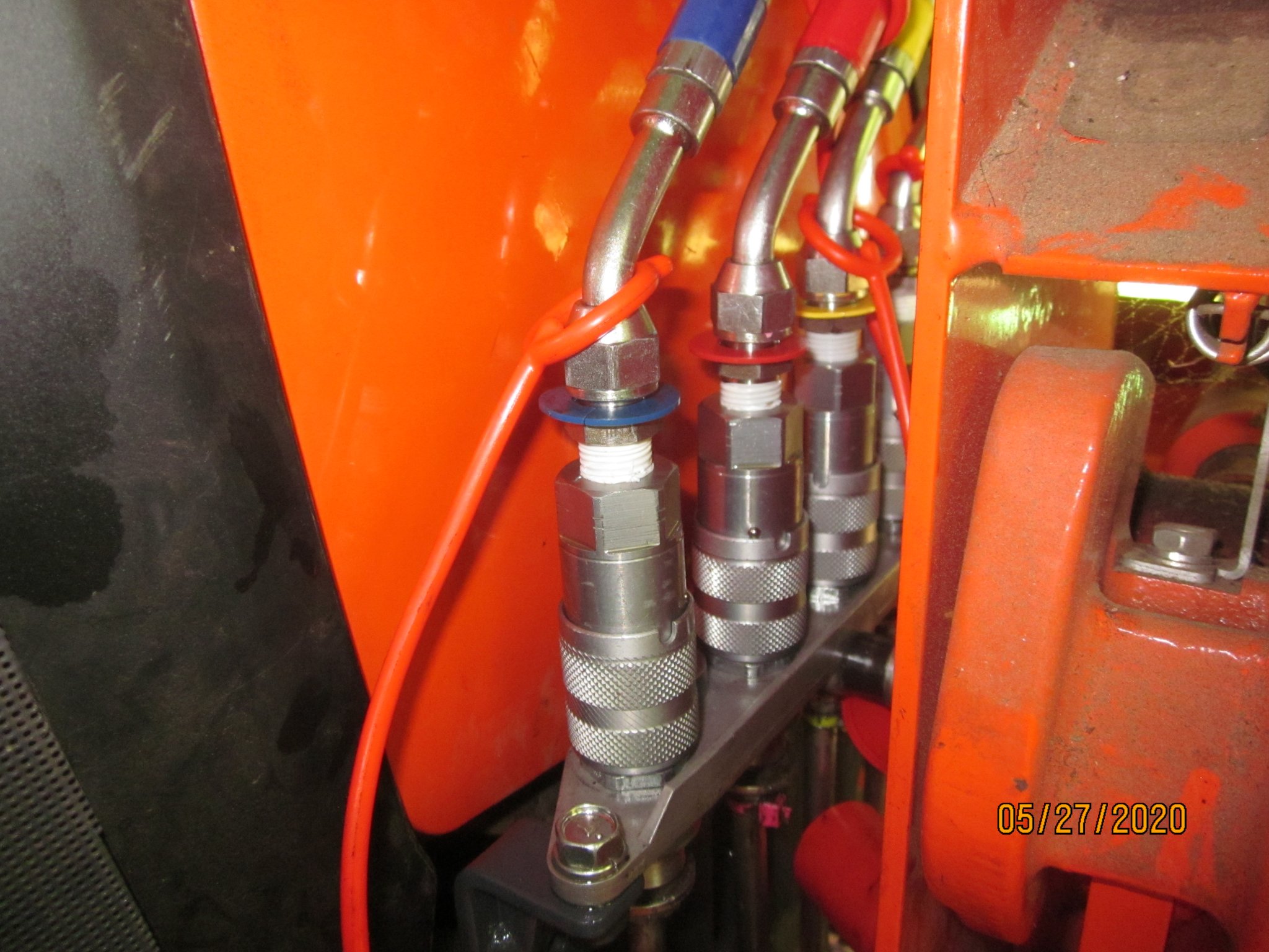

After spending 1/2 day trying to fix the leak, gave up. In less than an hour I went bought these...
4 of GAT G0490-0604
4 of KUB 7J62666320
and ELIMINATED the leak.....
GALER,the local dealer, had them in stock, KNEW the problem and offered this as the best solution.
I could have replaced the original units on the hoses but heck ,Murphy says if I'd replace #1 and 2, then #3 would start to leak,replace #3, then #4 will leak.....
Now, if it'd dry up here so I can really test them out !!

yes, picture in #5 is what I did...
well it is 4 couplers in 1 block of metal.......
At the end of the day, it's an upgrade the new owner will probably appreciate.

That'd be from Kubota USA, but I'm in Canada,eh ! Showed them the paper, they'd never seen it, Service MGR has installed lots of these 'coupler kits'. Galer sells a LOT of 'orange'.

I just ran into this problem today, what goes wrong with that connector . Seals go out? Just spent an hour taking it on and off, I’ll be looking at your option
