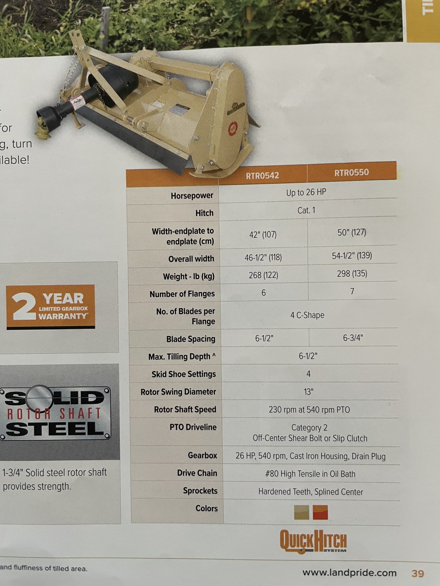

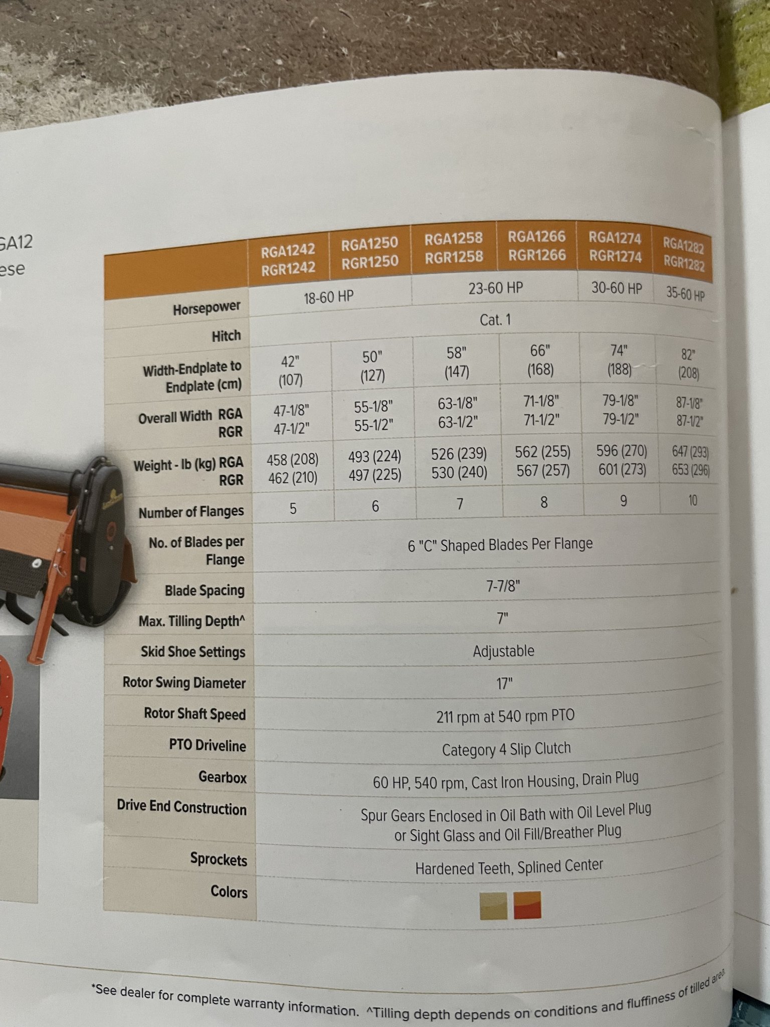

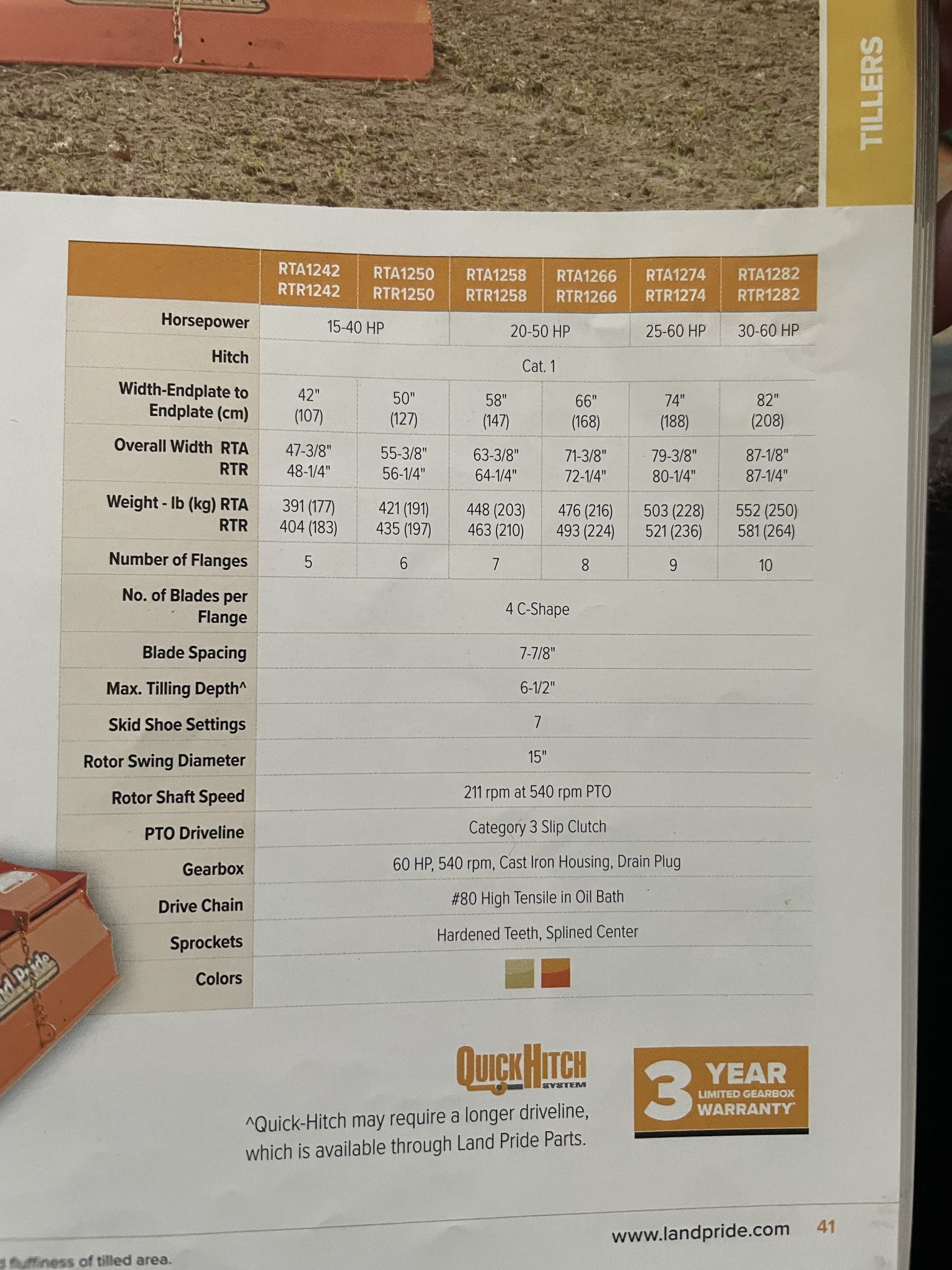

My bible is a year or so old but it’s probably still fairly relevant…here are pics from any of the units to me that looked like there was an offering for a B or Bx…meaning under 25hp….there are more from landpride but I think they need 25 or more HP.

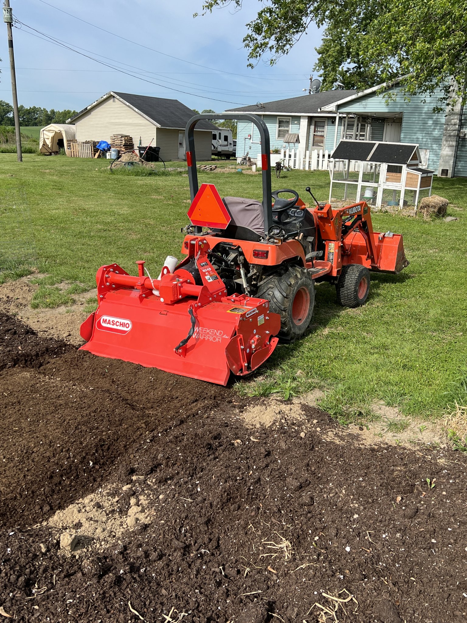

I rented this tiller from my local Farm Store/Kubota Dealer. It worked well with my BX2200. I had to leave the loader on to counter the weight.

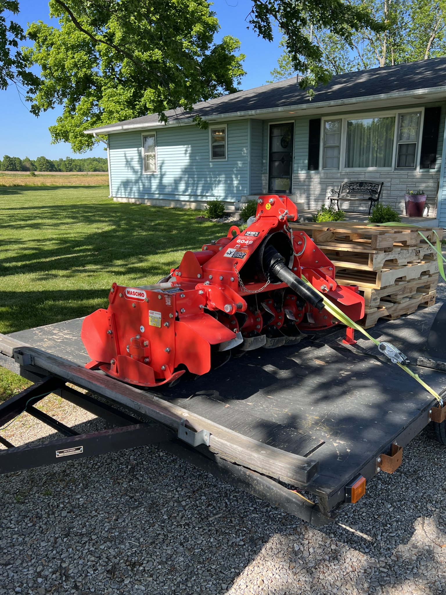

I rented this tiller a couple years back. It also worked well, but was not nearly as heavy. I was able to use it without the FEL attached. Neither one is an off set model and both covered my tracks.

The first, haha, hard no. It's good to know your tractor ran that beast!
The 2nd, what model is that?
