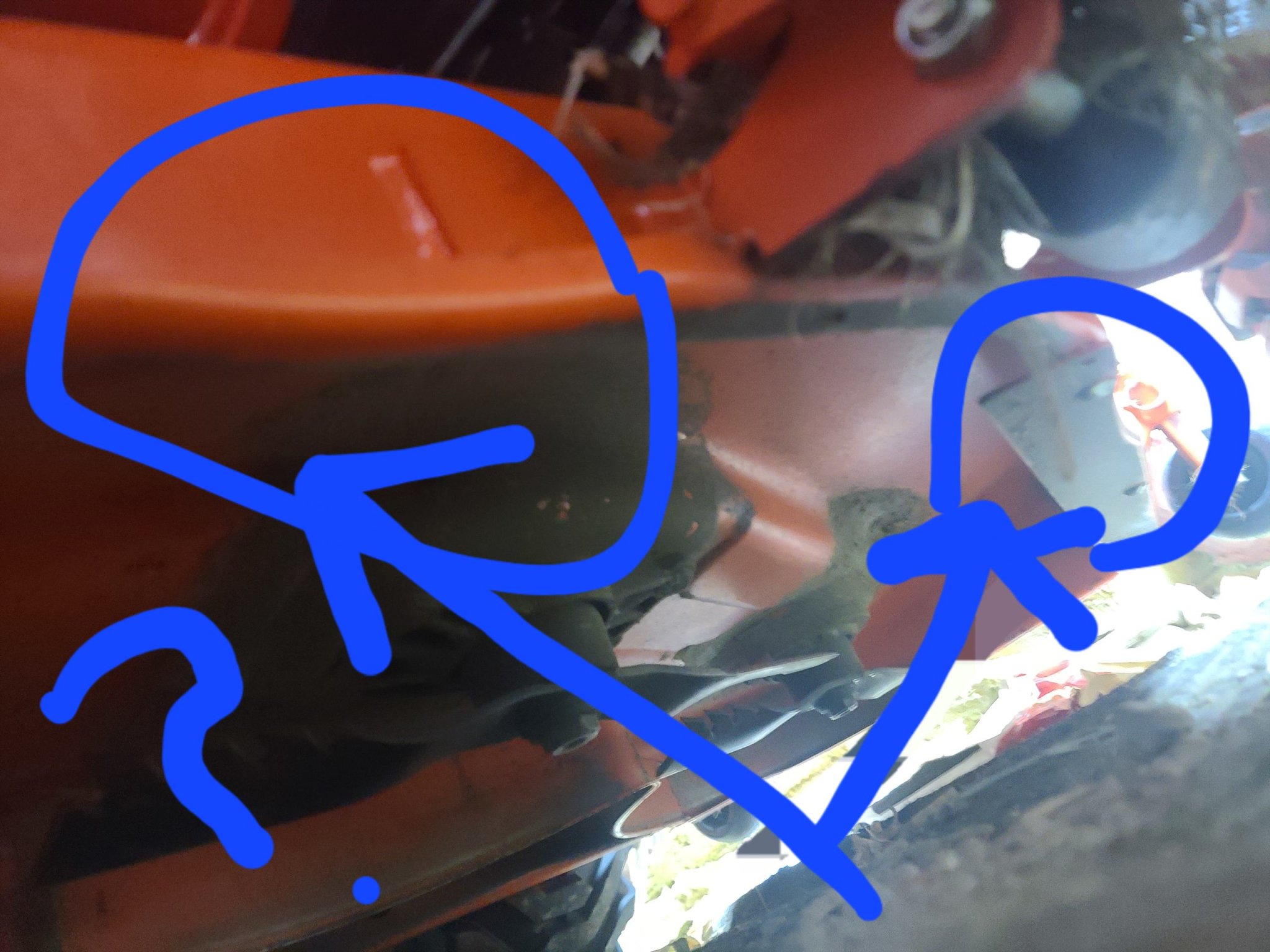

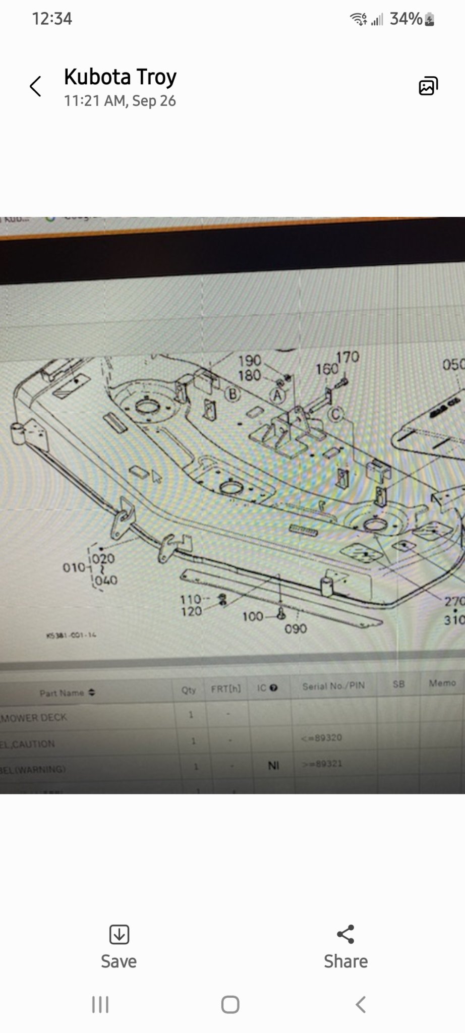

don't have a deck but.... will 090 the left plate, fit the holes on the right side , if turned upside down ?
Do ANY other decks HAVE the right plate ? Maybe check Google images ??
perhaps K decided it wasn't needed after the die was made(so all decks have the 'right side drain holes' ....?
maybe the version after serial number xxxxxxx- ,it was deleted, so picture IS correct ?

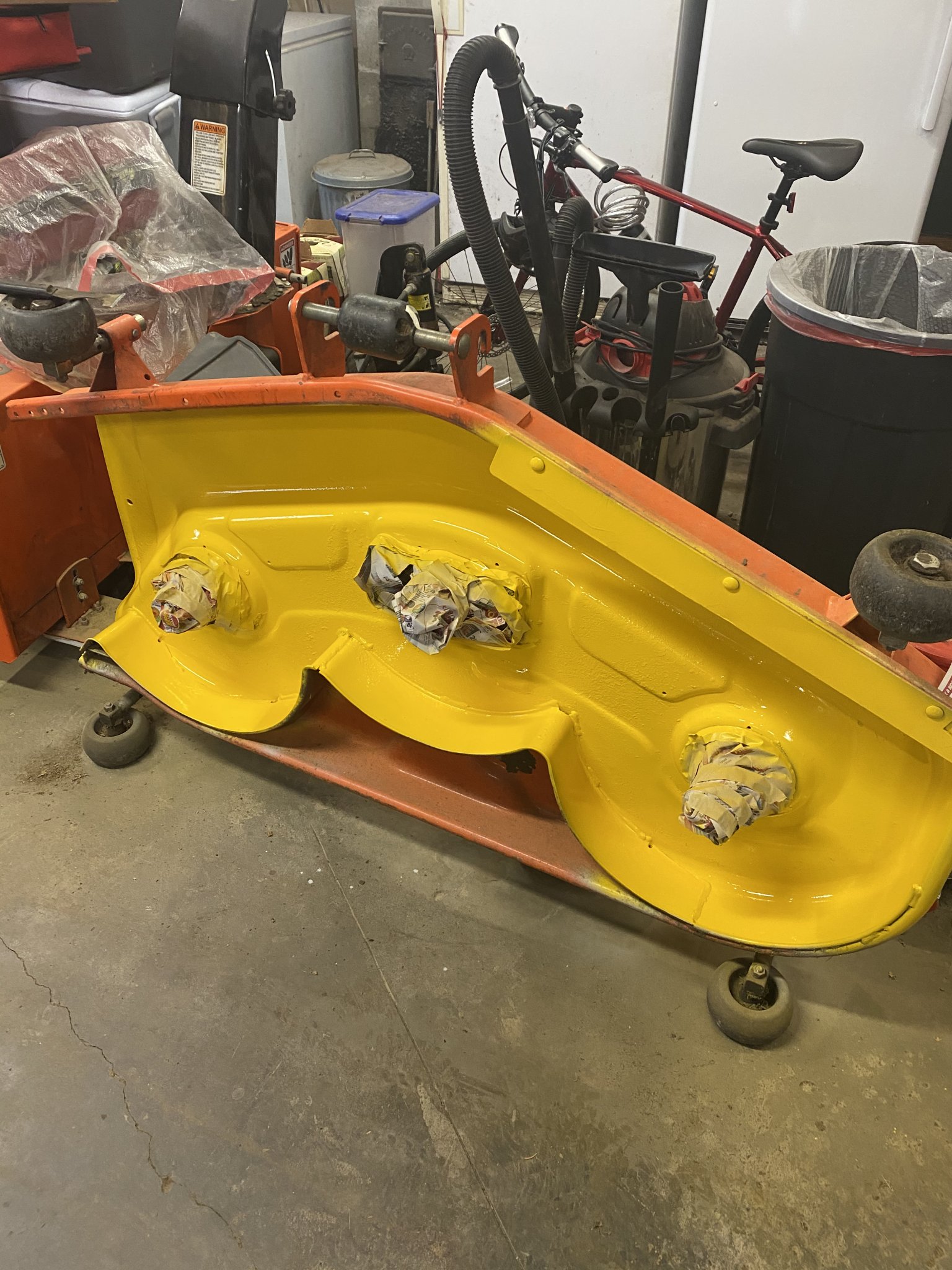

This is a picture of my BX 54" mower deck from a while back. Looks same as yours.

What those extra holes are for is when you have the Kubota rear bagger . There is a plate that bolts on that side that diverts the grass more towards the back of the opening .
