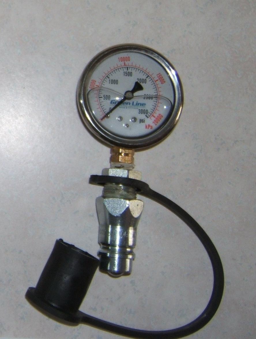

The easiest way to establish the performance of your hydraulic system is to buy a pressure gauge and do a simple test.
Buy a 0-3,000 psi gauge and one half of a quick coupling to match your tractor's. The gauges are on line or at any independent hydraulic shop for around $20.
https://www.amazon.com/STAINLESS-LI...way&sprefix=hydraulic+pressure,aps,158&sr=8-3
If you have the sort of master system where all lines are coupled with one lever, then remove one cylinder hose and connect the gauge to the end of that hose. You do NOT have to Tee into the system.
Run the engine at high idle (full speed) and direct flow to the gauge and read the pressure immediately. Do not continue the test for more than 10 seconds as you are forcing oil through the relief valve and can overheat it.

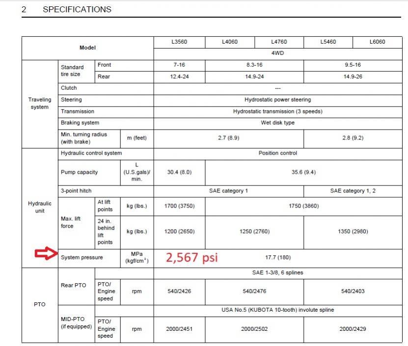

What section are those pressure specs in?? I want to check the relief valve pressure on my l3800 but I can't find the specs anywhere.
Sent from my SAMSUNG-SGH-I337 using Tapatalk
It is often a little more complicated. How many lines are on your FEL valve? 6 or 7.
If 7, then it has a power beyond port which is feeding the rear of the tractor. Rear remote(s) and 3 pt hitch.
The loader valve has a relief valve and there is likely a second protecting the rear of the tractor.
If your tractor is plumbed as I have suggested, then the loader relief valve will limit what the rear of the tractor will receive regardless of the relief setting at the rear.
Some BX's do things differently and feed the backhoe first, then, using a PB port in the Backhoe valve, they feed the front of the machine.
The relief spec's are often in two places. The tractor WSM will have the settings for the rear of the tractor and will make no mention of the loader.
The loader WSM will have spec's for its relief valve but it wont be clear how the rear of the tractor is connected unless you are expert in reading hydraulic schematics.
Owners' manuals have a Specification section and you will find relief info there. I have attached a page from an L series, not yours, to show you.

Thank you for the info. Appreciate it. I'm getting right around 2400 psi at the loader relief which I believe is spec or close to it.
