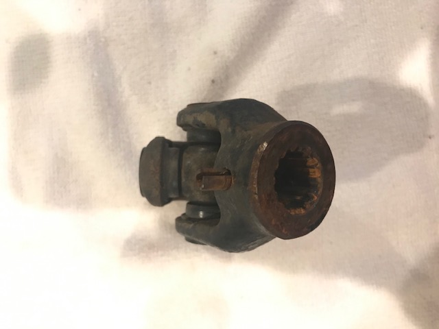

The slope of my property requires 4WD use for most areas. Towards the end of last summer, while mowing with a 48 landpride rear mower, I noticed that I had lost drive to my front wheels. A look under the tractor immediately disclosed that I had lost middle Ujoint for the front drive shaft. I backtracked the area that I had mowed but was unable to recover the lost part. I ordered a replacement ujoint assembly and roll pin and completed the simple repair.
The next time I mowed, I noticed a vibration when the 4WD was engaged. Since I had also recently replaced the front tires, I chalked up the vibration to the tread on the new tires (the old set were essentially baloney skins)
Now, I am noticing that what I thought was tire tread vibration, is in fact only present when 4wd is engaged. I did a test by putting the tractor up on stands and testing for the vibration by running in 2wd and 4wd. The test confirms the source of the vibration is somewhere in the front wheel drivetrain.

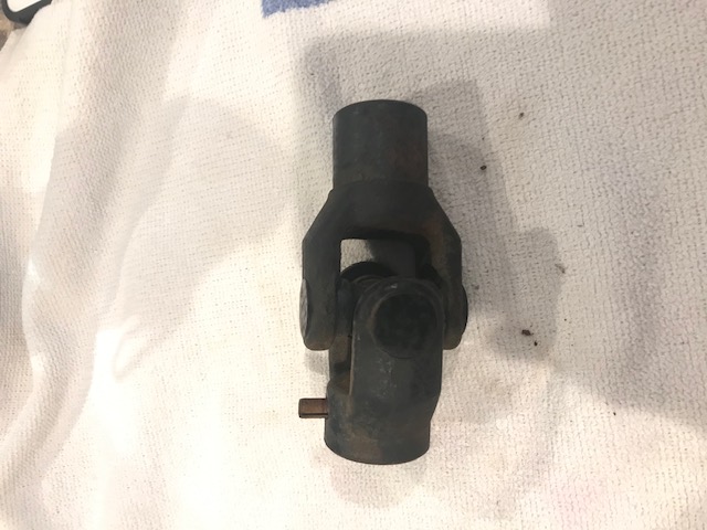

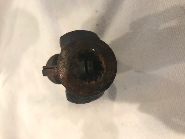

I have also found the lost ujoint and have attached several pics of its condition when it was found. Note that there is a portion of the roll pin still in place.
So I have 2 questions:
1) How is it possible to shear off the roll pin without damaging the Ujoint splining.
2) What sort of damage also occurred to the front drive train during the ujoint event that has led to the vibration?

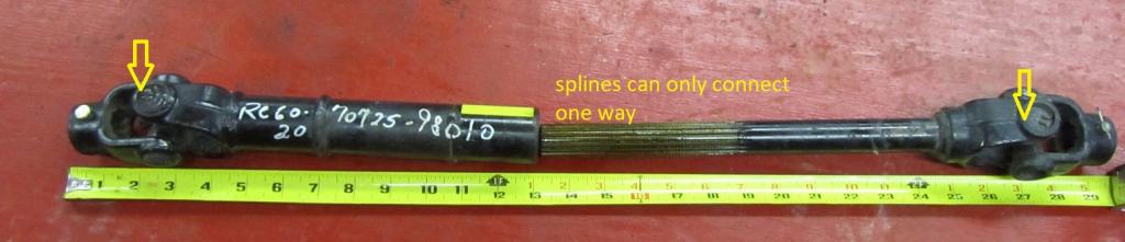

To be clear that we are talking about the same two joints where phasing is important, I have attached a marked up photo. The two yellow arrows are the U joints which must be in phase. The other halves of those joints can connect to shafts at any angle
It seems quite improbable that Kubota's designers would use a design which could permit incorrect assembly right from the factory. Assuming the roll pin is the only component transmitting shaft torque, all that would have to be done as a design would be to drill the hole for the roll pin slightly off center and then the parts could only go together one way.
Dave

Dave,
I do not know what that drive shaft is from, and I do not doubt it may be splined in a way that prevents assembly other that in one orientation.
My recollection is that the front drive shaft on the BX Kubota has splines evenly spaced, and actually can be installed in multiple orientations, when inserted in to the U-joint.
I am familiar with the type of splined shaft that has one flat spline on it, that ensures it can only be assembled one way. I do not recall that being the case with the BX Kubota front drive shaft in my case. I did spend time making sure I got the orientation right when I replaced mine. Would not have had to worry about it if it could have only gone together one way.
Since the OP has a vibration problem after replacing the lost U-joint, and may not have paid particular attention to the time between the two u-joints, it seems likely he may have assembled it out of phase.
But I have a BX2200, and his is a later model.
Perhaps someone that knows for sure can add something.
But in my case there is absolutely no question that, had I not been careful, I could have installed the replacement U-joint on my BX out of phase.
Edit: The roll pin does not transmit torque, it simply holds the u-joint in position on the shaft. The splines on the shaft transmit the torque. The other end of the u-joint is free and slides on the shaft. This is on the transmission end. I do not recall if the axle end had one roll pin or two.
