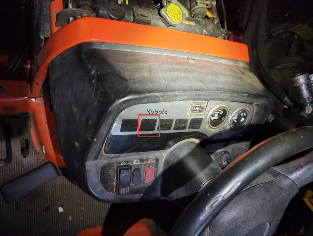

Please do not be insulted but where did you get the idea your BX machine had a glow relay and second why that part number fit your tractor?
Messicks lists that relay for perhaps 20 models of Kubota and all are L series.
I do not think your B2200 has a glow relay. None is mentioned in the troubleshooting section.
Perhaps the D in your model makes things different than the WSM I have.
Is your glow indicator a small coil of wire you can see thru a small metal hole in the dash or is it a light bulb?

The glow indicator is the second light on the dashboard. View attachment 73653

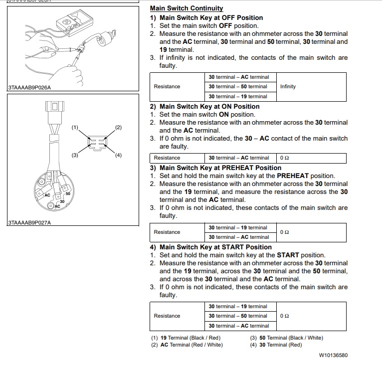

Not the GP's but rather the power supply to the GP's.
Test the key switch before doing anything else.

Where is the 19 Terminal? That diagram seems to show two AC terminals? Is it labeled wrong?
I agree something is wrong. Are there not identification marks on the switch body?

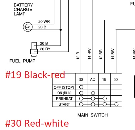

Edit: I looked at the wiring diagram. It shows the wire colors for the terminals.
See below:

Dave_eng - - - If you look back at the Manual Page you posted.....bottom right is the key for plug diagram on the left side.....
Looks like Terminal 19 is the (1) location on the plug diagram, etc....
Does that answer the question? Wasn't sure if it did...pointing out just in case it helped.
Good call....... I was so focused on the mis labelled terminal I did not see the lower right.

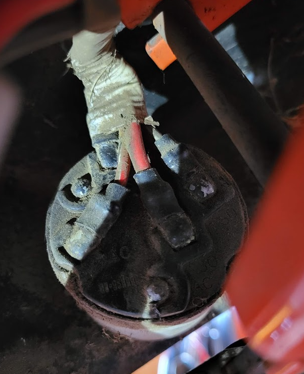

Ok, testing resistance off of (1) Black/Red and (4) Red, with key held in warm position. Saw no continuity (in any key position). So it looks like the switch is the problem.
Does the switch pass any other tests?
If there is a small hole in the switch body, spray a large quantity of any lubricant or cleaner inside. Then exercise the switch many times and check resistance again.

I also checked AC Red/White (2) to 30 Red (4) and that only has continuity in start position. (And it should have continuity in the warm position.)

Just a follow up... It is now fixed. I replaced the ignition switch (66101-55200) and the glow plug light comes on and it started immediately in 25 °F (after about 8 seconds of glow plugs). Thanks for all the help.
