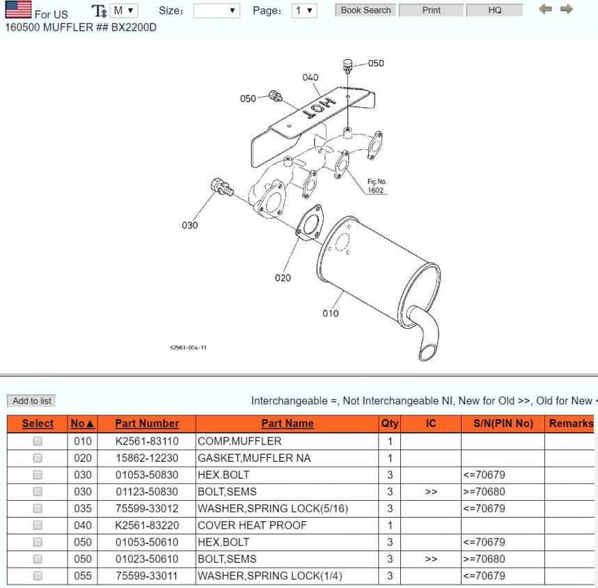

Yep, its shot. You'll just need a new muffler and gasket.
Its easy to do if you remove the hood/grille. I used never seize on the bolts when I replaced it because I thought I may have to do it again,. but I never had a problem with the new muffler.
attached is the parts diagram.

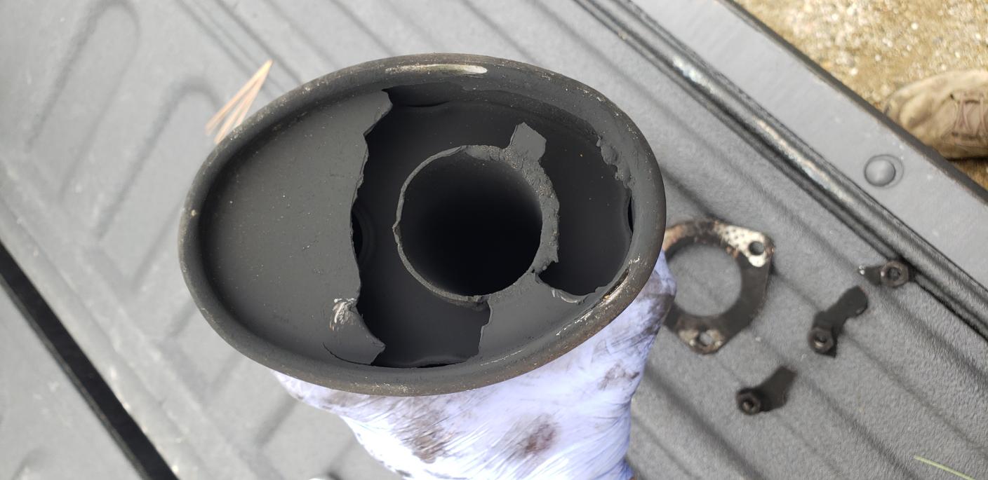

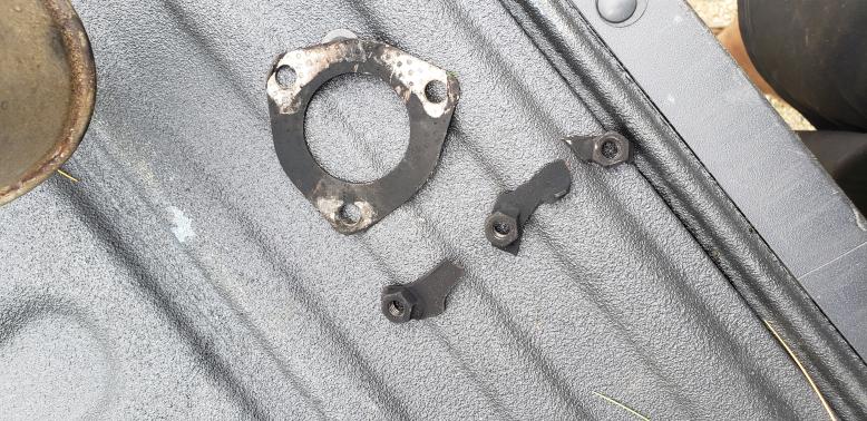

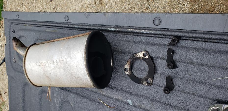

Muffler, bolts and gasket have all arrived! I'm excited to get it fixed up, I found a melted plastic hole in the grille where the hot exhaust gasses had been jetting out, where they obviously shouldn't have been. Who knows how long it'd been like that.
