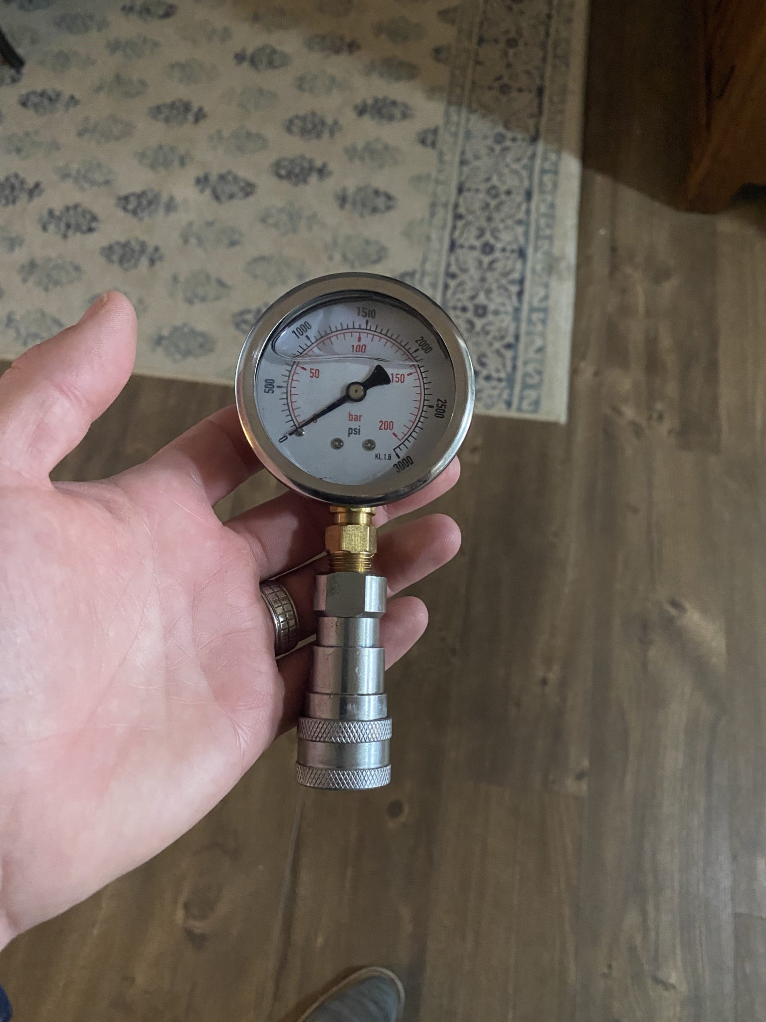

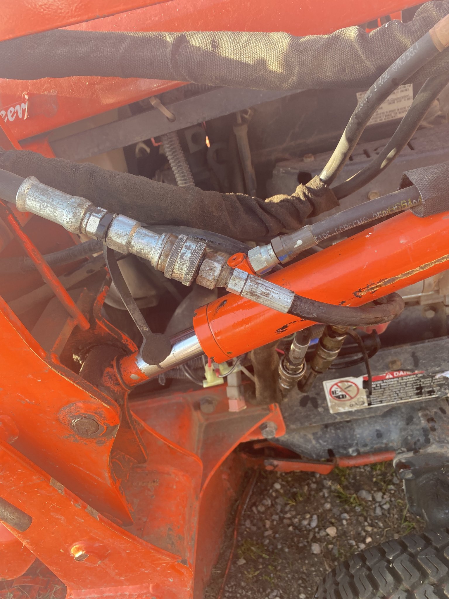

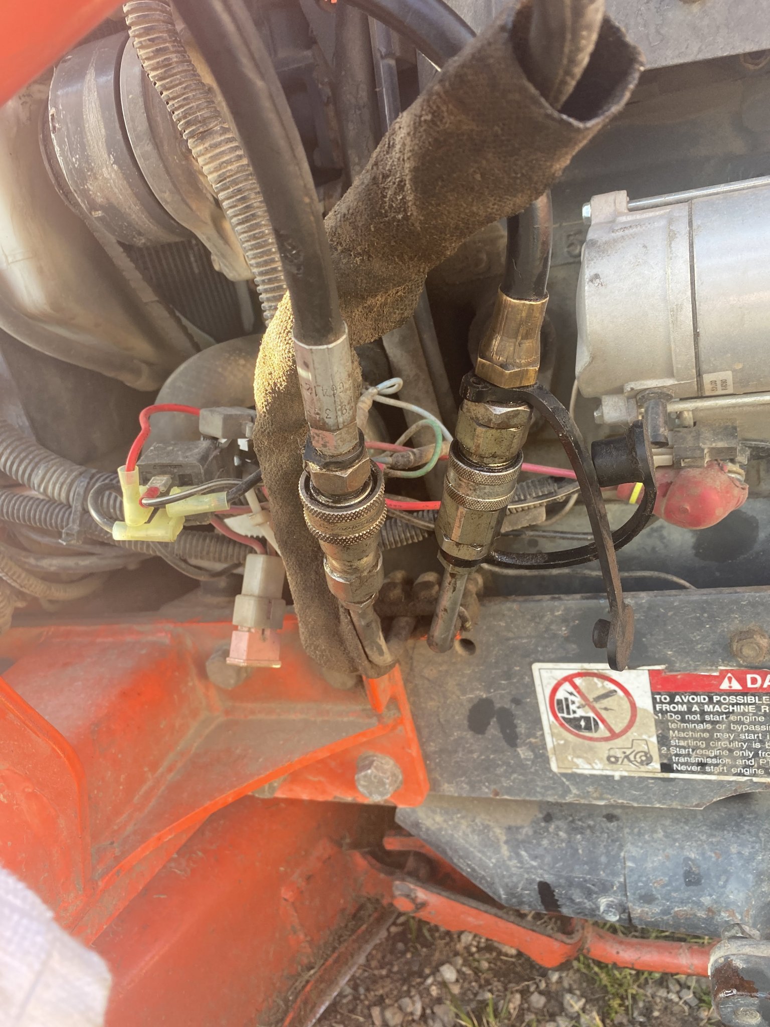

I had purchased a hydraulic pressure test kit from BXpanded to check the pressure on a BX2200 I bought. For some reason I can't get a reading. Since the tractor is older it does not have the 4 quick connect setup like in the instructions. It has 3 of them. The gauge in the kit only fits on 2 of the male connectors and I believe it is on the wrong side of the unions to test the pressure. It is on the hose size. I have included picture for reference.
  1. The hardline coming out of the tractor on the right side is a male, but a smaller nipple so the gauge won't connect
  2. The hardline coming out of the tractor on the left side is a female. I can connect the gauge to the male part of the union coming back from the loader but I get no pressure reading regardless of the FEL function I try. One of the functions just doesn't work.
  3. The 3rd union is up on the FEL by the joystick. the left side of the union is the female part. I can connect the gauge to the male fitting on the hose on the right but I get no pressure reading regardless of the FEL function I try. One of the functions just doesn't work.
Does my setup require an adapter of some kind or am I just missing something?

You will have to get the male nipple for your gauge and test from the female hard line that is next to the flex line with the wear sleeve on it. Attach the gauge with the the tractor shut down and all pressures relieved by working joy stick and 3pt lever.
I have a BX22 and bought the same kit you did. I had to replace the female fitting that came with the kit with a male fitting.

On your tractor, the supply hoses to the loader MUST either be connected to the loader valve or looped together to run the engine. When you unplug one hose and run the engine, the hydraulic oil has nowhere to flow and blows the relief valve.
You will need a Tee, a male, and a female coupler so you can put the gauge into the circuit. You can then read the pressure by rolling the bucket all the way back and read the pressure. Do not blow your relief valve for more than a couple of seconds or serious damage can occur.

Thanks. I emailed BXpanded and they are sending me a male adapter to replace the female that is on the gauge free of charge. In my email I had sent them the same pictures I posted here and was told to test the pressure at the port you described.
I was happy with the service I received from them. They called me directly to ask some additional questions and then took the time to walk through the process with me.

You don't need to operate the FEL valve if you attach the gauge to the supply line to the FEL (middle hose). The Hydraulic system will go right into relief as soon as you turn the tractor on. This is actually what you want, you are setting the relief valve back by the rear wheel which is fed directly from the pump. There are no hydraulic lines on the tractor that don't first go through the primary relief valve behind the left rear tire. Add some shims and have at it to get more performance. I have mine set just a tic over 2000 PSI for some time now.
I will say this though, my BX had some age on it before I shimmed the relief valve. It was 16 years old and mostly all original hoses. The higher pressure did find the old weak hoses and seals on the cylinders. Thankfully they didnt all start leaking at once. Over time they have all mostly been replaced and

BXpanded sent me the male nipple for free.
Finally got around to testing the pressure. It was low and running about 1600psi. Used a few of the shims included in the kit and bumped it up to 2000psi. Gonna keep an eye on FEL hoses with the increased pressure. I am thinking with the increased pressure I will end up having to replace the hoses at some point.

I know this is an older thread, but I have a question about where to connect the gauge on my 2003 BX2200. I recently purchased the gauge from BXpanded and received the gauge with a female fitting attached and a separate male fitting. I tried the male fitting in the center line shown in the original poster's picture and it wouldn't fit. I don't have my FEL attached to the tractor and thought I wouldn't need it attached to check the pressure. First, do I need the FEL attached? And secondly, it would be helpful if I could see a picture of the gauge attached to the proper fitting on a BX2200. Thanks for any and all help offered.

If your goal is to test the tractor supply pressure you do not need or even want the loader in the circuit.
With the tractor shut down connect the gauge to the pressure supply line for the loader. Start the tractor and read the pressure then shut the tractor down and remove the gauge.
That reading is the pump pressure supplied by your tractor.
