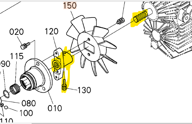

The propellor shaft (hydrostat input) shaft has two ball couplers on it that allow shaft misalignment. If the hst cooling fan stops when this happens, that's probably the cause.
I only know this from reading other folk's posts. Those couplers aren't maintenance points so, when the original grease is gone, they wear out.

This is the joints that @PoTreeBoy is talking about.
Another know cause is the coupling stripping and slipping.

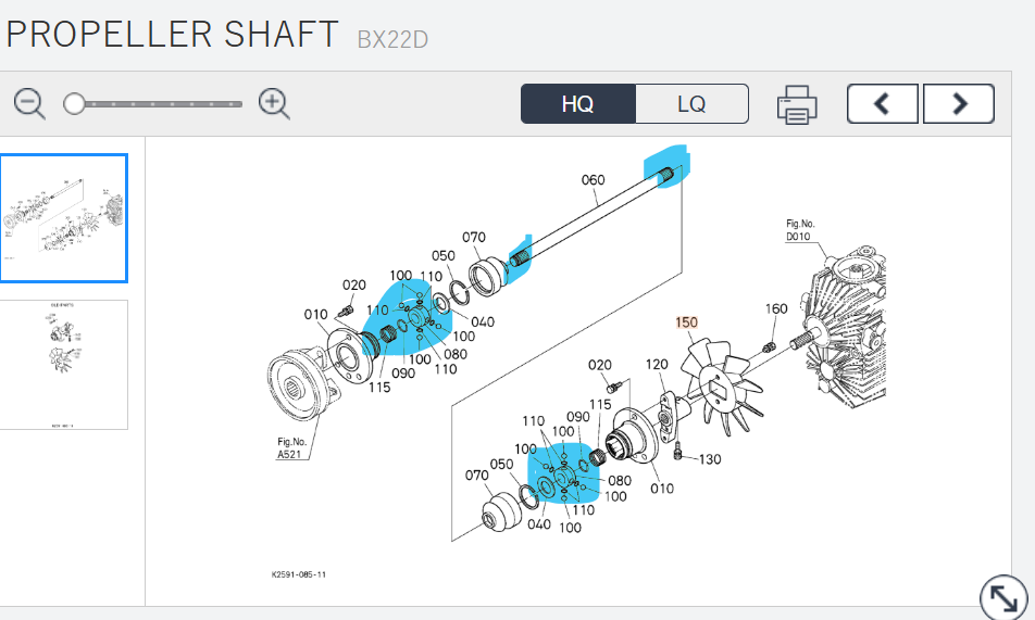

Welp here’s the update I did both front and rear shaft joints all new everything except the actual shaft… still doing it. But I did a little test I just let it grind as I was pushing on an tree and the backhoe hydraulics still function as normal. So i believe the shaft wasn’t the issue. Because the pump is still turning. So I was gunna pick your brains one more time and then it’ll off to the stealership. Thank you for the help.

Did you also change the coupling in the second picture of post #3? I'm pretty sure the FEL hydraulic pump is not driven through the drive shaft.
I stand corrected, the hydraulic pump is driven through the drive shaft.
