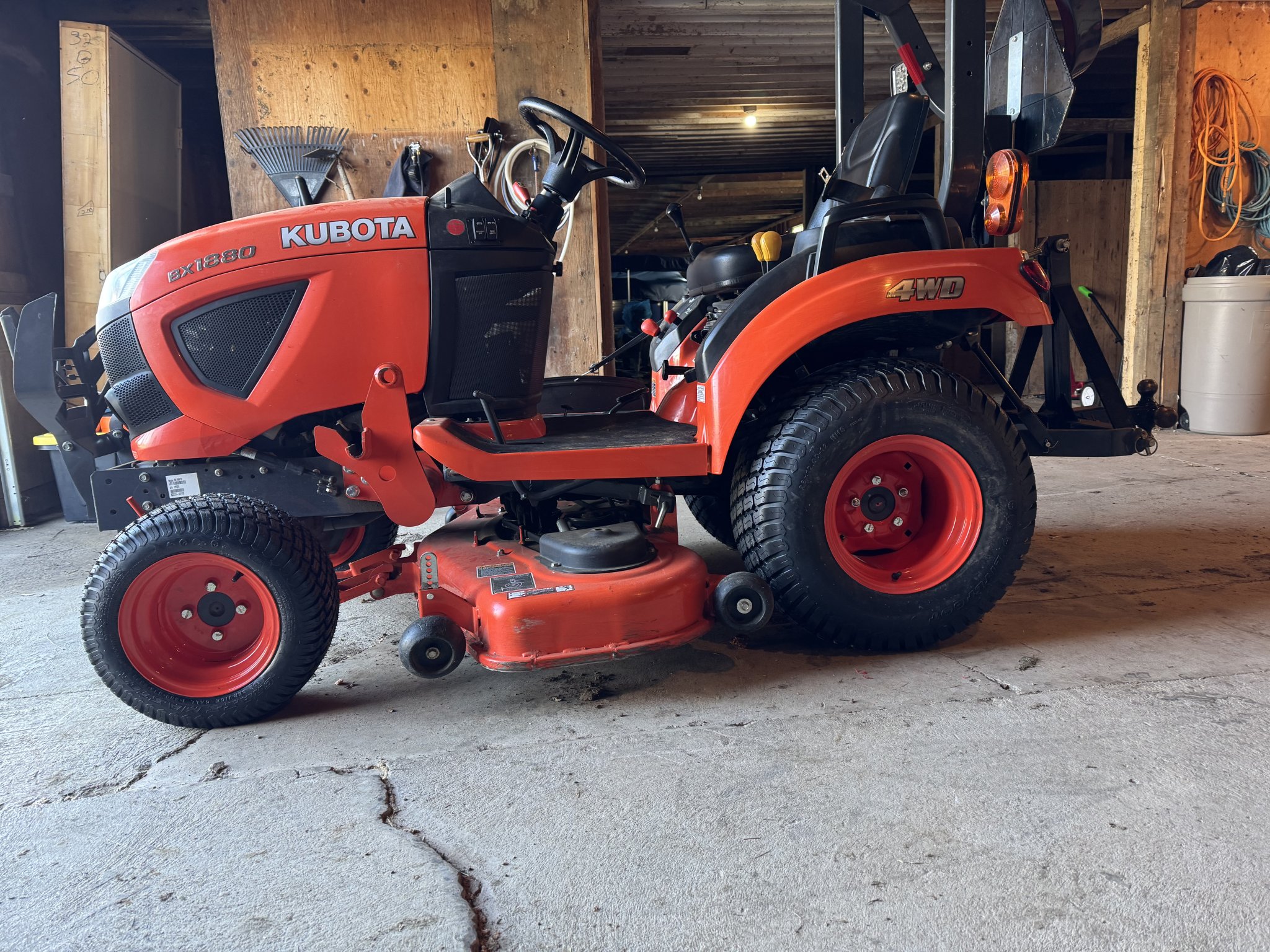

Hi. Wondering if the wheels off of a 2023 BX2380 will mount on a 2023 BX1880? Are the bolt patterns the same? Thanks for any help!
