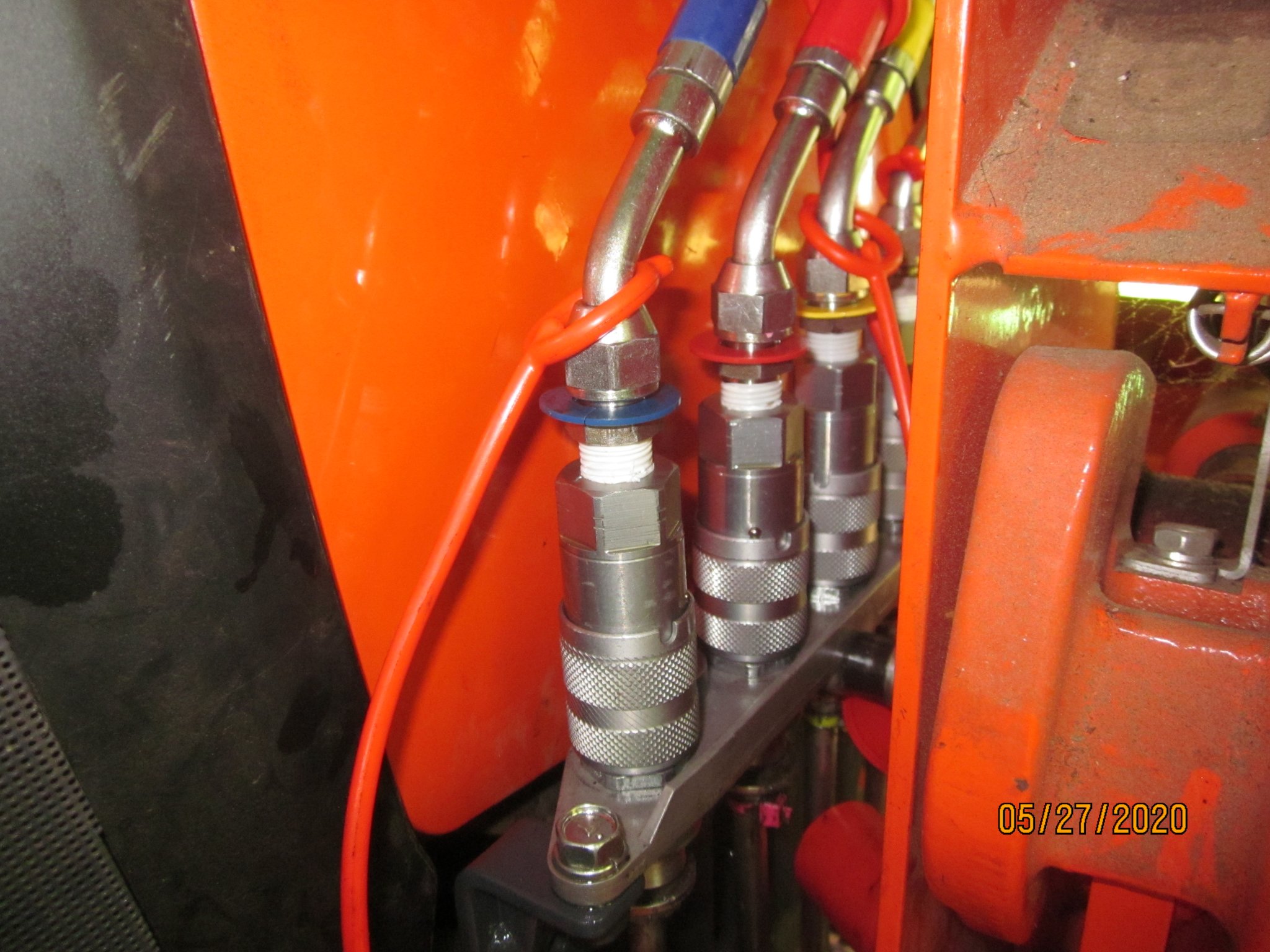

I am so happy my dealership was misinformed and told me I could not get the swift-tac with a cab on my LX2610,
