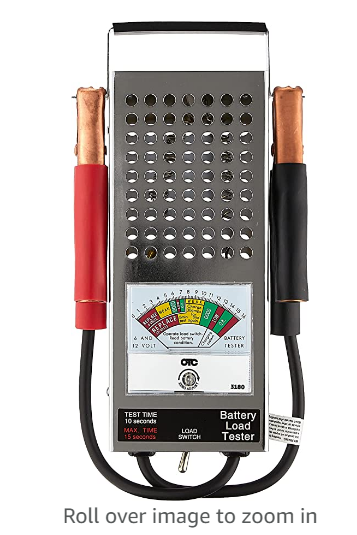

...or better yet, buy one of these and use it for life...rather than running back and forth to your local auto parts store every time you have a suspect battery.
A voltmeter *MAY* tell you part of the story, but it will only tell you PART of the story.
I've seen batteries measure 12.8vdc at rest, but once you apply any kind of a load, poof, down to 2volts or something.
