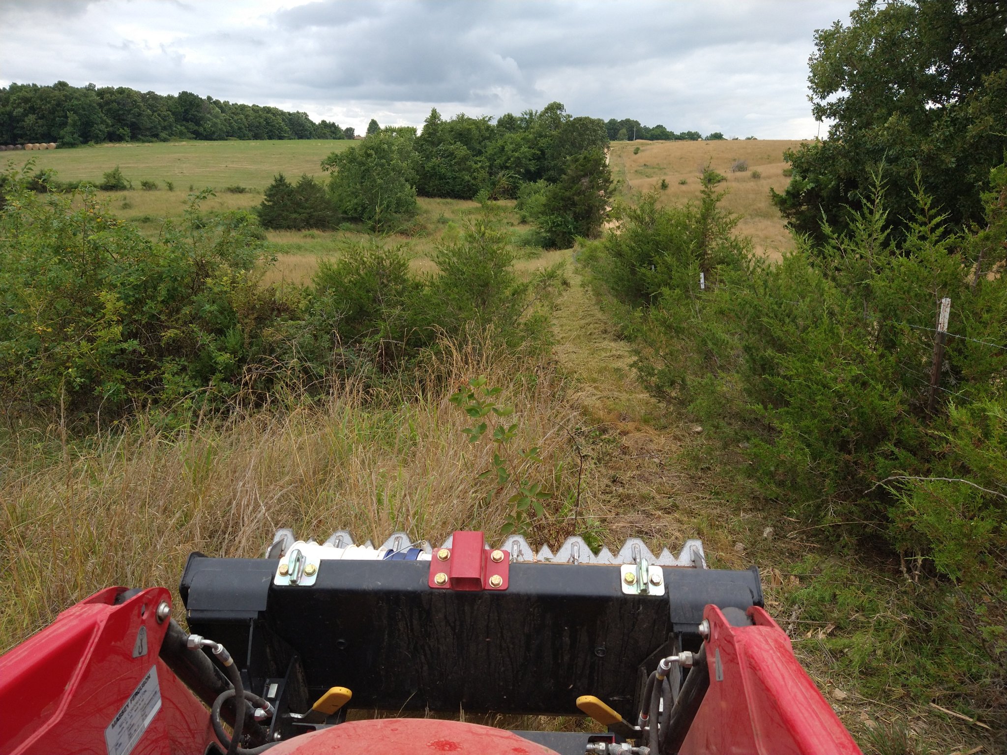

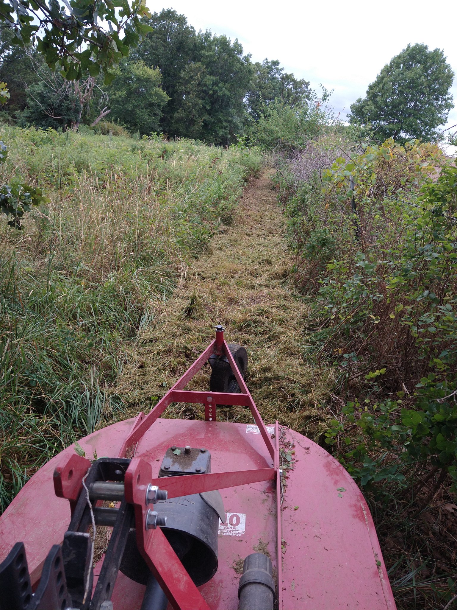

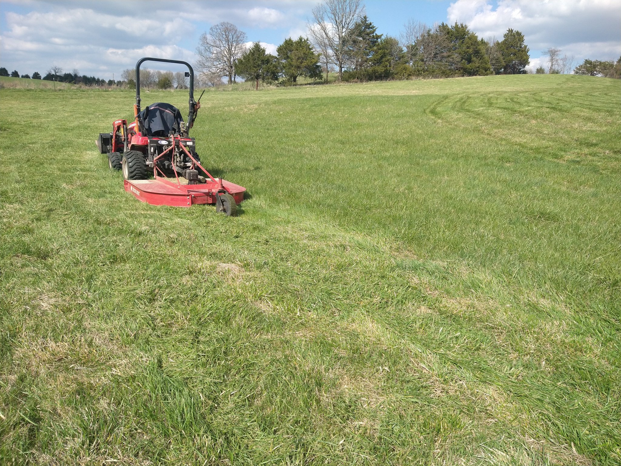

For grass you will be fine with the 48" ... I at first got a 48" for my 19.6 PTO HP, (25HP tractor)
It cut much more then grass!
I then traded it for a 5' model with a recommendation of minimum 20 PTO HP ... And now cut grass with it, since I got the "pasture" tamed ... no problem!

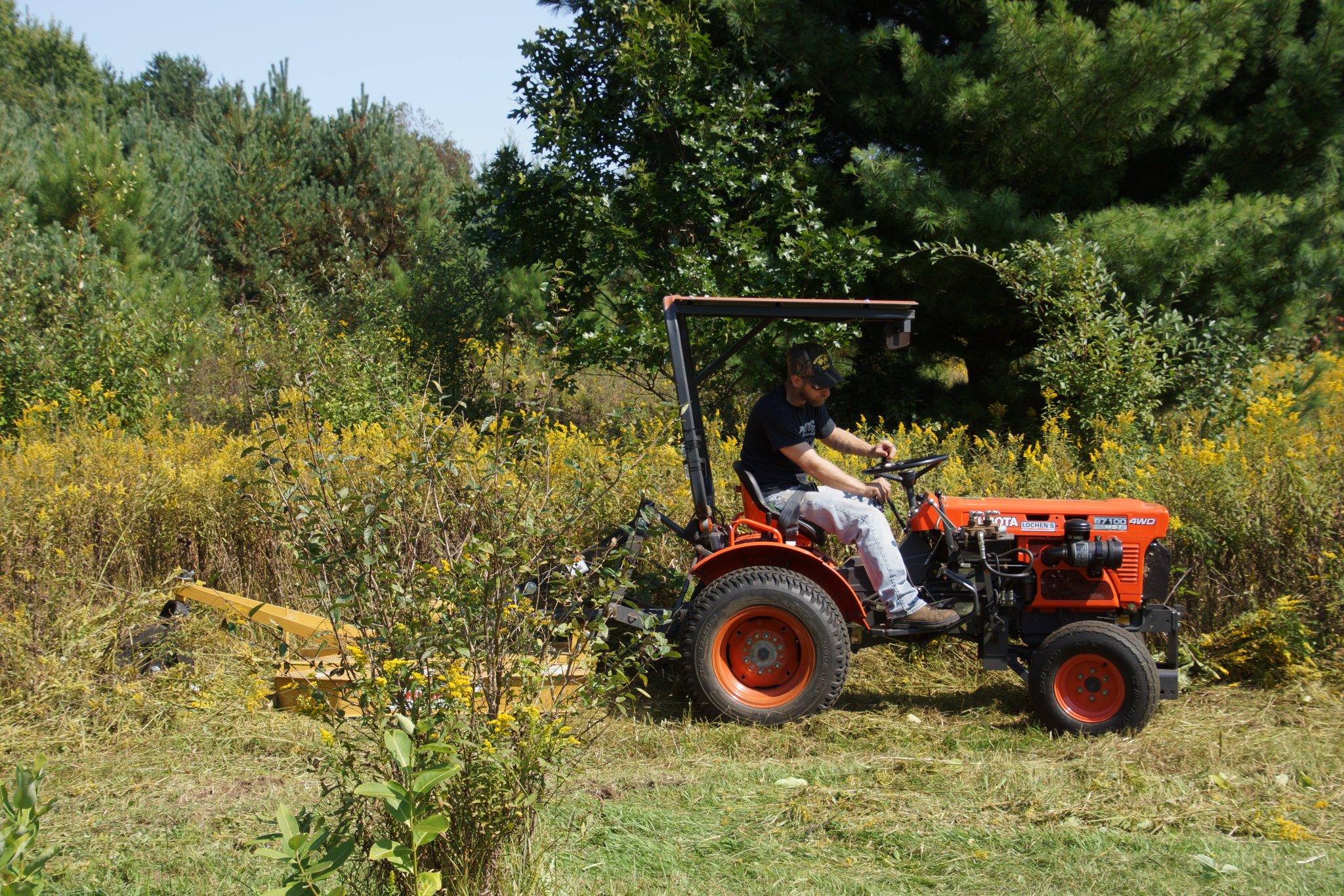

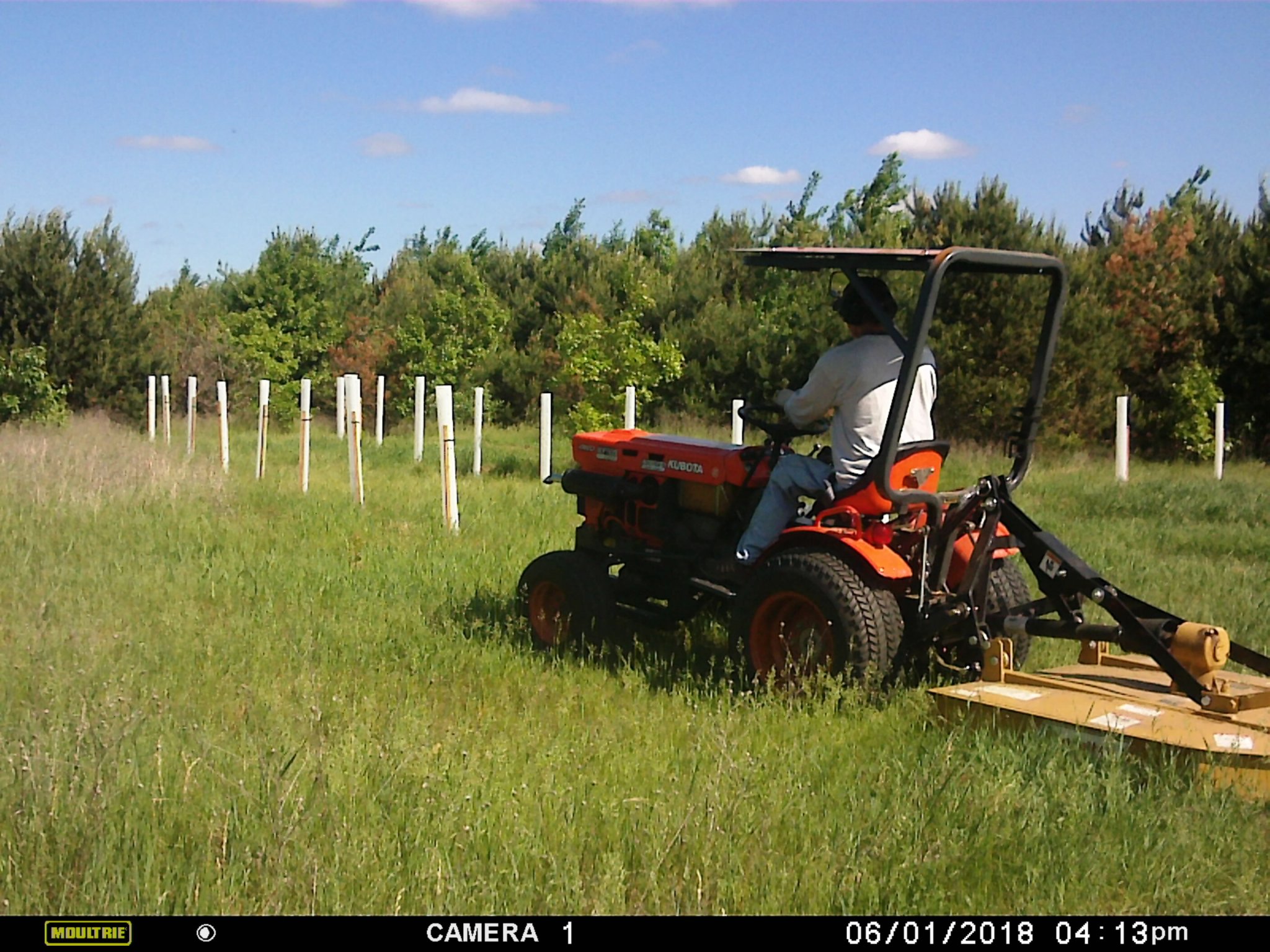

While not a BX1880 I ran a King Kutter 48" brush cutter on my B7100 hst.
16HP with prob 13HP at the PTO. Similar machines and specifications and the BX1880 may even have a higher 3pt weight limit? Most of my cutting, before I foolishly traded it off to a friend, was tall prairie grasses and native species along with maintaining my two track trails and some 1 to 1/2 saplings and small pine trees.
I was completely satisfied with the performance and of course I could have run it out of HP under certain circumstances such as very tall, dense wet grass along with high travel speeds.
I am not sure about Country line implements but I do know King Kutter makes a model specifically for the BX series tractors with limited Cat 1 3pt hitch. It is also lighter than the standard duty version that I owned.
I traded the King Kutter 4' off to my buddy and got his 6' Land Pride in return and use it behind my L2501. I wish I would have kept it, that little tractor and 4 foot cutter was super handy in confined areas etc.
