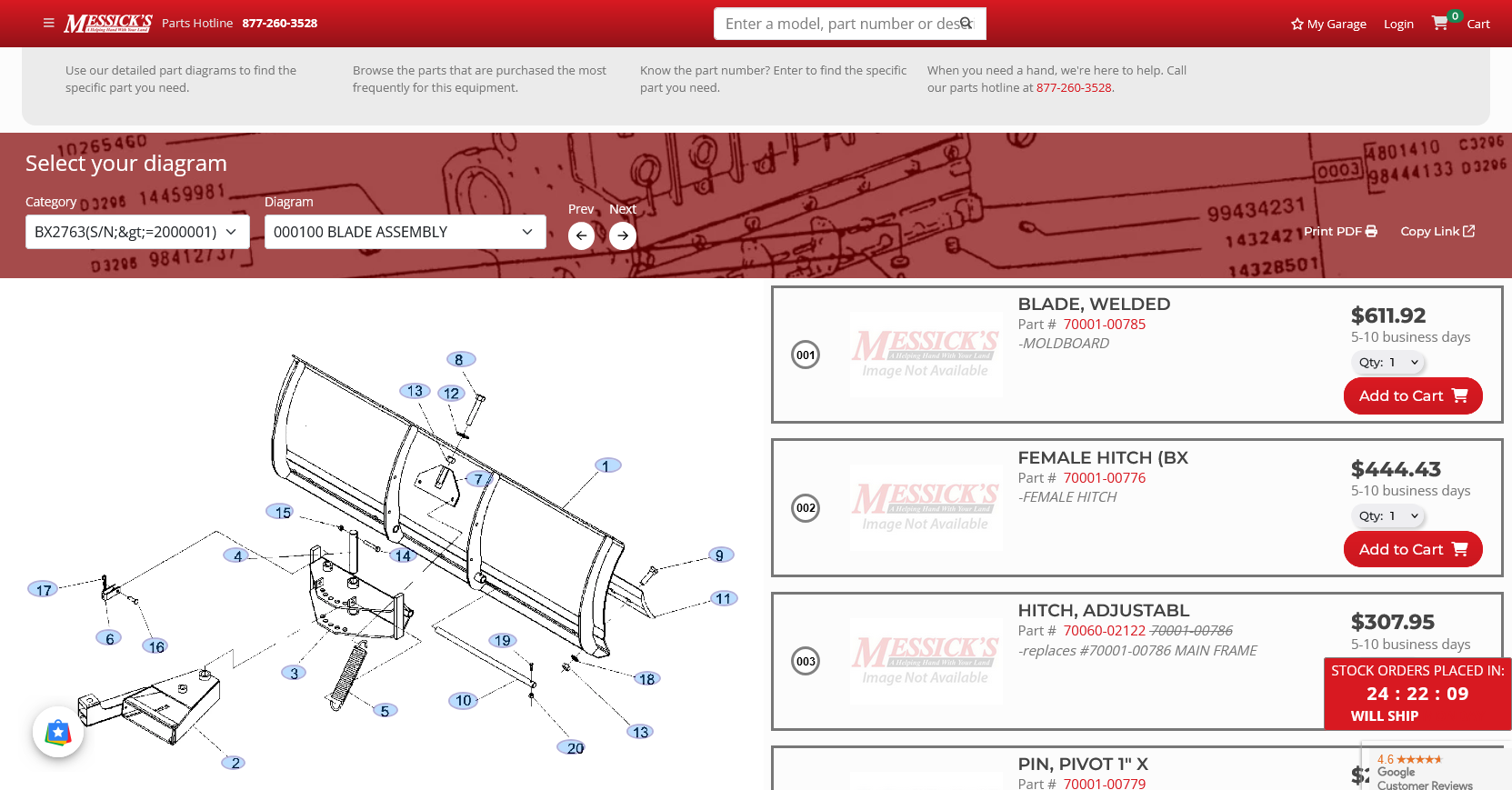

curious I went to messicks, grabbed the 'blade' pictures and wonder IF the tractor side where they slide into is the same" If so maybe the B2763 could slide in ?
I have the quick attach on the BX1500 so I don't see why they would not work. The only thing I see is where does the hydraulic cylinder attach to, is it the quick mount on the tractor or the mount that comes with the front part of the blade

curious, found this as my reference. I assume the power angle cylinder gets pinned in the hole by #4 on the blade frame and the 'extra tail' on the piece that goes into the hitch ( 'blue star). so cylinder is ON the 'snowplow' assembly. The hoses probably quick connect to a loader control valve ?
Actual up down on blade is by the quick hitch.

B2763 and BX2763 are two different animals. Go to Messicks dot com and one at a time, put in the part number of the plow, and the part number will show up as the category, and on the right you should see the diagram. Pick blade and that will show all the blades and parts. Then open another window and do the same with the other part number. You will quickly see the differences. One thing that I have encountered is that some people forget the part number and put the wrong information in the ad. If the ad has a picture and it looks like your snowblower attachment then it will fit.

That's what I did and while they have different parts, I assume they both fit a 'common' or 'universal' quick hitch used on several tractors. I find it hard to believe that Kubota would require a different 'quick hitch' mount for each tractor series. All 3 point CAT1 hitches( tractor side) accept any CAT1 3PH implement.They 'connect'. Surely the quick hitch is similar ???
